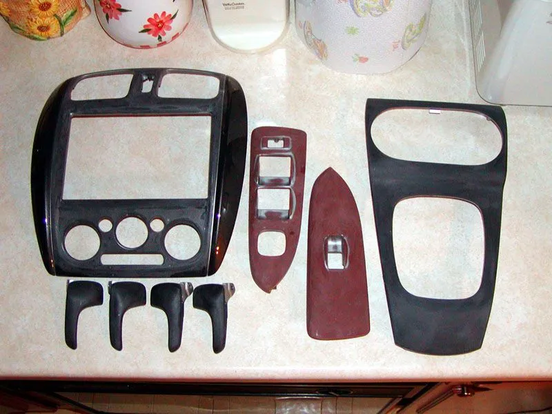

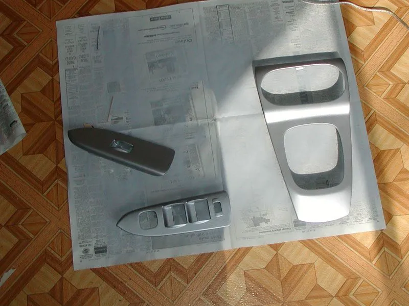

Haha.. this is what it looks like about 4 hours ago, and what it looks like now. I wet sanded it with 400 grit automotive sandpaper.. Some of those places are a pain in the ass to get to and I was tempted to get out the dremel and very very lightly sand it.. but no, don't wanna mess anything up.. So there are a few VERY slight parts that didn't have all the paint removed.. but it is scuffed up enough that primer will stick. So far sanding = biggest pain in the ass. :D

By the way, those pins were pretty easy to get out. I pushed a screwdriver through until the pin was about 1 cm out the other end.. then grabbed the Robo Grips and yanked the pin out with those. No problem at all. And I left the springs in how they were so I shouldn't have a problem with reinstallation.

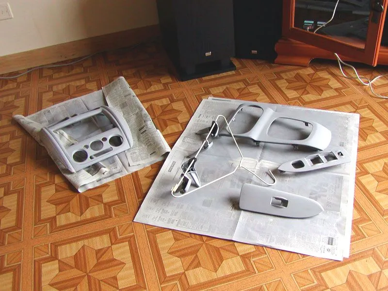

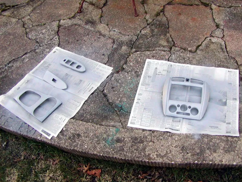

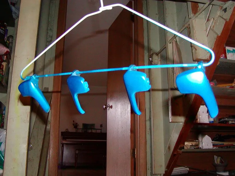

Alright, got it all masked off and primed. I had to come up with a creative solution to hold the handles up while they dried since I didn't want the primer touching anything and leaving marks.. Here's some more pictures.. Next is.. more sanding!
EDIT: I dunno why all the Plasti-Kote cans say Ultra Enamel on them (the clear says it too) because on the back it says acrylic. Oh well.

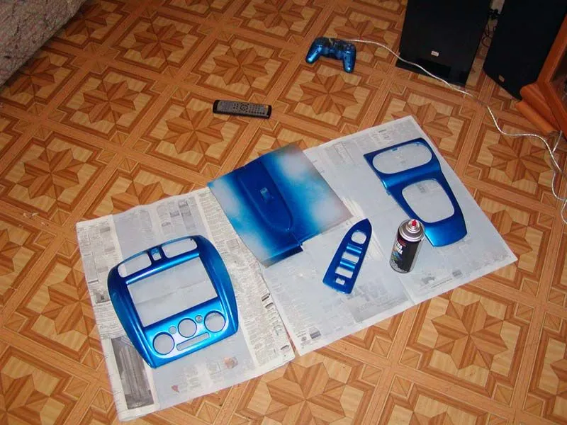

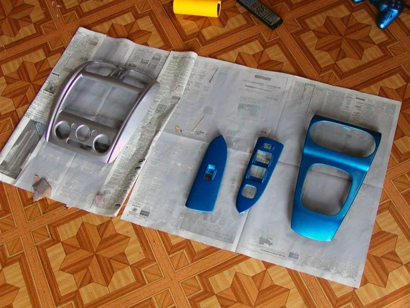

I have pics but I'm not going to upload them yet. I shot the center piece with the base coat for the Anodizit and all of a sudden two big blobs splattered out of it and messed it up pretty bad.. I dried it and had to resand it and then prime it again.. pissed me off.. but oh well.. I have about ten minutes before I go put some coats of blue on some of the pieces.. I gotta take a look at the door handles because it looks like i may have gotten two of them a little heavy and there might be drips.. :( So I might have to resand those too.. Oi, this is a bigger pain than I thought it would be. Oh well, still hangin in there...
It took me 3 hours to strip the paint completely from that center piece, get it sanded again, prime it again and get it back to the base coat step.. Meanwhile, the other pieces were coming along fine..

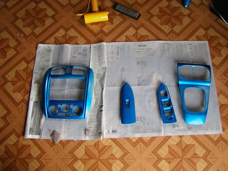

Oh yeah, after primer, I sanded very very lightly with 400 grit sandpaper and then applied the base coat. Then I applied three coats of the color. Unfortunately, the way I'm doing this is I paint it outside and bring it in to dry. It's a bit chilly and humid outside and it's warmer and less humid in the house.. better to dry in here. :D Well, I dropped the one-switch door garnish on the newspaper I've been painting on on my way inside.. Ruined the paint. In half an hour it was back to the same step though..
I have a couple of tiny runs on the handles.. found out that the ones are opposite handles.. Well, those go to the rear doors now. :D My car will probably never be a showcar anyways. They're barely noticeable because of the metallic qualities of this paint too. I have a picture, dunno if you can see or not..
Anyways, other than recoloring that last garnish, I'm done with color. I'm going to shoot it with a few coats of clear too. It may or may not make it look duller from the metallic, but I want the paint to stay on the panels, and not chip off, so that's my best bet. Should I wait a day to clearcoat it or just give it an hour or so until it's "dry" and then shoot it? Anyways, it'll all be done and hopefully put back in the car by Monday. I want to give it ample time to dry.

haha i just saw that the paint perfectly matches my PS2 controller. :D
That base coat by itself, by the way, makes an excellent silver color. The top coats are really thin, almost watery, and are translucent so the metallic comes through.
looks nice! i'd make sure the paint is good and dry before the clear coat.

I waited a while and it was "dry" to the touch so I went ahead and shot it once with clear. It actually didn't decrease the metallic-ness at all.. It's shiny now though. :D And it made it a deeper blue. It's very nice looking. Pictures don't do it justice. It doesn't look 150% great because, well, it's just spray can paint. But I'd say it's at least 97% great. :D
