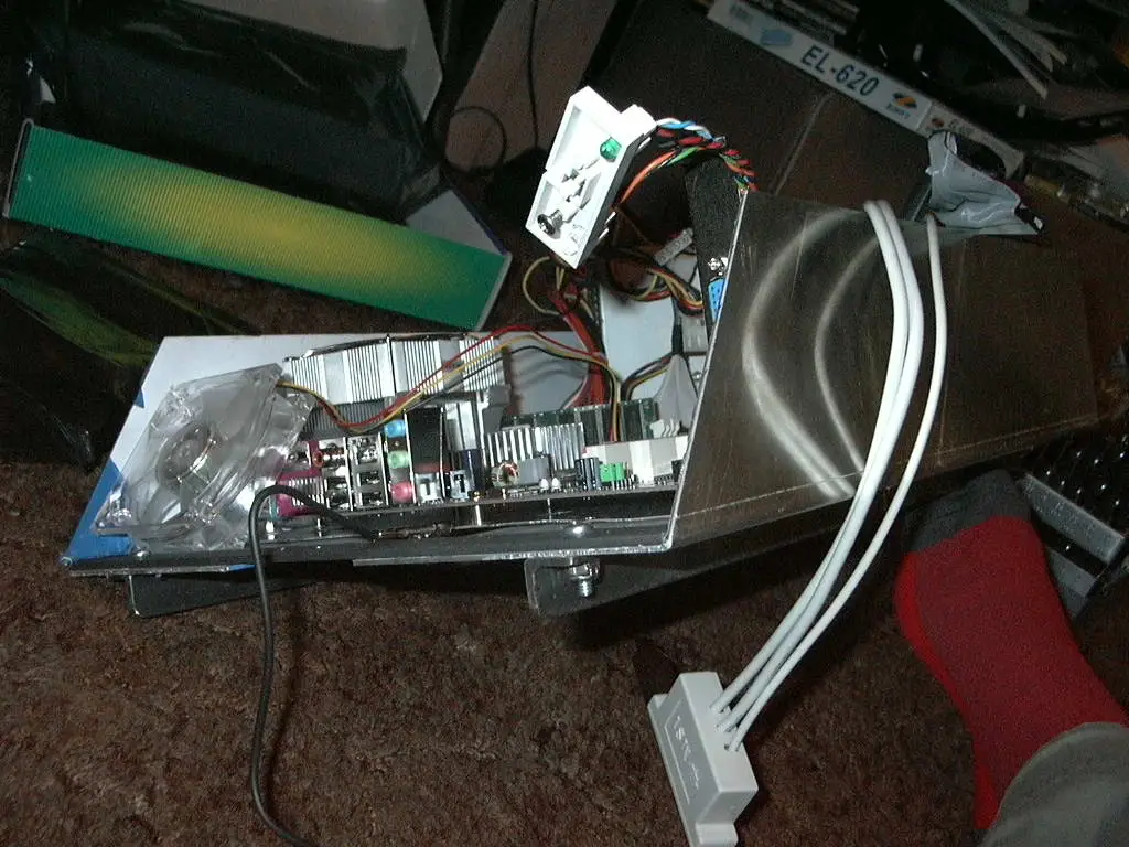

speaking of the monstrosity... I've got a functional case. This is the basis of it. Should be a bit prettier eventually, but fornow this keeps things solid and mildly protected. There's protective film on the polished aluminum sides, and of course led's and plexiglass, The harddrive rack thing is temporary until I get my HDD fan setup, and I know what height everything needs to be to mateup with my plexi cover.
That's a AC PSU inplace until I get everything loaded up and ready to go into the car. At which point my precious opus goes in.. On that note, you can see that there's rails onthe bottom, I've got mating ones bolted to my pass side rear seatback.Perhaps 3/4" angleiron is overkill, but I want it solid, yet semi-removeable...

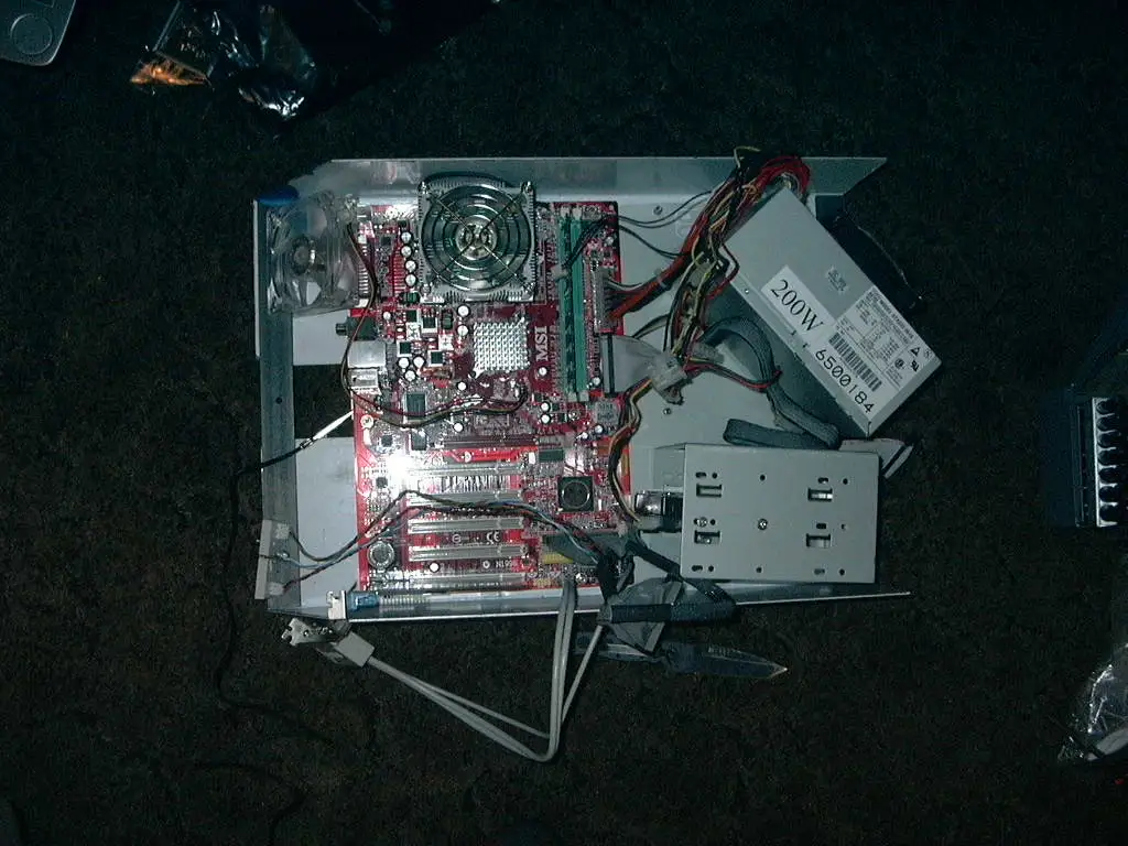

ahyes springbreak means playtime and me up at 6am playing with bios.... the good news is everything new seems to work.
thebad news. the old Harddrive IS indeed toast. *ugh* stupid thing... why isn't there anyplace open at 6am to sell me a harddrive...

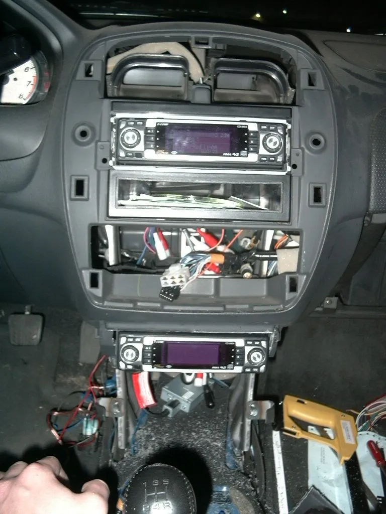

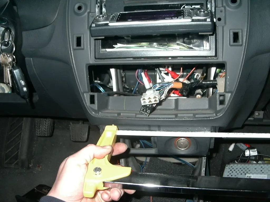

So having a screen up in the dash means there's nomore room for my precious eclipse that I shall own until it dies, and then I shall find a new one, or perhaps buy the other one we'v ehad in our display at the shop for awhile now.. long enough that they ley me borrow it overnight to testfit without losing all of my settings. Between both, that's $1200 of headunit right there kids....

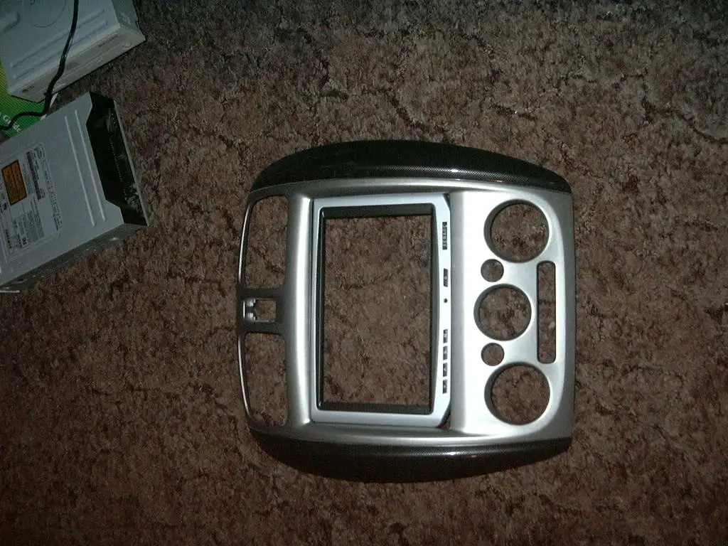

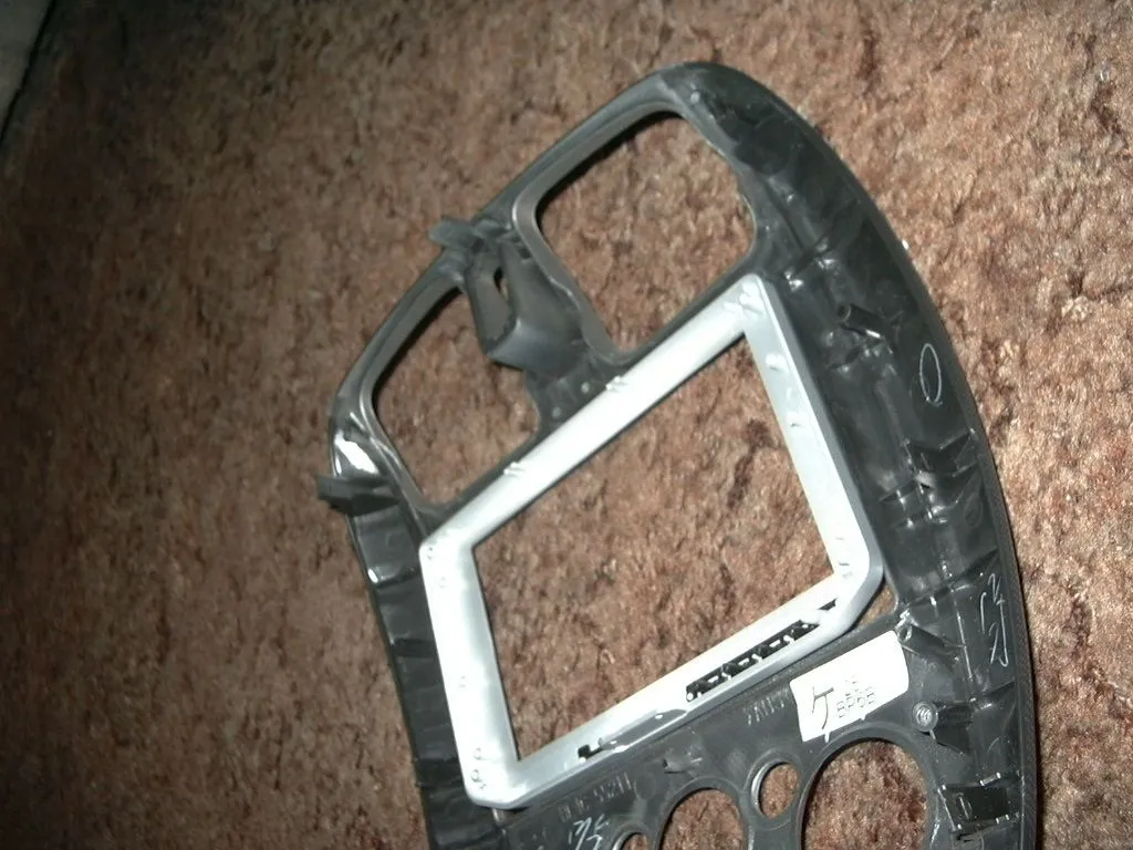

at anyrate here I am again, thistime It looks like I'm in good shape... and WOW xenarc bezels fit into P5 bezels NICELY... the top and bottom are very snug but you cna push 'em through it's just a tad wide, so with a cut and a snip and a little shave we'll be glassedin in notime.
