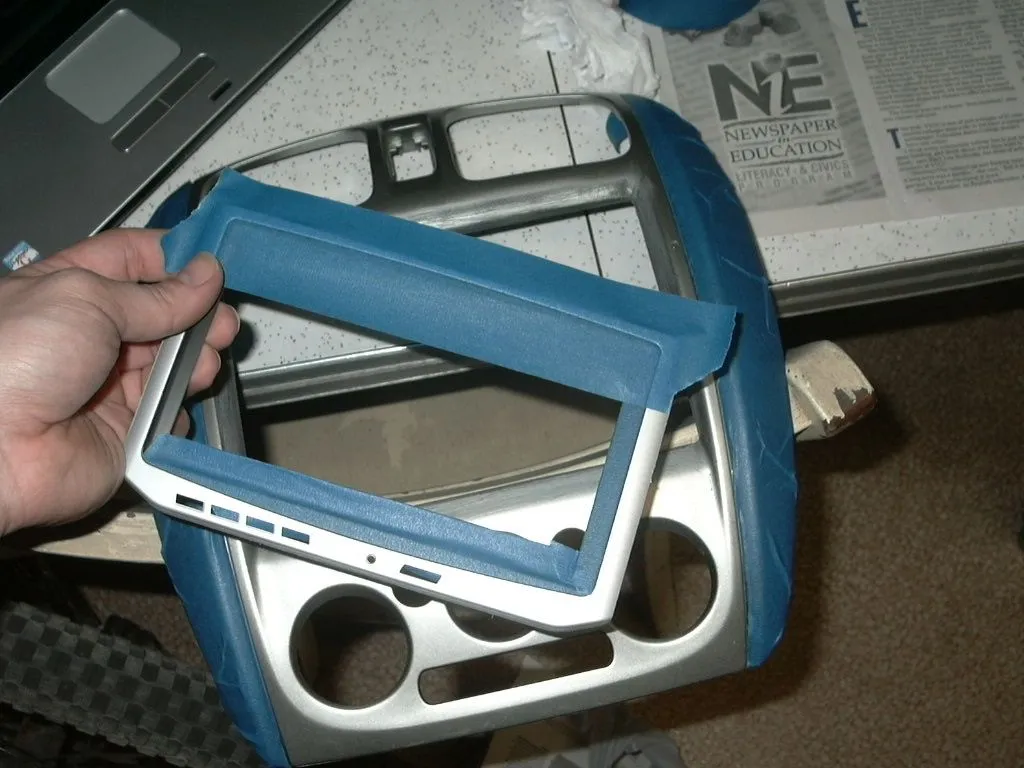

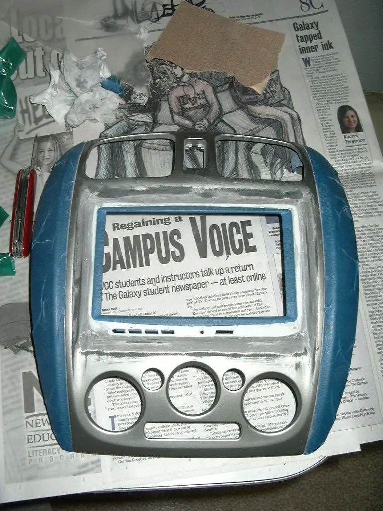

At anyrate, screen's molding in alright sofar... I decided to try to keep the black surround for some definition, we'll see if that winds up flying or not, sofar it lookslike I'll need to re-black it eitherway. I sanded through the tape in a spot, had to re-apply.
DAMN that's alotta sanding BTW. The last pics' after my first application of bondoglass/sanding. I've since bondo'd once more and sanded and then added another layer of bondo tha tI'll be sanding tomorrow prolly at work. Ideally I'm shooting to maintain alot of the original contours. Sofar most of the molded in screens I've seen almost get too flowy. which winds up neat, but kinda un-mazda. in the end, it'sa screen going in my dash, who gives a flying F... it'll be neat-o and s***.
