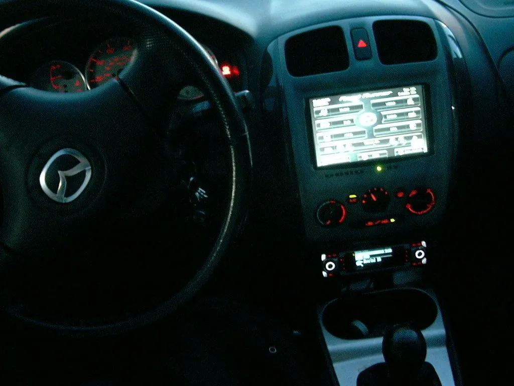

At anyrate, for pics explanation... umm well there's my dash, in all of it's primered glory. It's soon to be removed and hopefully prettied up in quick order. I really wanted to keep some of the original definition and lines to it, which actually wound up being harder than it would've to "flatten" it more instead of sinking the face in a bit. I'm also pretty sure i'm gonna try to keep the black surround at all costs. I really like the way it looks. A little more intended and a little less "custom"
The computer itself is mounted on the pass side rear seatback, sothat it can be folded down and accessed additionally and not really visible, it's mounted on rails sothat the whole unit cna be loosened with 3 allenbolts and removed from the car for doing more in-depth monkeying.
Also, as you can see, USB hub hacked into the console. before you wince, It previously had a big gouge right there from wher ea half-finished kickpod assembly's screw drug across it heavily. so this was simply a cleaner deeper version of the original... It's a 7port hub, 2 are underneath and run to my touchscreen, and external dvd/cdrw drive that's jsut sorta wedged betweent he seats fornow. THe other slots on top are filled with GPS mouse, bluetooth, flashdrive, and keyboard USB. (the 7th port is on the side facing the pass seat, mildly accessable if you REALLY want at it)
Mostly I was quite amazed at how clean-ish everything managed to turnout. and I'm not rlaly done yet. the hub's getting an aluminum trimplate, and my screen and silver int trim pieces are all gonna get a freshened "dull aluminum" paintjob.

Hey so I realized that I never reall yposted any completed pics. I've got my screen prettymuch how i want it now. LOTS of sanding primering sanding bondoing sanding primering sanding painting sanding, etc...
At anyrate, this's been inplace for about a month now. and sofar I'm prettysure that I do NOT realyl like the blue. YES it matches my car but it ties into precisely NOTHING on the interior and I'm not sure that I could imcorporate more without getting gawdy.
also, there's a bit of scratches around the buttons leftover form cleaning them out. I'll eventualy pull it, go blackwith my screen surround, etc. but for nwo it's bene in and working great, nad looks fine. I could nitpick at it all I want but the truth of the matter is the tiny little dips and inperfections that you notice when working onit are nonapparant in-car and I can live with that.
