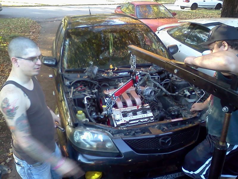

Going smoothly so far. Had a very late start today but much progress was made. Started with this at about 12:30 and a little over an hour later we had...

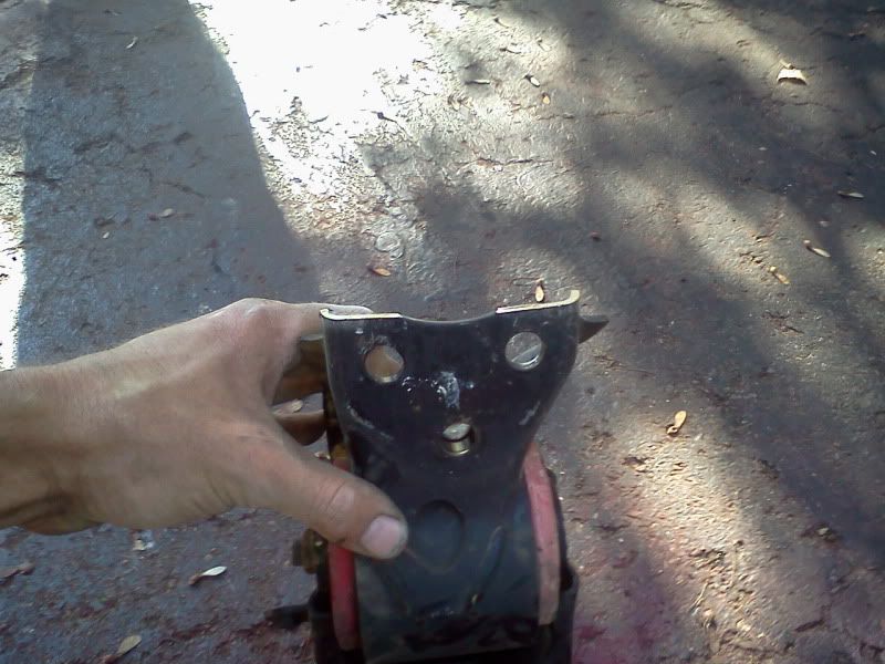

Went to the local BBQ place and over ate some killer grub which wasnt the greatest idea we've ever had because we were feeling pretty much worthless when we returned. lol. Anyway, I was looking at the stock rear mount and it was utterly demolished and, well, wimpy. After some small modification to the probe mount (which already had a RR poly insert) we had some added beef. Only needed to trim the back of the mount nearest to the firewall down about 1/4 inch.
Around 4ish we had her new heart in place.
