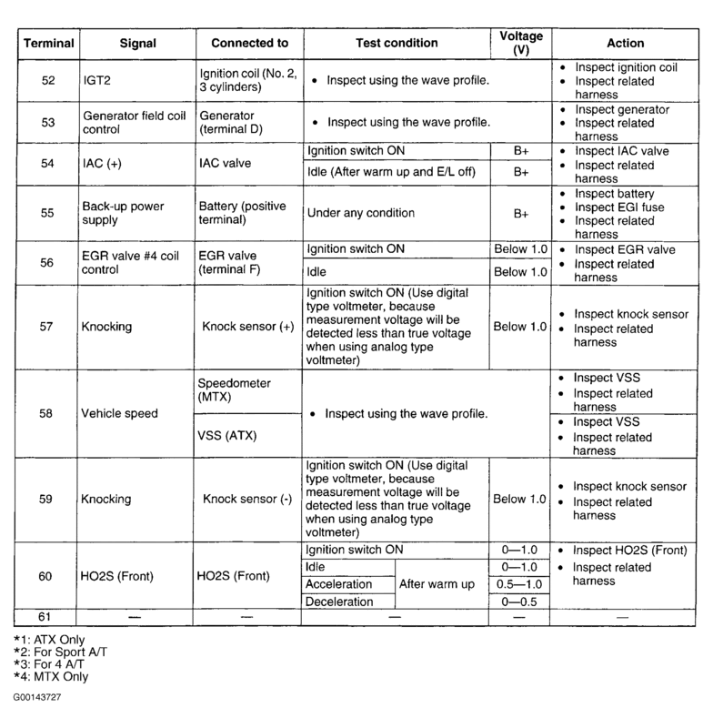

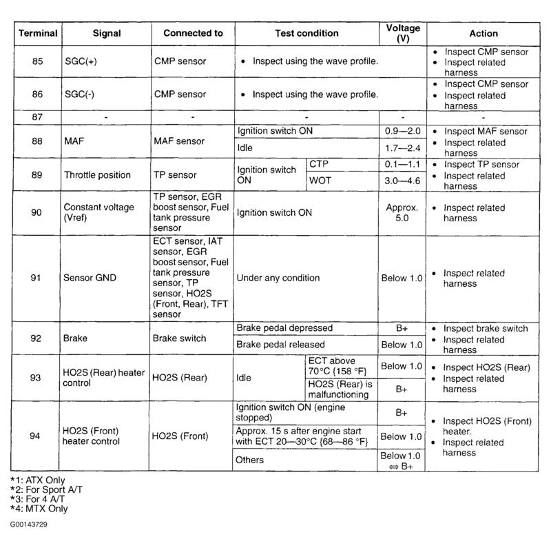

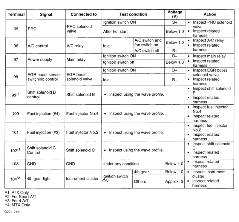

and do you still need a p5 pinout?
If you have a pinout that shows every single pin that would be great when we start eliminating the P5 harness/ECU. I kinda have one right now but its a pretty scattered diagram that doesnt show each and every pin, but it should be enough to get the car started.

No not yet. I think Jim has it pretty much figured out for now though. We will just need the pinouts for when we are eliminating the harness and ecu. For now we are going to run both.
Yeah, tomorrow will be the wiring portion which shouldnt take too much time to complete being that theres not much to splice into to run both harnesses. Jedidiah, I still cant get into that place you sent me the link for. Dunno whats up with that, but like Andy said, I have enough info to get the car running, just not enough to ditch the stock P5 ecu yet.

and ill print out some pinouts and scan them for you and ill send jpegs if i can of them
