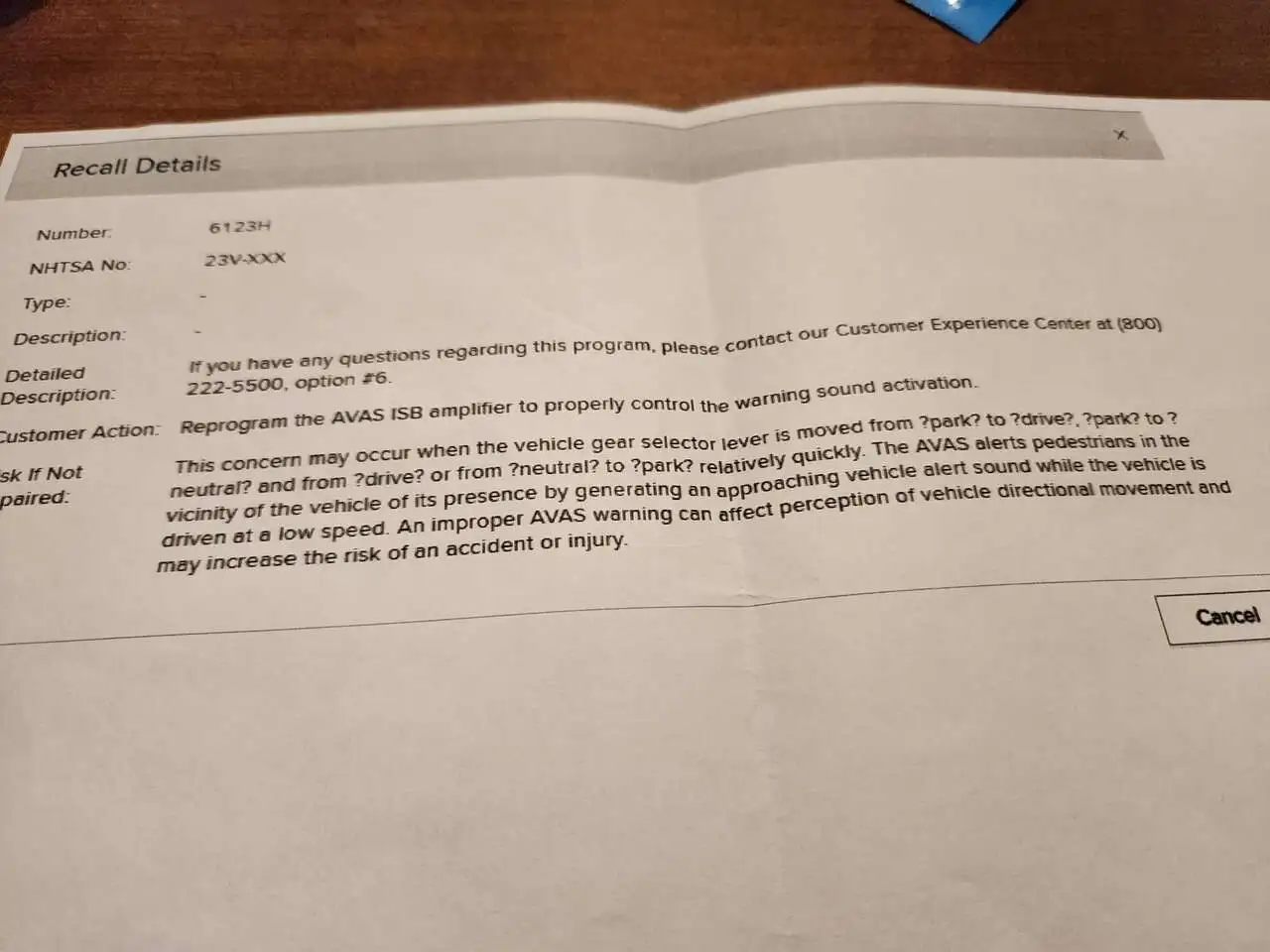

I'm not sure if anyone got the recall for the BSM false warnings but here it is. It isn't a TSB, they made it into a recall. Thanks to my husband for getting this started. He contacted the NHTSA and they got on Mazda to get this fixed. I attached what we got from the dealership on this. So supposedly this for all the 17,000 CX-90's that is on this recall. Got this done on Friday, 🤞🤞🤞 so far so good!

Yeah, that's not for the false BSM alerts, it's to correct the AVAS pedestrian alert. It didn't do a darn thing for my false alerts.

It should of. I would make sure it is the number 6123H and the NHTSA number starts 23V-XXX. I hope they made a mistake and need to redo it to the right recall #. Let me know what happens.

Looking at my work order, it reads Campaign 6123H; Update to AVAS IBS Amplifier per MGSS recall repair procedure. As I said previously, it didn't do a darn thing to obviate the false alerts, as one occurred five minutes after I drove the vehicle off the lot.
