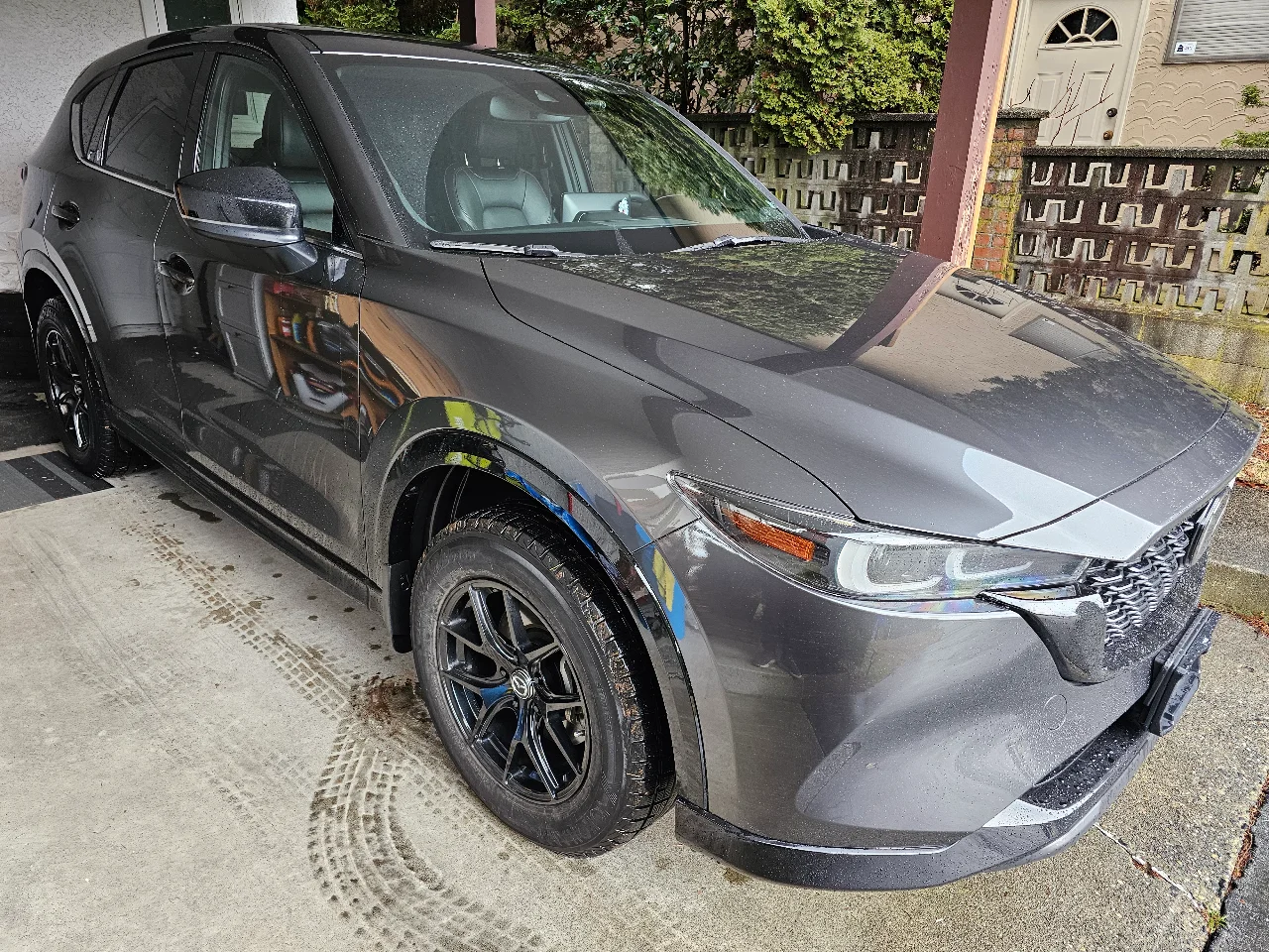

Winter Shoe, FC04 17x8, +35 offset with 235 winter tires.
Custom adapter for a Mazda wheel cap.

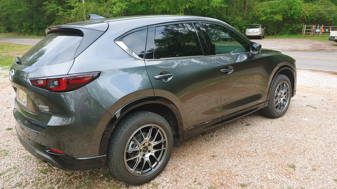

I had the FC04s when they first came out in Canada. Titanium silver and 18x8 for my 2015 Mazda 3.
19 pounds each wheel and the centre caps didn’t fit because they impacted with the wheel hub centre.
I wish I had kept them, I sold them a few years back when I got my CX5.
Ya I was eyeing the FC04 for a while now, initially wanted to get bronze color (not gold) but settled with black to match the OEM look, they are reasonably priced, good looking and relatively light weight among others.
Good thing is they are wildly common (careful of knock off though), easily source new/used on FB marketplace so if you decided to get them again it shouldn't be too hard.
I did heard about the hub caps fitment with rear wheel, I haven't put the FC04 caps on so I cannot comment it but they do sell a raised hub caps in case it is a problem, and a lower offset also helps to reduce the chances of hub cap interferences.

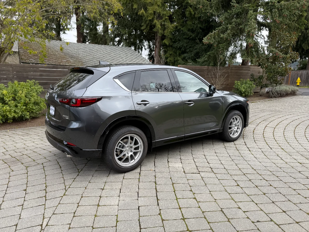

I just brought home a new 2025 Turbo Premium and was excited to get the Enkei PF01s that I had on my daughter's CX5 for a bit onto the new car. I couldn't deal with the stress of having them on her car :)
I typically really hate black wheels but I had to admit that the gloss black wheels on the Turbo Premiums looked pretty darn good and I was worried about how the PF01s would look. The thing I was most curious about was weight. I'm a big of a wheel/tire weight nerd.
Stock 19s (19x7 et45) with the Toyos: 60.6lb
PF01 18x8 et40 with Pirelli Scorpion A/S 3: 46.6lb
So, a really significant weight savings, some additional improvement in ride, and WAY better tires. Lookung forward to seeing how it drives but in my experience it should definitely ride better, and accel and braking should feel more responsive. This is a major weight savings.
That is a huge weight savings. Those tires must be extremely light. You'll feel it in the steering.
My Contis are ~28lb each.
The Pirellis I'm running are 28lbs as well, and the wheels are 18 and change ==> 46.6
Stock: I looked up the tires and the Yoko A36 are 29lbs which puts the wheels at... 31.6! Jeez.... Mazda seriously did not GAF on the 19s. There are great wheels made in China, but I found it interesting that the OE wheels are made in China and obviously not focused on any sort of weight savings.

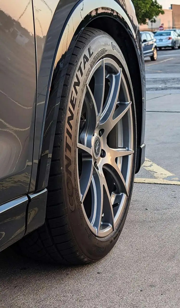

This pic is with the OEM Toyos. The Conti's look a little better. I need to take some pics...
