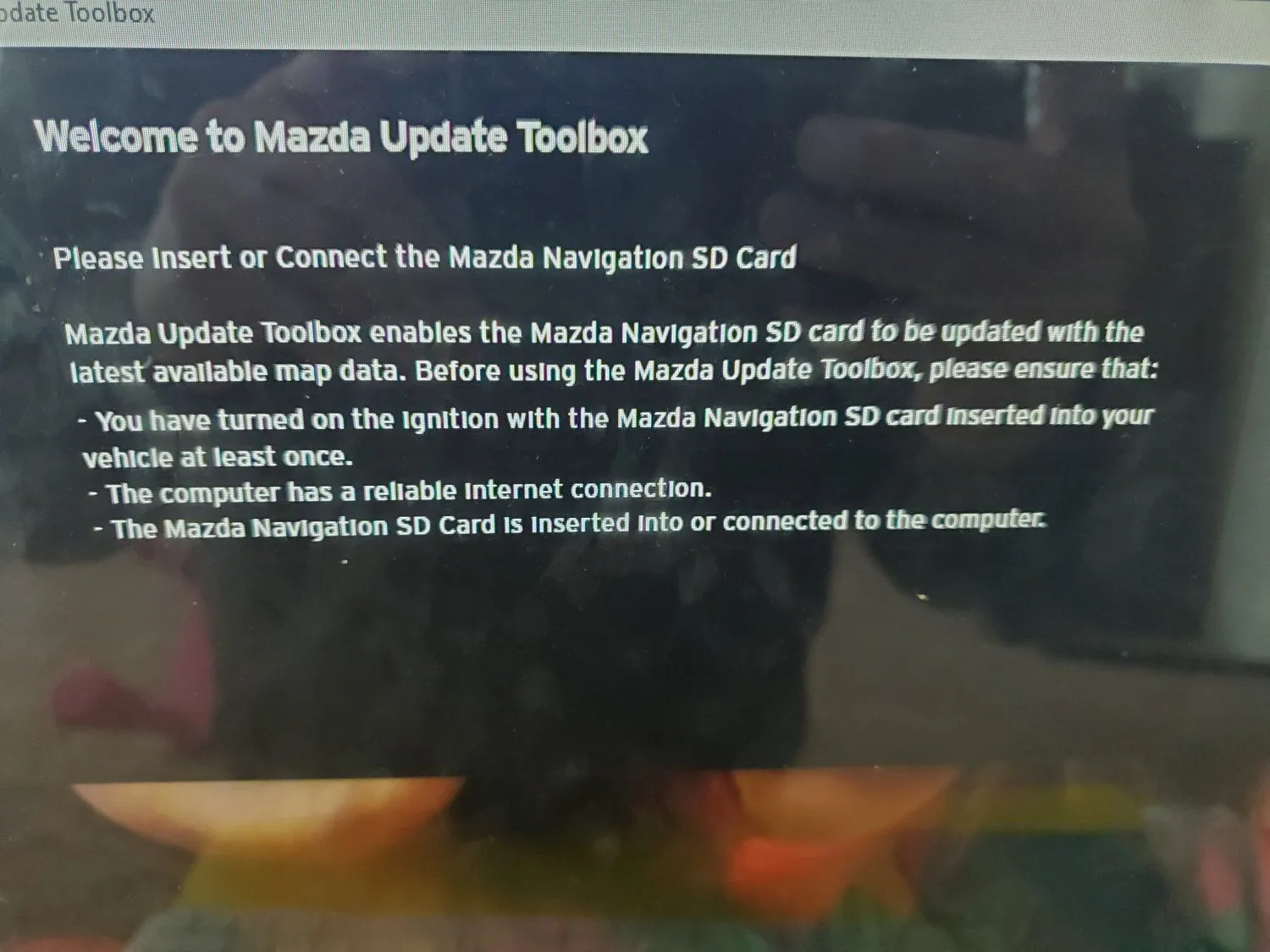

Guys where is the drive 63 or so miles to pair SD card to vehicle info located? I downloaded mazda update toolbox and only thing it mentions is to have turned on ignition at least once after installing SD card.
I'm impatient and want to try an update...have only driven 5 miles since installing SD card lol.
Alright guys! My ebay card was recognized by Mazda update toolbox! Seems like you don't have to drive 63 miles to sync it. Like the screen shot showed, you only need to turn ignition on once to pair.
