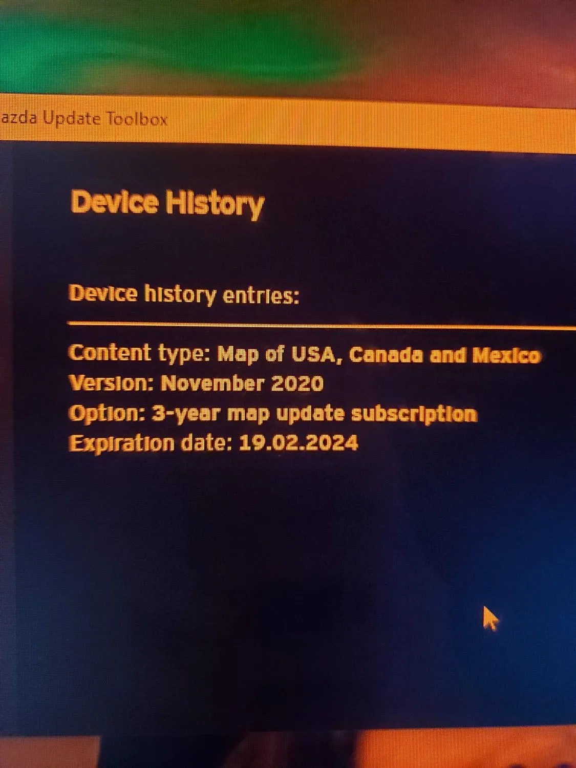

I just tried again with my ebay card. Mazda update toolbox recognized it no problem but says I have latest version and it says "November 2020" as well.

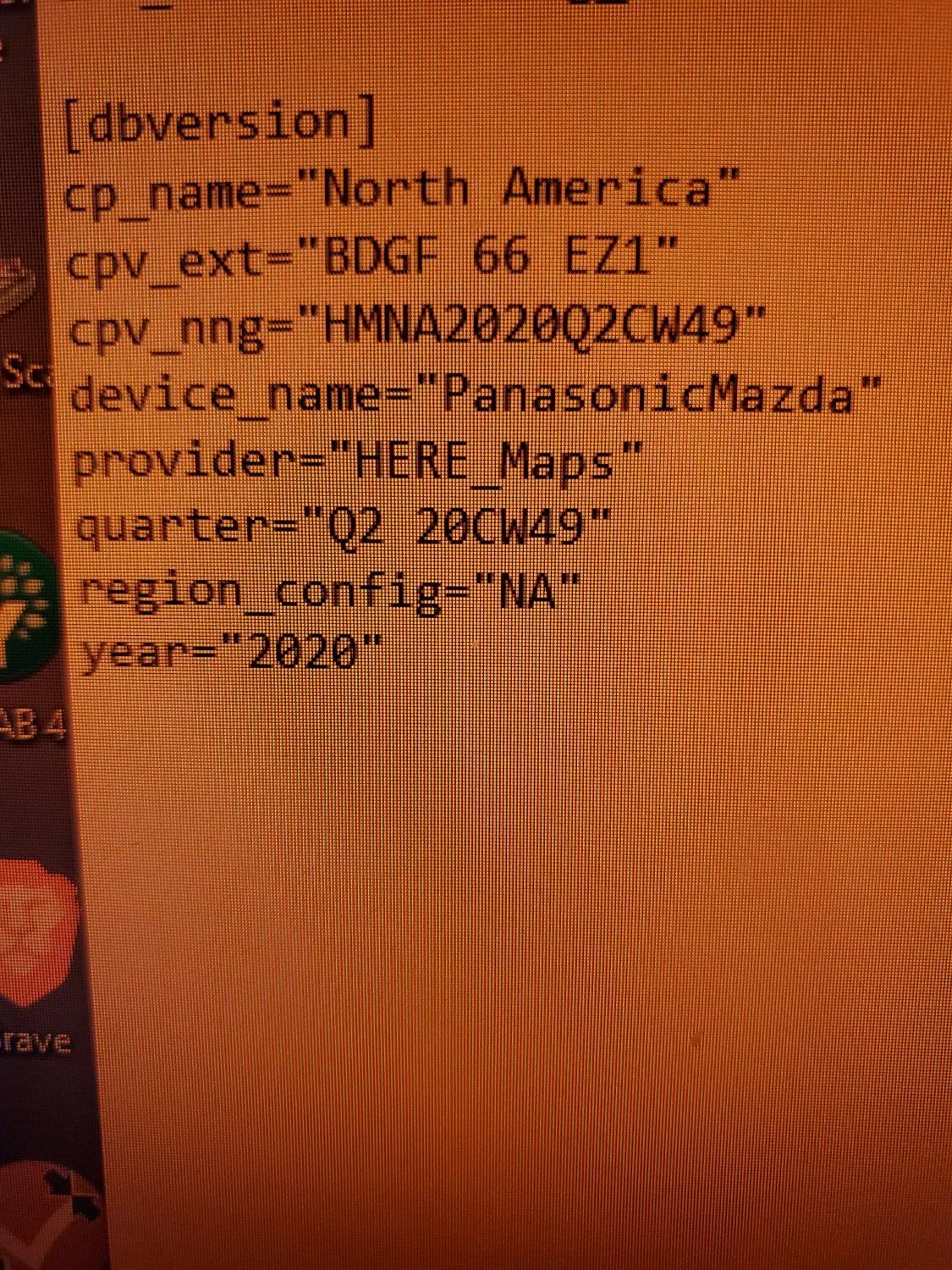

Weird thing is I bought a TD2K66EZ1 card but the info file note documents I found when I open the cards contents to view is "BDGF66EZ1". I looked this up and found it's for the Mazda 3 2019-2021.
I wonder if I got sent the wrong card? This is what happens when I use an ebay card I guess but the navi did work flawlessly in my CX9 hmmm.

So I have the 2021 CX-5 GT 10" newest infotainment system - it says no updates available, despite my expiry showing as February 2024 for 3-year map updates. It shows current version: November 2020, while the website shows new map available February 2021. How do you get it to update to February 2021? The toolbox keeps telling me there are now new updates available and when I click to buy new update within the toolbox it says nothing to buy here.

I have a 2021 CX9 and came across same issue, same expiration as you February 2024. I realized that it may be that the update is as of month/year February 2021 with the actual maps update November 2020 (if that makes sense?).
I even received an email from update tool box that new update is available as of February 2021 but everything I tried shows my card us up to date.

I was really worried I'd be disappointed with the nav card I bought off ebay last week for my new 2021 CX5.
The label and piece of paper in the bag along with the SD card said TD2K, but the \conents\dbversion\info.cfg file had this info:
[dbversion]
cp_name="North America"
cpv_ext="BDGF 66 EZ1"
cpv_nng="HMNA2019Q4CW14"
device_name="PanasonicMazda"
provider="HERE_Maps"
quarter="Q4 20CW14"
region_config="NA"
year="2019"
I put the card in before I drove home from the dealer and took it back out a mile later when I got home. I'm happy to report the toolbox update did just what it was supposed to and told me I've got 3 years of updates coming.
