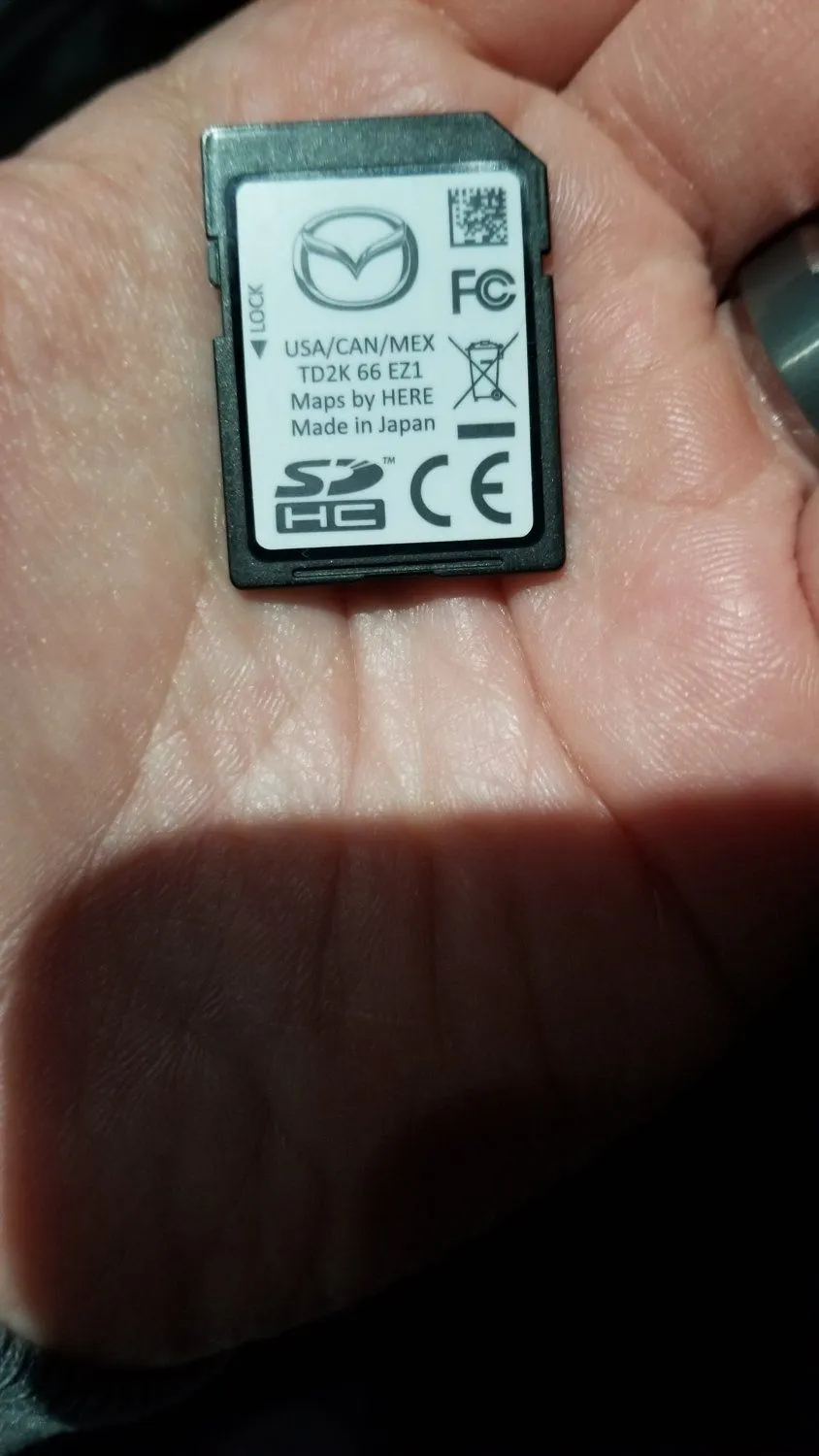

That's interesting, does it look like the photo of the card I posted? I have noticed that there are now more sellers of these cards on eBay, and they don't all look like mine.
My dealer card appears to have both the CE and FCC markings like yours does. Again, my card was inserted by the dealer and not purchased via and ebay/amazon seller.

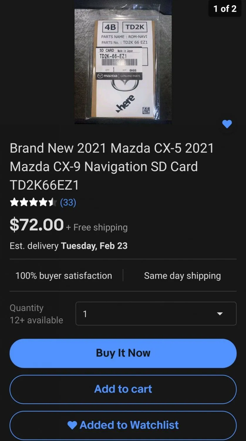

What I did was send a message via Ebay and ask every single seller of the 2021 cards if they are OEM or clones and if they can be updated. I've received 3 replies so far and no one answered if they were clones but all of them said they cannot be updated at all.
I just picked up my 2021 CX9 so would like a card I could use to get the free 3 years updates and it's looking like buying from a dealer is the only option. I'll just keep using my phone for now.
Update: 1 seller has been very responsive and said he doesn't require VIN # like the navi-usa seller who has been mentioned on this forum. I am wondering if that navi guy requires VIN to go into the SD cards and manually update some files?
This seller said no refunds available but has a high rating and he said he has sold 20 of these 2021 SD mazda cards and so far no one has complained about failing to update the cards. But maybe no one has tried updating yet.
I plan to buy one and be the guinea pig and test to see if his card can be updated. He said it is true OEM but who really knows.
My original plan was to buy on Amazon so I can easily return if can't be updated. Unfortunately no Amazon cards are found.
Purchased card. Read sellers reviews on his other Mazda SD cards and some said they updated SD card with mazda tools no problem so hoping this one works.

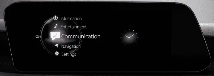

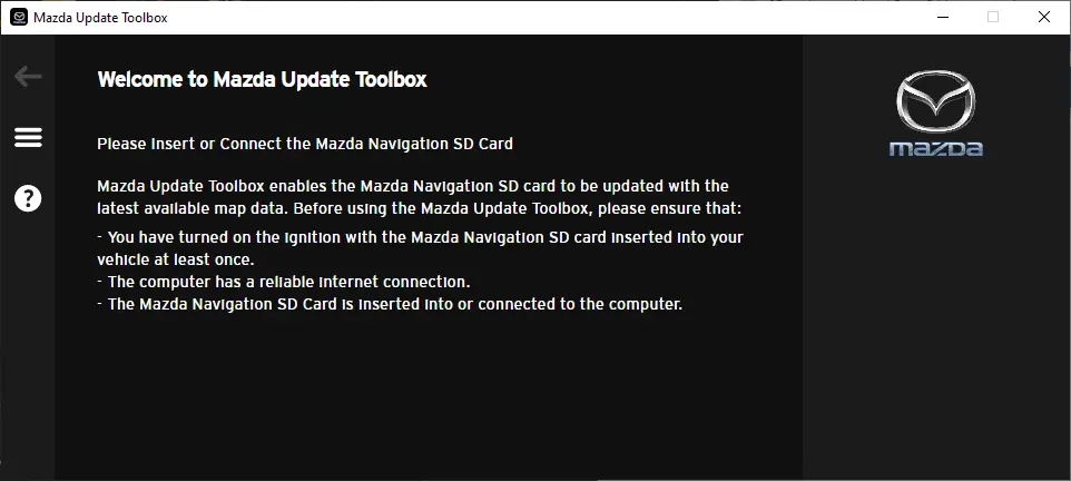

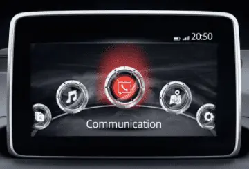

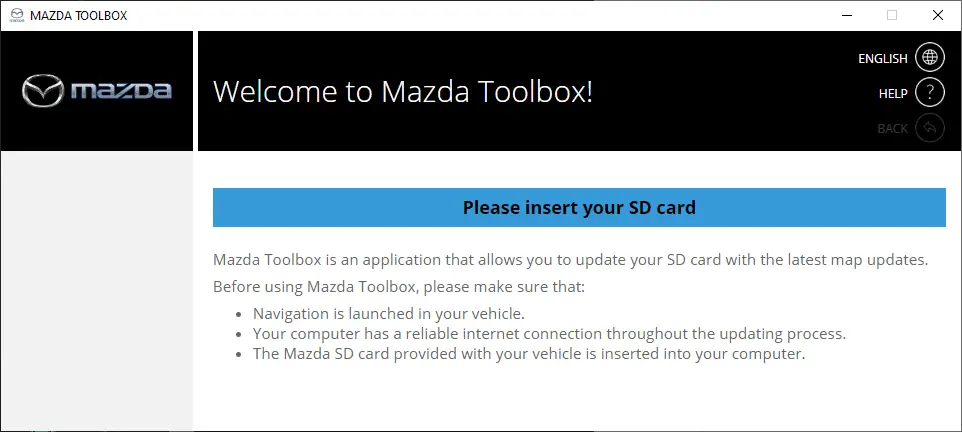

Maybe this is obvious or you are already using the correct one, since this hasn't been mentioned already, but I got confused over this at the time, if you have the newer Mazda Connect, you need to use the Mazda Update Toolbox, not Mazda Toolbox, and vice versa if you have the older Mazda Connect.
Toolbox for new Mazda Connect:
Toolbox for older Mazda Connect:
Link to Mazda Update Toolbox:
Thanks I am new to Mazda and will be sure to use this....appreciate the link/photos.
Is there a way to verify which Mazda Connect I have, new or older so I can be sure to use the correct mazda toolbox. Thanks so much.
In relation to the original set of questions, I am (have been attempting to use at least...) the correct toolbox for my MY21 SD card. Doesn’t recognize the card even though the computer reads it just fine. I'll attempt launching it as admin and see if that does anything.
