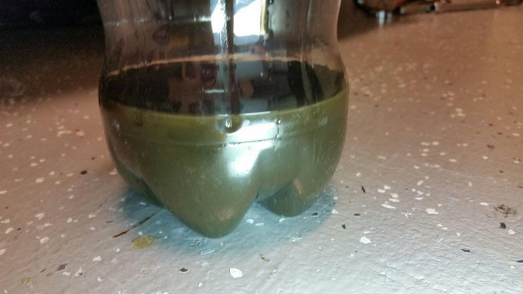

The rear differential was tightened by some gorilla because it was tough to break the plugs. Finally did it and drained it. There was about 1/4 inch of metal shavings on the magnet and the fluid was nasty. When clutch plates break-in, they release tons of debris before they get their mating and wear in pattern. I'm glad I changed the fluid.
The front differential was a lot easier to remove the plugs BUT the drain plug didn't tighten down with the torque wrench properly and left me uneasy. I think they over tightened it at the factory or the threads were not properly cut at the factory. So I put down about 2 wraps of TEFLON TAPE on the bottom drain plug. I hand tightened it with a 3/8" drive until it felt tight and took it for a spin. No drips, no leaks. The front differential drain plug faces straight down.
The rear plugs were torqued to 30ftlbs and the fronts were tightened with a 3/8" drive to snug.
Here if the fluid at 6,500 miles:
