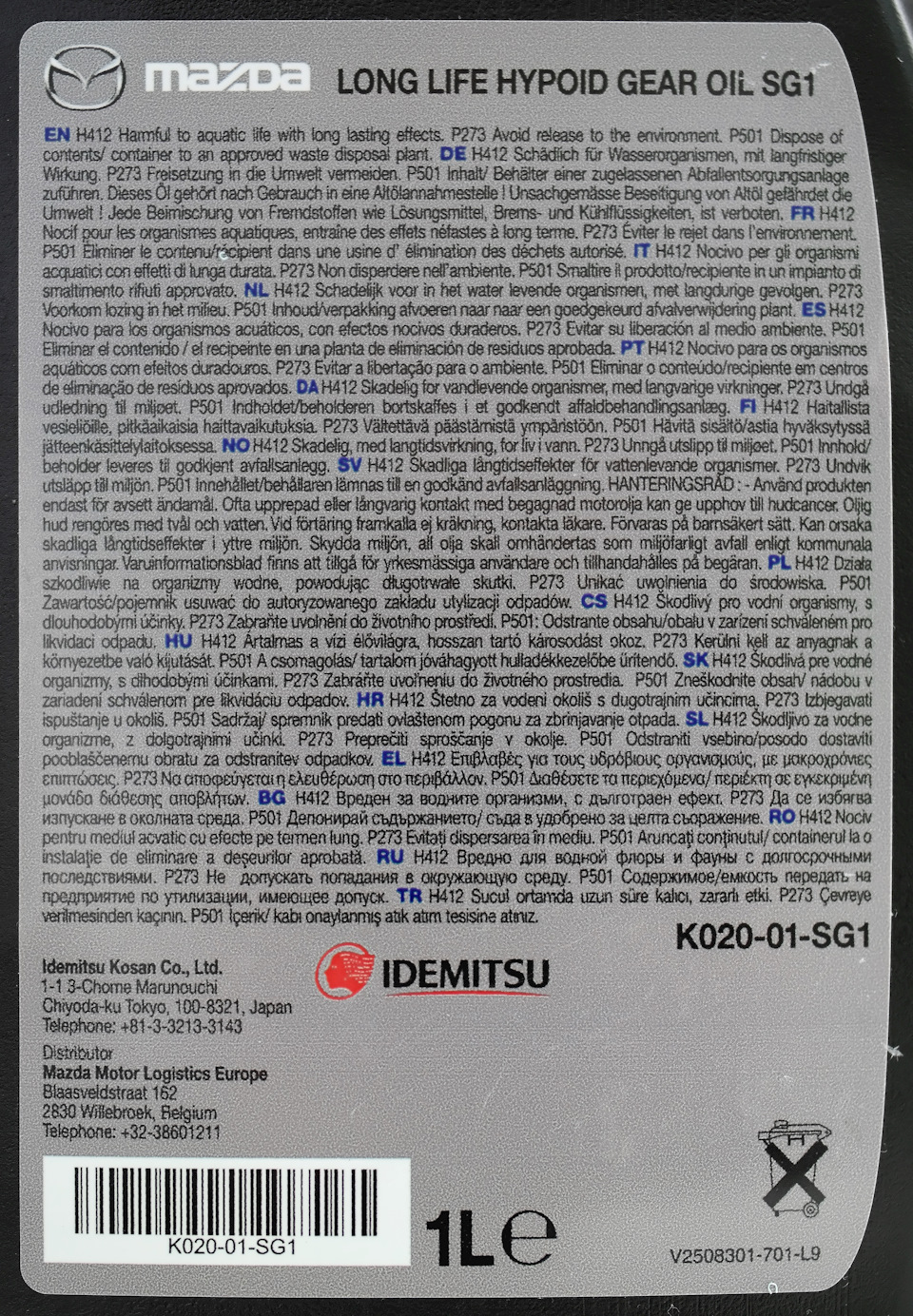

Like Mazda Moly 0W-20 oil, this expensive $29.95 per quart list Mazda Long Life Hypoid Gear Oil SG1 is made by Idemitsu. It's definitely different from much cheaper Mobil 1 gear lubricant.
The bottle of SG1 that I have here is different than the above pic. It still says Idemitsu on it but it's all in English with a warning about Tricresyl phosphate and it's a quart.
Yeah the back label of Mazda Long Life Hypoid Gear Oil SG1 I posted is the international 1 liter package. The warning message is different and is for EU market.
