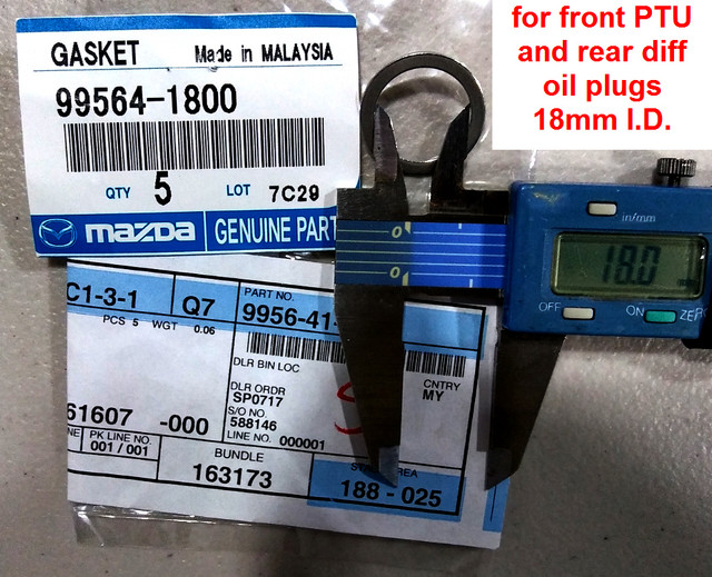

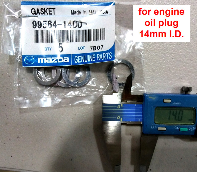

just FYI, I confirmed with dealer, the aluminum washer for the front PTU and rear differential plugs is P/N 99564-1800 (18mm inner diameter)
not to be confused with the smaller aluminum washers for the engine oil and transmission oil plugs P/N 99564-1400 (14mm inner diameter)
Thanks for the info even with a true diameter measurement showed! :) Are you planning to do the gear lub change soon? If you do, please pay attention to the factory-filled fluid levels on both and see if the rear differential level is low like some people had found.
