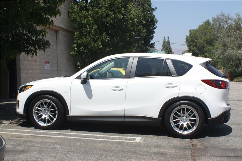

That white CX-5 is actually CJ Wilson's CX-5. What a beauty.
