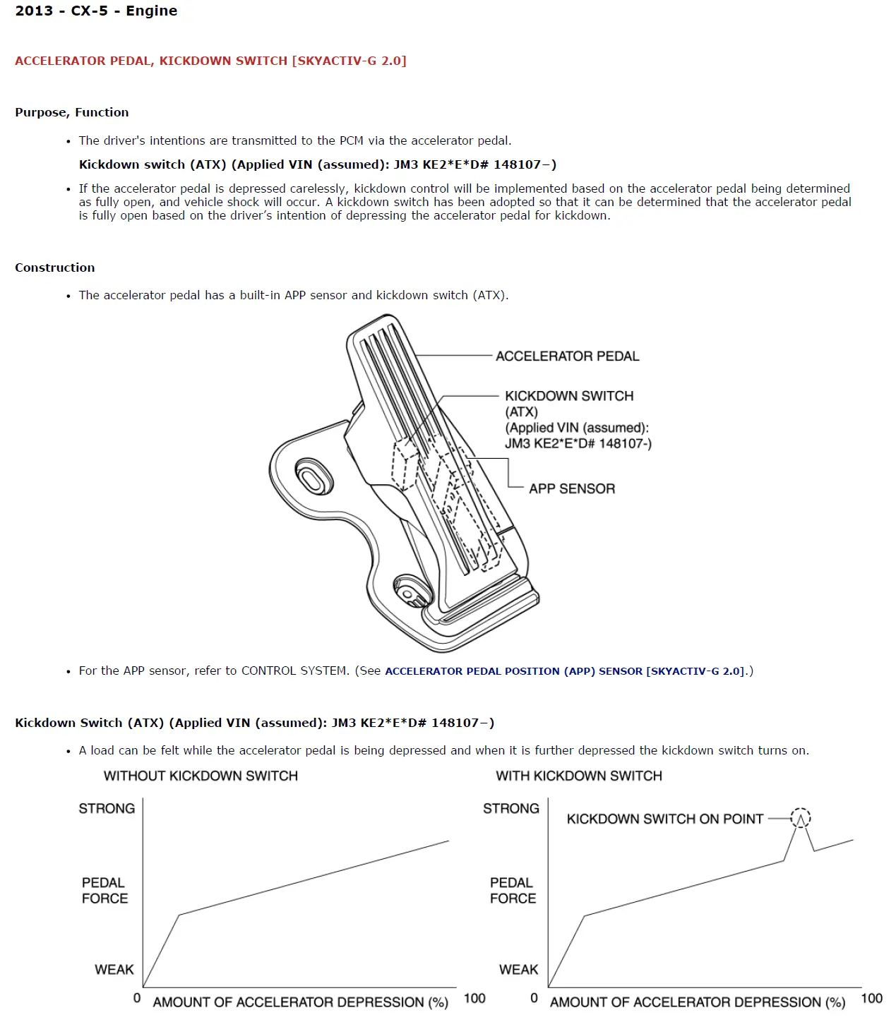

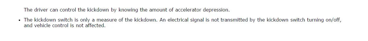

11/20 Update (After driving 1,700 Miles):
Hey guys, I just wanted to follow up on the thread after driving about 1.7k miles. So today I think I finally figured out 50-75% of the problem I'm experiencing with why I felt that after replacing the belt tensioner, my acceleration feels worse. Previously, before replacing the belt tensioner and the water pump/serpentine belt, I had a blast driving the car especially on highways and going from 0 - 60+.
Stomping/mashing on the pedal felt effortless and it didn't really take much for the car to rev up really high and start flying past everything. However, after replacing the belt tensioner all of this fun started to disappear and today I have slightly figured it out. I think most of us are aware of the little activation button on the bottom of the gas pedal (a.k.a Pedal Kickdown Switch) once you press down all the way. I never had to press the pedal all the way down until I heard a click but today after messing around and stomping on the gas pedal repeatedly, the car felt alive again.
The very strange thing is, why did this occur after replacing the belt tensioner/water pump belt and serpentine belt? I still enjoyed the OEM belt tensioner more as I did not have to press down until I hear a click.
Here's some possibilities that I can think of that may have changed the personality of my car:
  1. NON-OEM Belt tensioner: Stiffer design/different lubrication/different wheel bearings/Still not broken in? IDK
  2. Maybe I didn't bleed out the air from the belt tensioner correctly?
  3. Maybe there's some calibration that needs to be done?
  4. Maybe that's how my car was supposed to feel and replacing the OEM belt tensioner brought my car back to the factory shape?
I'm not sure how I feel about this as I was planning to put my OEM one back in because I definitely missed that personality of the car a lot more. Also, I did try Googling around to see if anyone has experienced the same issue as me but I don't think it's very common.

This’s really odd. Is there any difference on gas mileage before and after? Did you disconnect the battery while replacing the tensioner and belts? I believe you use OEM belts so you won’t have problem like minnesotaart who used shorter Dayco stretch water pump belt. IMO your Gate tensioner should not give you the problem you described. Something else happened during your belt and tensioner change.
i second that, I doubt the aux belt and tensiomer change can produce this effect.
Did you disconnect the battery?
I wonder what causes some tensioners to leak? Lot's of higher RPM operation?
I guess when revving high the belt is flailing back and forth causing excessive motion in the tensioner?
It would be hard to imagine how that could affect power output from the engine.
Gas mileage seems about the same. I think I disconnected the battery but I don't recall anymore as it was a while ago. Would disconnecting the battery make a difference? Here's what I've done:
Replace/Perform:
  1. Belt Tensioner: The only non-OEM item; may affect the pedal kickdown.
  2. Water Pump Belt: Shouldn't affect the pedal kickdown
  3. Serpentine Belt: It's OEM, so it shouldn't affect the pedal kickdown and after driving 1.7k miles, it should've worn in already no matter if it's stiff or not.
  4. Belt Tensioner Nut: Shouldn't affect the pedal kickdown
  5. Belt Tensioner Bolt: Shouldn't affect the pedal kickdown
  6. Bleed air from belt tensioner: I slowly rotated the the belt tensioner and took longer than the recommended 5 seconds and performed this procedure about (3) times.
I mean I can't think of anything else aside from these variables that I touched.
