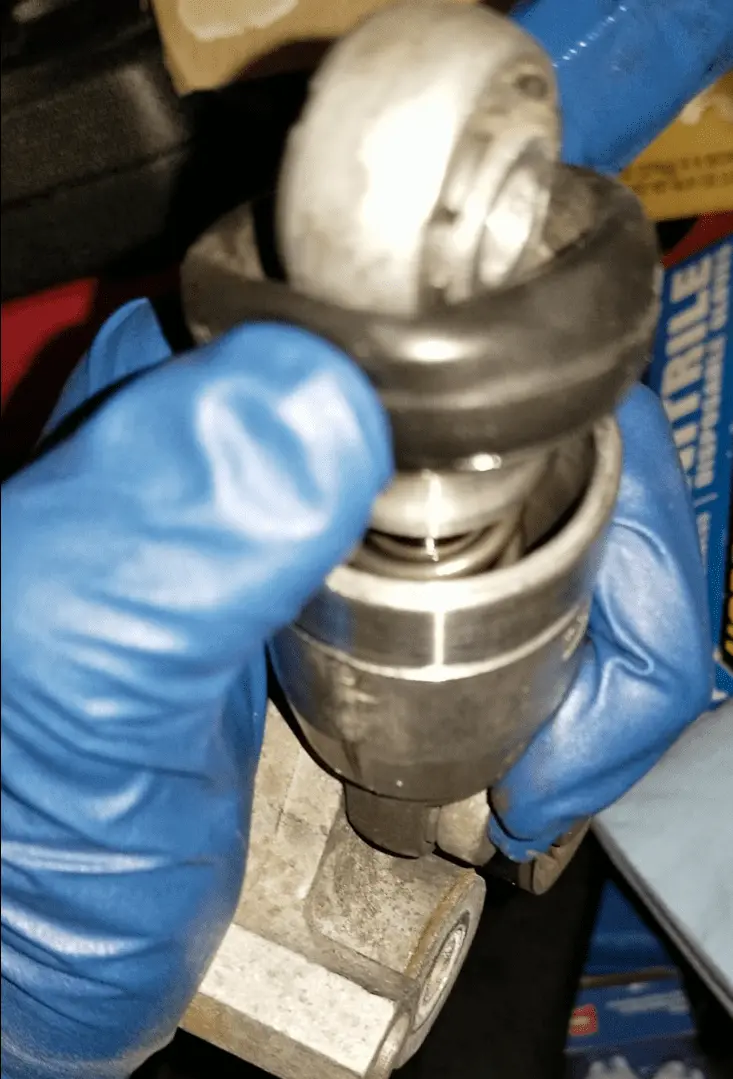

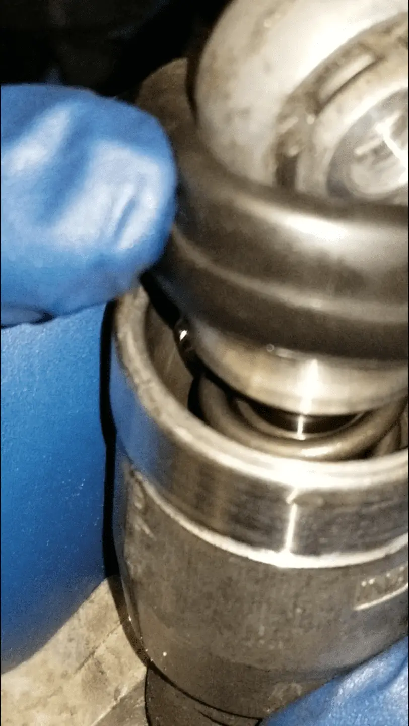

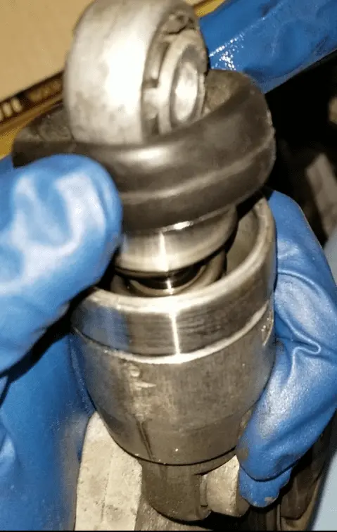

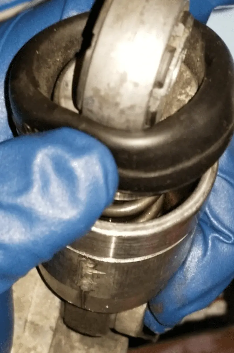

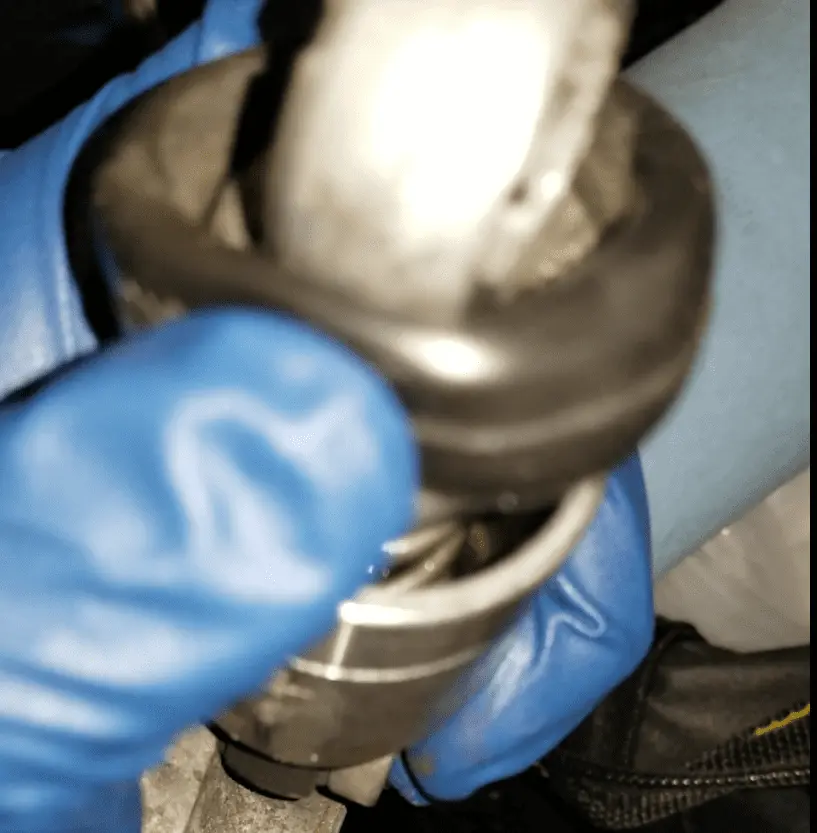

Upon pulling back the silicone/rubber housing, the fluid seems to be a very light viscosity/consistency. I did spill a bit of the fluid since it was tilted and when I inspected the insides, there really doesn't seem to be much in there at all (seems empty).
I don't know if it's still a good idea to install the OEM one back after spilling some of the fluid out so I may have to reconsider that. If anyone knows what kind of grease I can fill it back up with, feel free to let me know.
I did try to pull the tensioner arm back and forth (gently) and it feels a little stiff. Not sure if that answers your question or not.

Does the new one feel stiffer when you work the cylinder back and forth compared to the leaky one?
Does it seem to have a better seal?
Appreciate the report Digbicks. The good news is you know how to change the tensioner. The bad news is not having good experience with the Gates tensioner.
I have no idea what type of fluid they put in there. My guess is hydraulic fluid?
