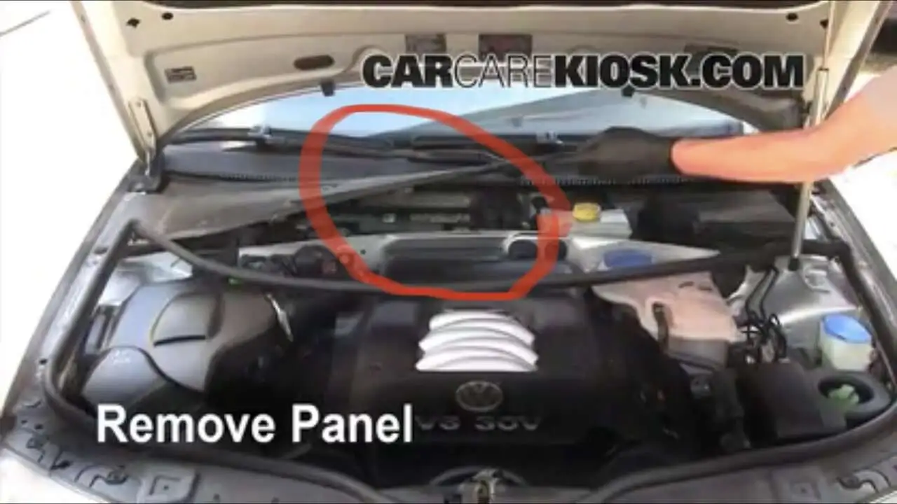

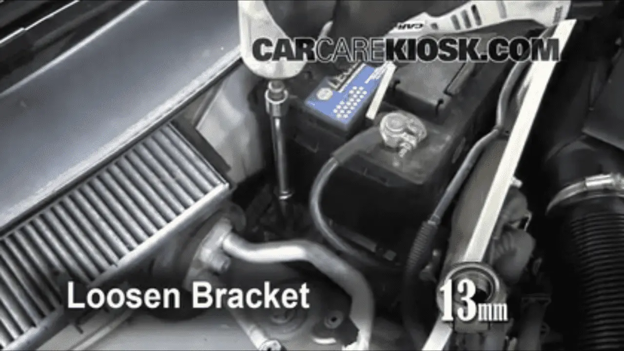

Actually the battery location is worse on VW Passat B5/B5.5 (1997–2005) as the battery is located right in the middle of the room under the cowl below the windshield. I literally had to climb into the engine bay on the V6 and pull the battery out. My back would always be feeling funny after the removal and installing the battery on my 2001.5 Passat GLX.

Like Kedis82ZE8’s G35x, B5/B5.5 Passat has similar battery location, and similar problem with clogged drain hole right under the battery. But if your previous Passat had the moonroof, the water on the rear passenger floor actually is caused by the dislodged moonroof drain hoses mainly from the A-pillar down to a rubber drain valve on the body.
The transmission control module (TCM) for automatic on B5/B5.5 Passat is sitting on the floor under the front passenger seat, the flooding usually will kill the expensive TCM. Luckily my Passat was a 5-speed manual and It didn’t have the TCM when my Passat got flooded.

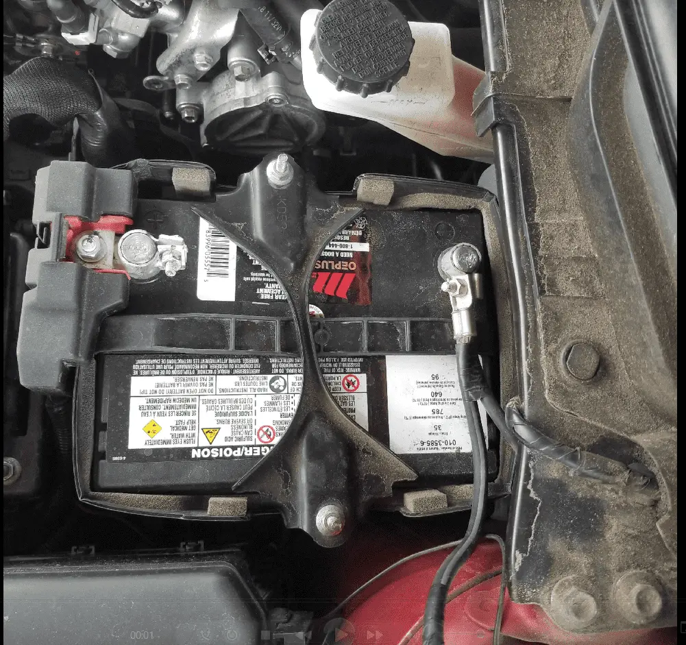

WARNING: the plastic terminal cover is pretty weak....I managed to snap mine off.
Here's a pic. The hood prevented me from getting directly over it and getting a better pic). The negative terminal/back end of the battery is positioned just enough under the the cowl that you can't pull the battery out straight up; hence the need to tilt the battery up at the positive terminal end and slide forward, up and out.
I also snapped the terminal cover recently after flipping it up about 100 times in the last year or so to connect my charger/maintainer. I prefer a soft vinyl type!

I went to my dealer today to get some parts and I've ordered a replacement cover today (I forgot the price but it's not cheap) and I'll be very careful not to lift it up too much anymore especially when it's cold (lesson learned) as it's made of thin hard plastic. The good news is that you don't need any tools to replace it, just push the tab to release it and lift upward :giggle:

I thought the terminal cover was more expensive (perhaps I misunderstood the clerk when I ordered it) but it's only $11.24 plus tax. Not worth trying to fix it with electrical tape or zip tie ;) P.S. On the pics you posted earlier, I noticed immediately the big red M Motomaster logo on your new battery so I knew you got it at good old Canadian Tire :). I've been getting mine at Costco for ages.
