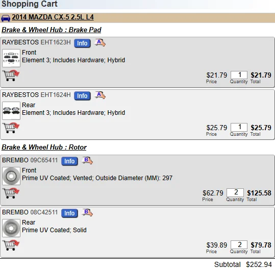

Thanks for the input all. Thinking I might try the Brembo rotors with the Element 3 pads. Thoughts?
The shipping is about $32. Not bad really, under $300 for everything.
