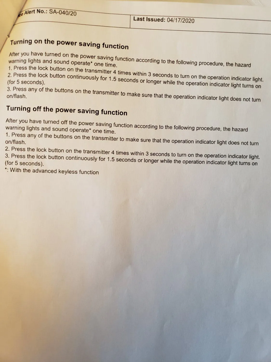

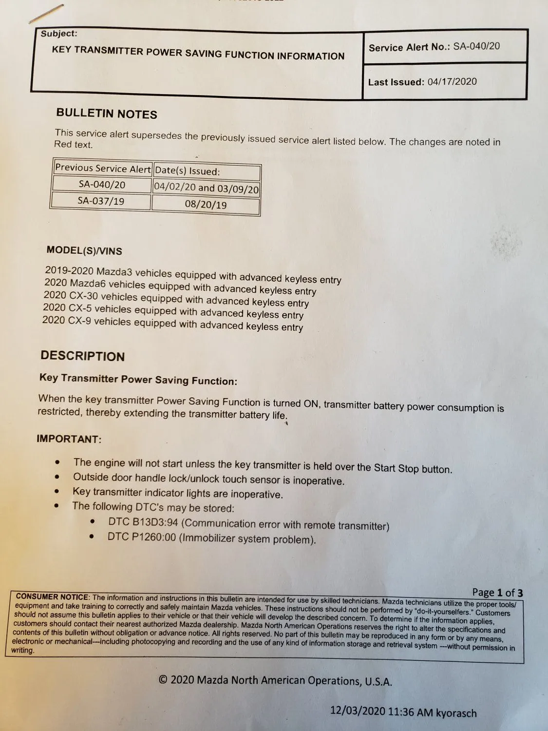

The stupid advanced key fob, with the buttons on the side, has a power saving mode that throws the car into stupid mode telling you key fob is out of range or whatever. Theres a way to turn off the power saving mode and like magic, the key fob has range again!
I went back to the dealer for this because I thought my fob wasn't working. What was weird, I had the car for over a week and suddenly it "stopped working" and I got the range error in the instrument cluster. Not sure what turned this mode on, but the dealership turned it off and everything was good again.
Honestly, I've found myself having to turn off the mode all the time now. Whether it be trying to lock the car from a distance and pushing the lock button one too many times or even it being in my pocket while at work and bumping against other keys or equipment on my work belt.
Mazda messed up with this one. I get it, if you have a spare key that you literally rarely use, okay, power saving mode works. But putting a mode so easy to activate that irritates customers, bad move Mazda.
