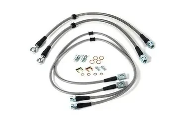

A common way to firm up brakes is to swap the brake hoses to each wheel with stainless steel braided lines. SS brake lines are less than $150/set.
I did this on my 2500 pick up. The brakes went from soft to very firm. A lot of the soft pedal are the brake hoses expanding under pressure. A quick look, I didn't find a supplier who sells SS lines for CX 5s.
We use SS braided brake lines on our race cars for reliability and firm brake pedal.
I might change to SS braided hoses later this year when we do a brake fluid flush.
Here is a link showing SS braided lines but don't fit my CX 5, only for reference. I have contacted this company and asked for a quote.
https://www.buybrakes.com/techna-fi...t-for-mazda-cx-5-front-and-rear-4-brake-lines
I bought my truck SS brake lines from Crown Performance. Easy guys to deal with and do what they say. I've contacted Crown as well.
https://www.crownperformance.com/stainless-steel-brake-line-kits/
