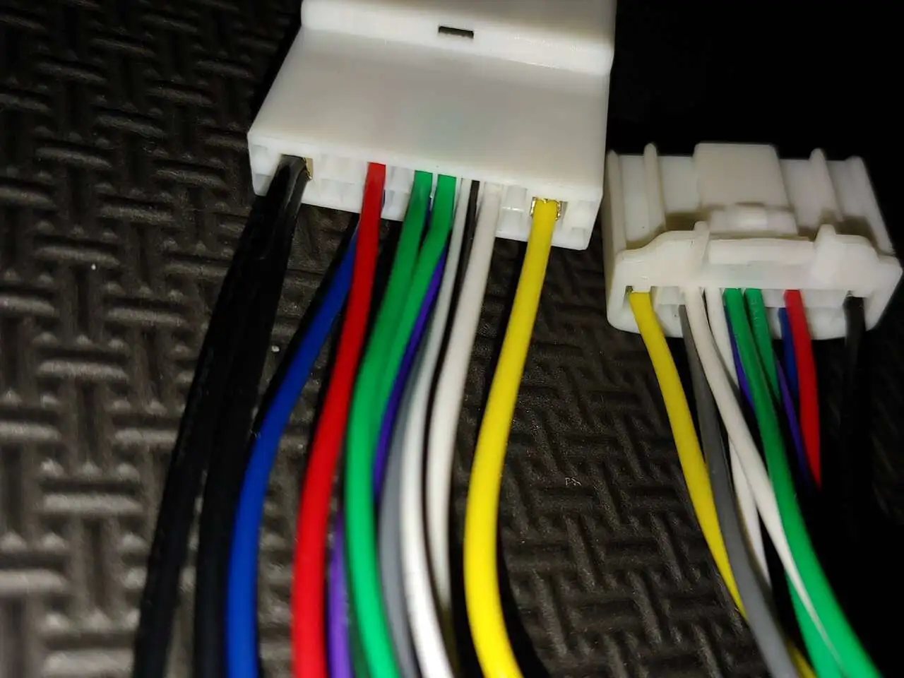

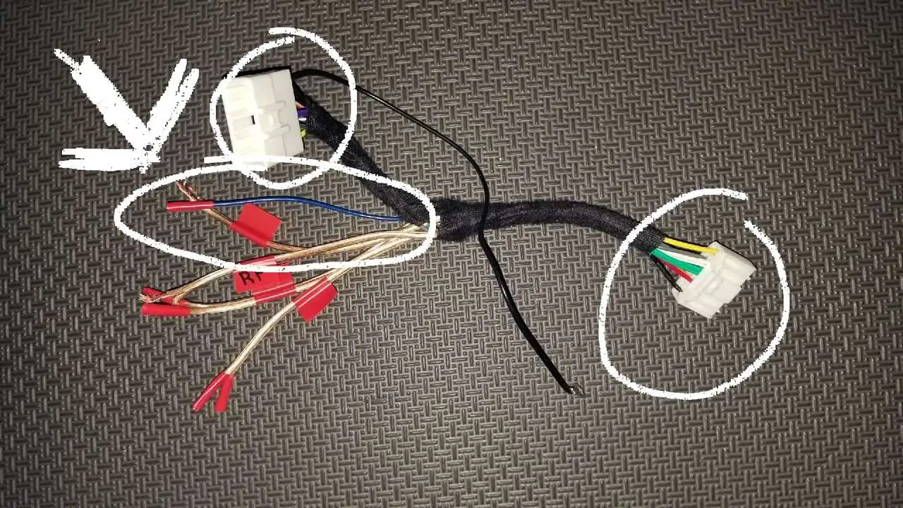

DIY 2017~2020 CX-5 Add an Amp Adapter
Blue wire shown is switch wire for amp - not required if you are running new wiring to your amps from fuse box etc - you can isolate the one shown as not required

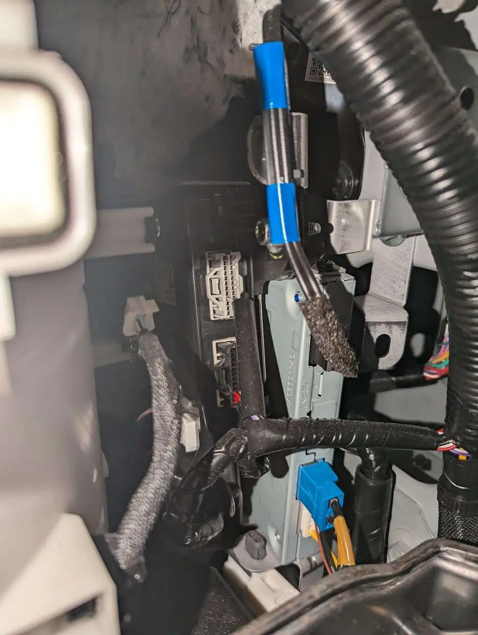

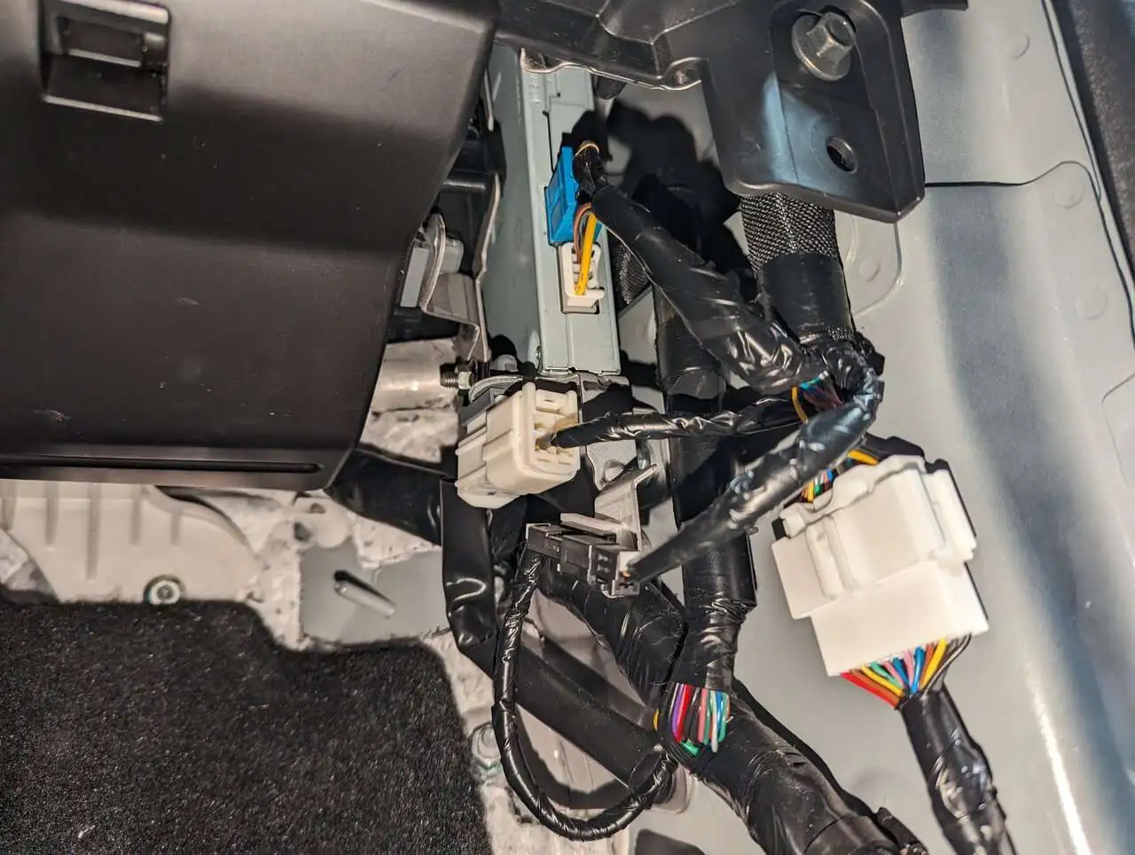

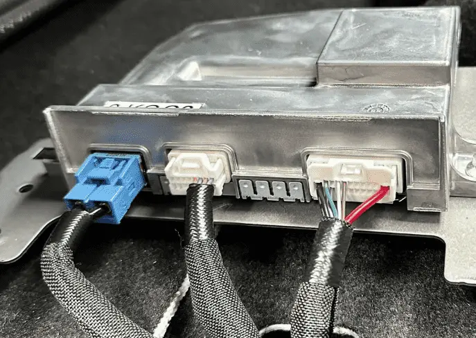

I made the Scosche adapter, got an amp, sub, and a nice amp wiring kit. Ran the power (pita). Got to the point to install the diy adapter and my TAU doesn't have the style connector on it. There is another connector in the vicinity (big white connection on the right side) that looks similar, but I wasn't interested in guessing.
I was imagining plugging directly into the TAU, not a remote plug.
After scouring the internet, coming up empty handed, I gave up.
Can anyone confirm or show photos of their install?

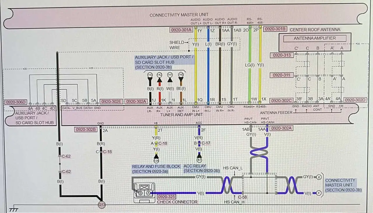

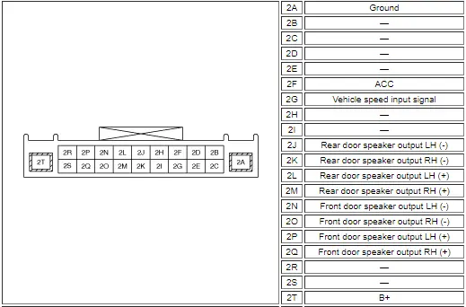

Also after following the t harness guide to a 'T' I think the "blue wire" is the speed sensing wire, and the red is the accessory wire for remote turn on. Can anyone confirm?

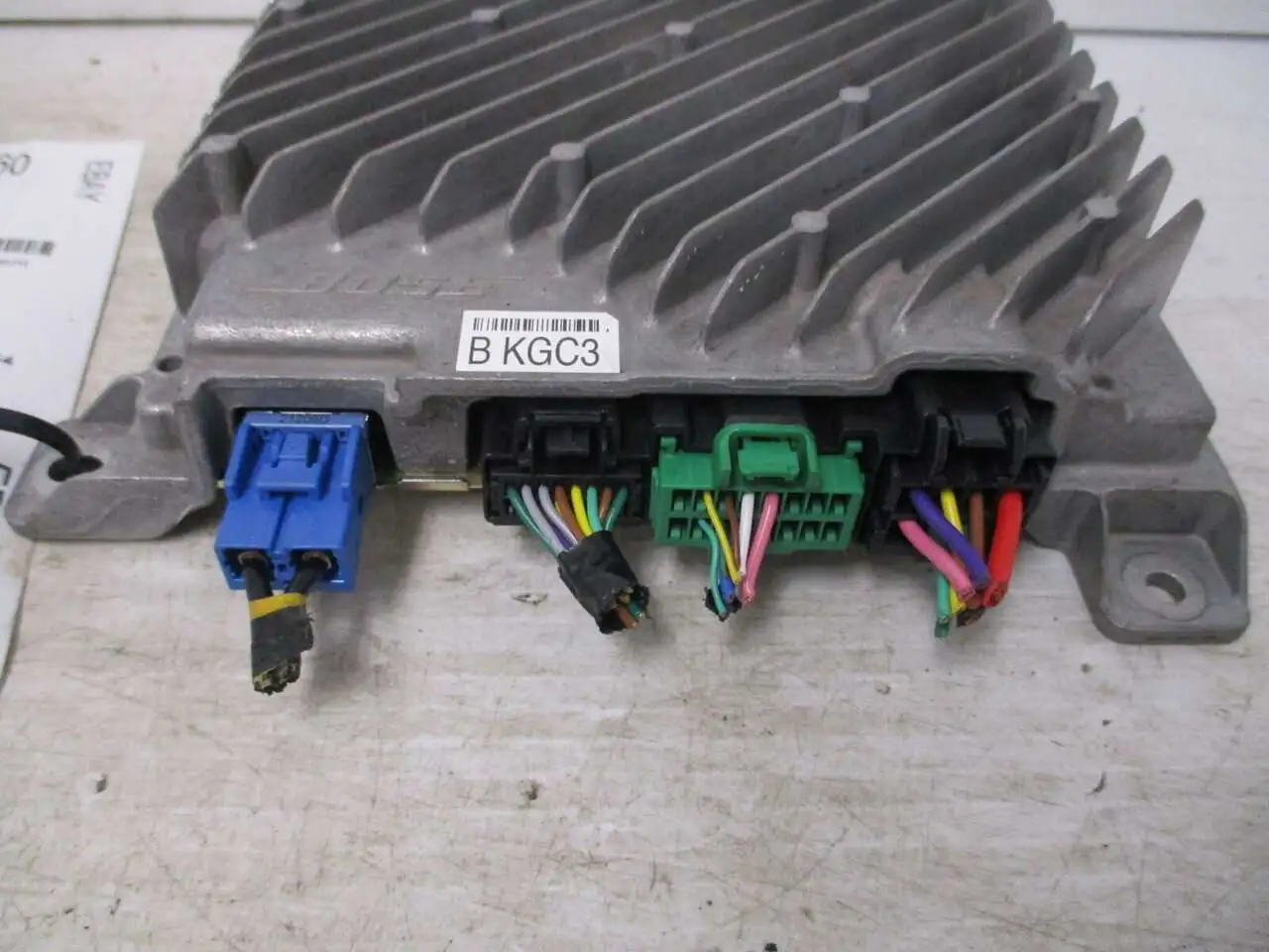

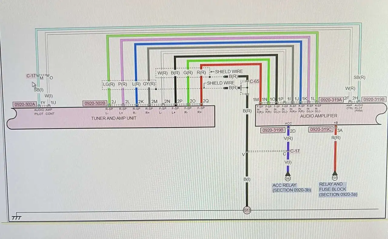

I may just be overthinking this.... I'm almost wondering if they switched to optical connection in 2021+ between the TAU and the Bose amp (blue connector in photos).
2020+ bose amp image from ebay:
2023 non-bose amp

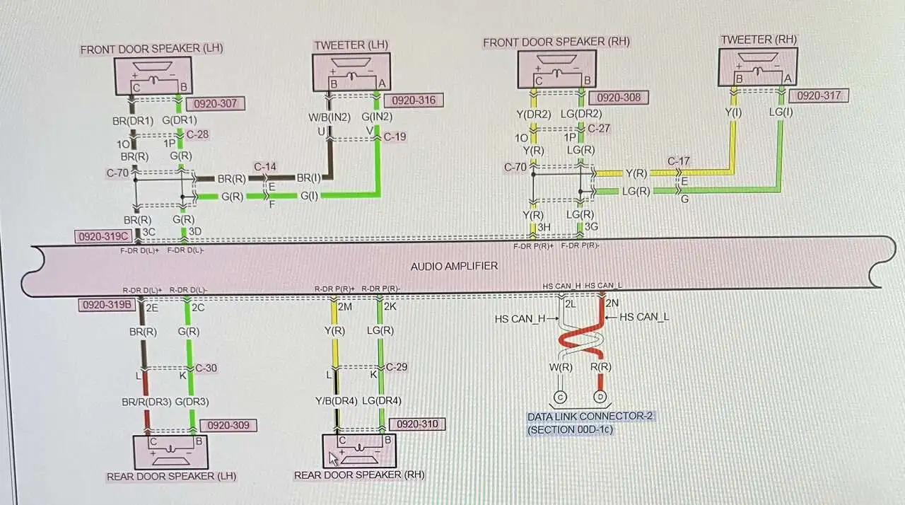

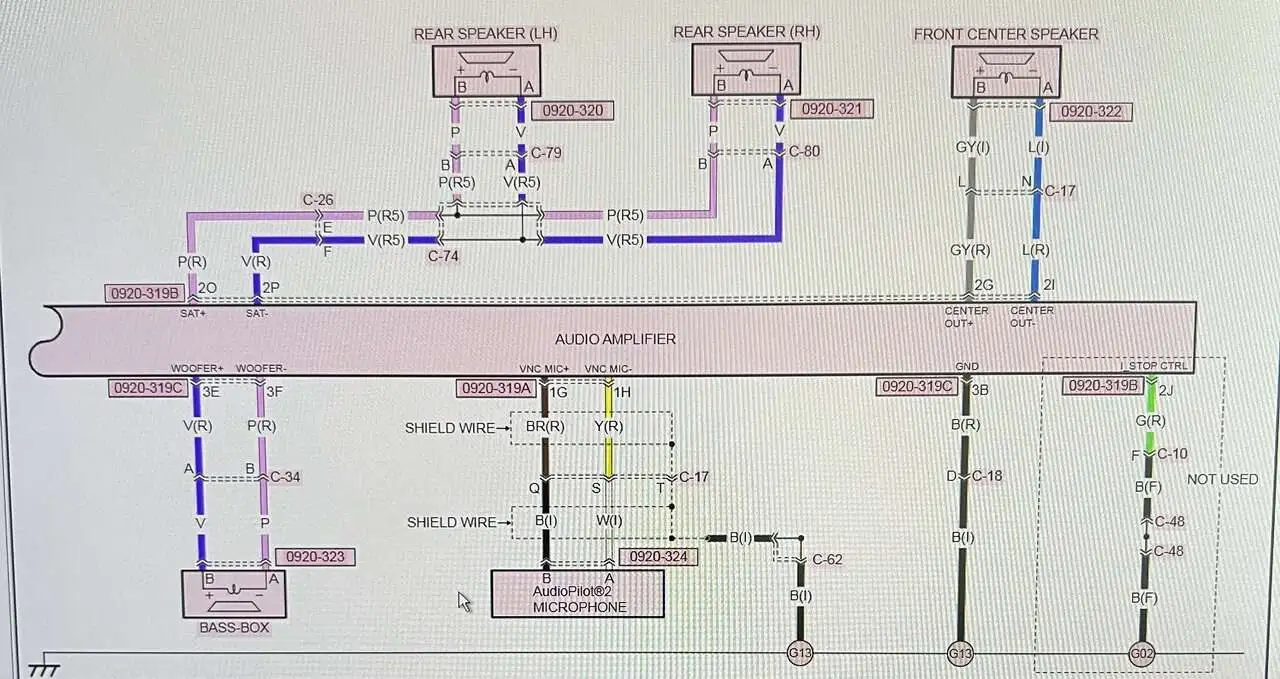

I gave up and tapped signal from the Bose sub speaker connections. It's working great, with plenty of bass down to around 20hz at any volume.
Did you split the signal into two channels or just one with a single sub and mono amp? Ive got a basshub from a previous vehicle, but it needs both left and right inputs. The BOSE only has a single input.
I tapped the 2 wires with wago's and a monster cable RCA cable then used an RCA Y adapter into the right and left high level input of my alpine amp. It works well, however I'd really like to get a kicker key loc to get a cleaner/more balance signal to the amp. The sub signal seems to have a high pass filter around 30hz. To me, the purpose of a sub is to get the low, low notes and I can tell they start to get quiet sub-30hz.
Today I reconnected the factory sub, so I can adjust the crossover of the aftermarket one a bit lower. Seems to help, so the midbass isn't as 'in your face'.
I tapped the 2 wires with wago's and a monster cable RCA cable then used an RCA Y adapter into the right and left high level input of my amp. It works, however I'd really like to get a kicker key loc to get a cleaner/more balance signal to the amp.
I was just going to roll with the high level inputs into the JBL unit.
Does anyone have a more up to date link for the connectors? When I google the part numbers I can only find stupidly expensive plugs.
It looks like this plug is used on 2007+ Nissan stereos so maybe something for them?
