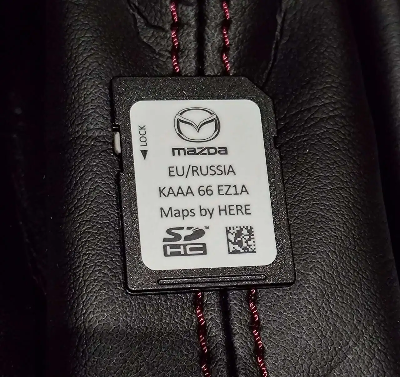

I had issues updating my SD card found in my 2023 CX-5 - KAAA 66 EZ1 EU/RUSSIA. And finally was able to do it using
MazdaMapUpdateGlobal downloaded from here:
Thanks to Ash8 for posting in another forum about the card numbers that are not working with Mazda toolbox:
KMV6 66 EZ1 USA/CANADA/MEXICO
DRVR 66 EZ1 USA/CANADA/MEXICO
KR9D 66 EZ1 USA/CANADA/MEXICO
KAAA 66 EZ1 EU&UK/RUSSIA
KS0G 66 EZ1 CYPRUS
BJGB 66 EZ1 EU&UK/CYPRUS
KS1A 66 EZ1 AUSTRALIA/NEW ZEALAND
