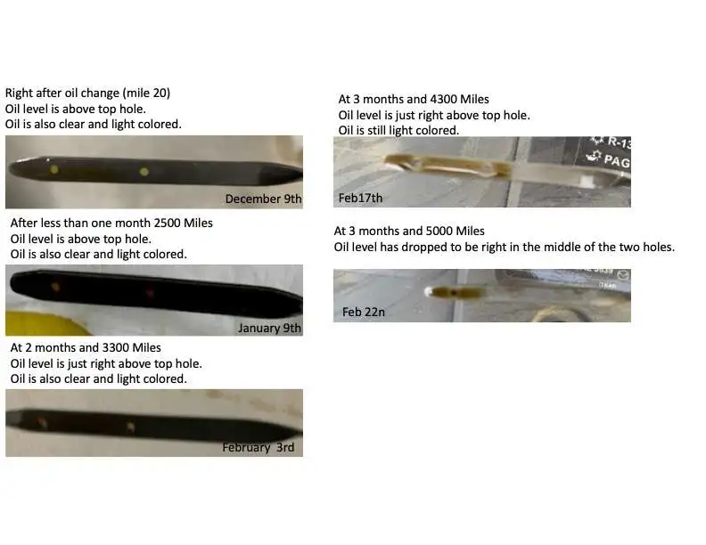

Like this? Been there and done that.
Like this? Been there and done that. ...
Yes, that's the type of checking and recordkeeping I'm talking about, but what you posted is really strange IMO. According to the dates on those pics, your vehicle travelled 4300 miles with virtually no oil loss, but then somehow lost around half a quart in just 700 miles and 5 days. Has that oil loss pattern been consistent for as long as you've been monitoring oil consumption on this vehicle? And does the other 2021 have a similar pattern of consuming oil?
This is something I have noticed with that CX-9 and the CX-5. The oil loss is not linear and is associated with long trips. It goes really fast after 4500 miles.
I can't come up with any logical reason to explain the oil consumption pattern that you've discovered - very puzzling indeed. It would be interesting if another 2021 turbo owner has done the same monitoring that you did, in order to see if their vehicle's consumption pattern is similar to your two.
