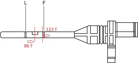

You guys were right, I checked the ATF while idling and it was low. The ATF was at around 25-30 C (77-86 F). I added 600ml and it came up to the middle of the 2 lines, so perfect. I don't think ATF expansion is that great that I need to check at 122F, and I'm guessing if I were to check at 122F it would be closer to the top line.
I also changed the rear diff and front transfer case, and they both took about 0.5L each. Not too complicated.
Update: I warmed up the transmission fluid to 51C / 123F and re-checked level (car idling, level surface) and it was just below the Full line. MS Paint artwork attached.
Summary: added 600ml to factory fluid to bring it up to full level. I did not drain and fill since car has 30K km / 18K miles.
