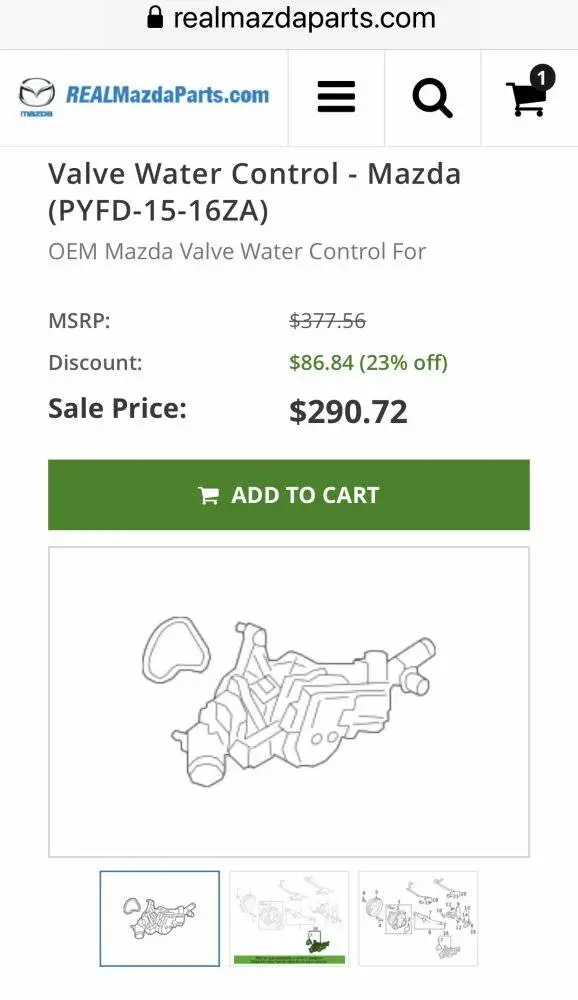

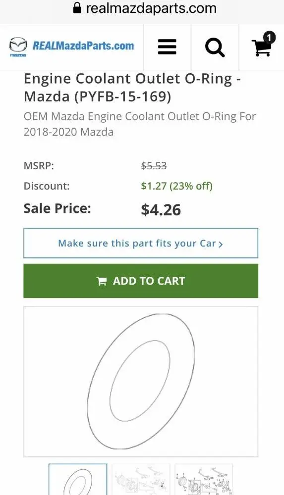

A couple minutes ago, I selected the 2 original parts and the 3 new ones for purchase from a Mazda online site. Naturally I didn't actually buy anything, but all of those parts appeared to be in stock at that site and ready to ship today. It wasn't the Mazda site that yrwei52 posted, but it wouldn't come as a surprise if that one has all of the parts in stock as well.
Not sure what's going on with your stealership, but perhaps they're simply not putting enough effort into this for you.
I did call a few places last week and all said not available. Even a few of the sites that showed the parts as being in stock, when called admitted to not having them. that's not to say one doesn't SOMEWHERE but I've got a ton of hours in this mess with ZERO support so far. I am hoping for a change tomorrow but not counting on it :(
Ok, again I didn't actually put the order in, so what you've (sadly) discovered could also be true for the site I was using as well. If you haven't already tried them, it's https://www.jimellismazdaparts.com/
