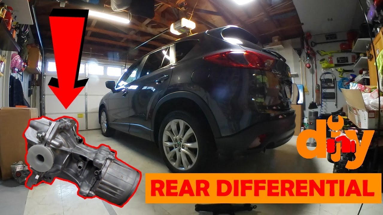

Just in case you consider to DIY it, then this video can be helpful:
Thank you. I did see that, but I can't tell if the 2017 model has the same notch inside the knuckle to allow the CV boot clamp to pass through.
