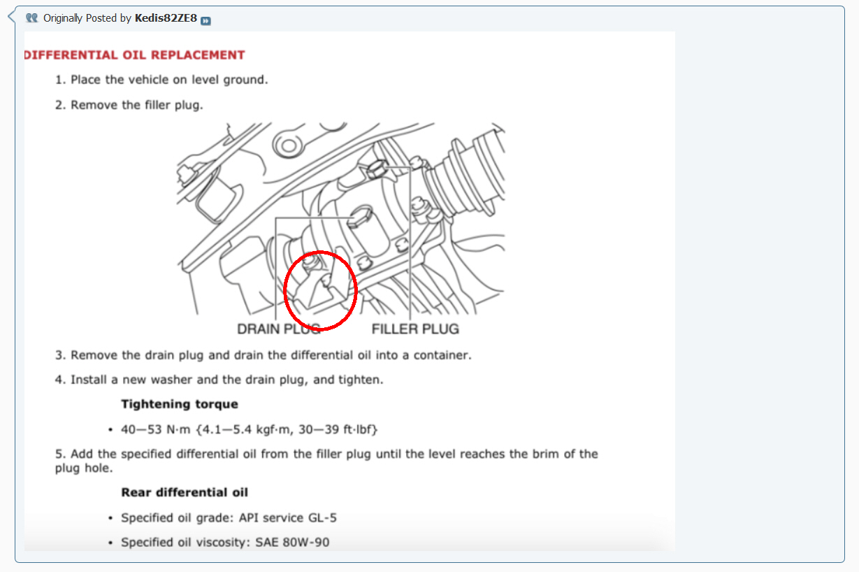

for rear differential, is it located between the rear wheel axle, look for that funny odd looking U-shape extension that's meant to be a jack point (red oval) to help orient yourself, the fill and drain plugs are facing the open U side of the funny odd looking extension (see picture below) make sure to loosen fill plug first before loosening drain plug. Hopes this helps, I haven't done it yet but I'll post a how to with pictures when I do it, good luck.

Rear differential is located between two rear wheels as shown in the first graph on the right side. You'll see a drive shaft from front transfer case to rear differential. You remove fill plug first measuring the oil level before you remove drain plug. And you need a little more than 1 quart to change both front transfer case and rear differential gear lubricant. Make sure safety first if you want to rise your CX-5 for gear lub change. Finally, make sure to read two threads I listed before you do gear lub change. There's a long video made by CX5-SO in his thread showing the entire process in post #21, but unfortunately it's no longer available. Good luck.
