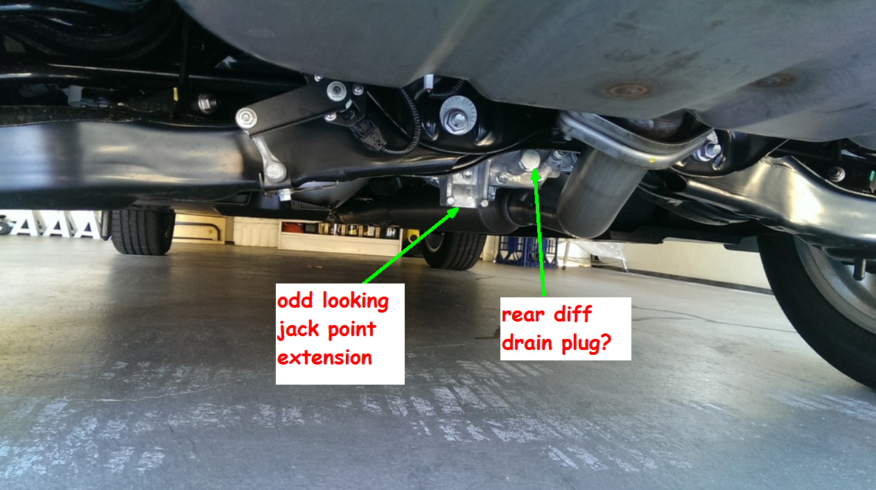

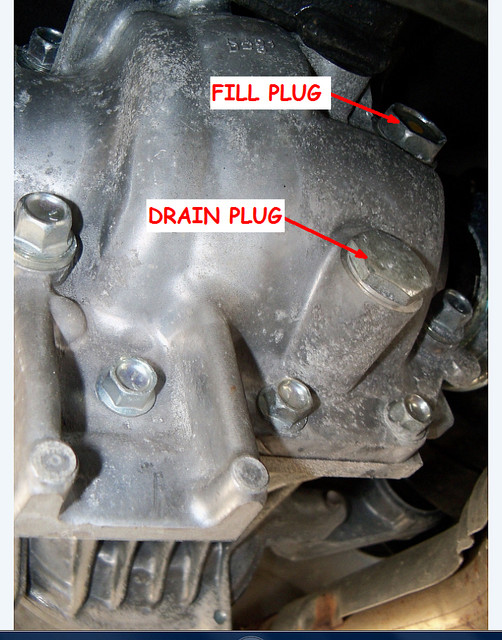

Actually, can someone who has done the rear diff oil change confirm tomcat's photo, is that indeed the drain plug in his picture ? also is there enough ground clearance to do this without ramps ? I really don't like have all four wheels up in the air, scares the hell out of me.....
confirmed this morning, no need to lift rear wheels to service the rear differential,
there is enough ground clearance to get in there and service the rear differential,
as another member said, the fill plug space is tight, it'll be easier to use an open end wrench to remove it.
make sure to loosen the fill plug first before releasing the drain plug
All good advices but I strongly recommend getting "shallow" sockets like CX5-SO suggested in this thread: Rear Diff and Transfer Case Fluid Change: tools parts and links. Never have any good experience of using open end wrench which is very easy to strip the bolt head, and you can't use torque wrench with it unless it's crowfoot wrench. I only use flare nut open end wrench for brake lines which is not feasible to use a socket or box end wrench.
I believe the CX-5 still needs to get lifted to do the front transfer case. But it's good to know we can check the gear lubricant level in rear differential from factory without lifting the vehicle.
