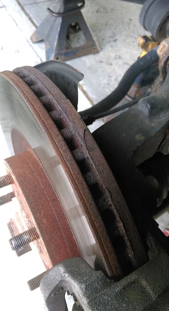

Centric rotors from Amazon screeching/warped/vibrating after only 6months...... not recommended, photo below:
The thing is the only time it makes that noise is in reverse. I have never owned a vehicle that was like the 9. Anyone out there have any suggestions on how to get rid of that noise.
