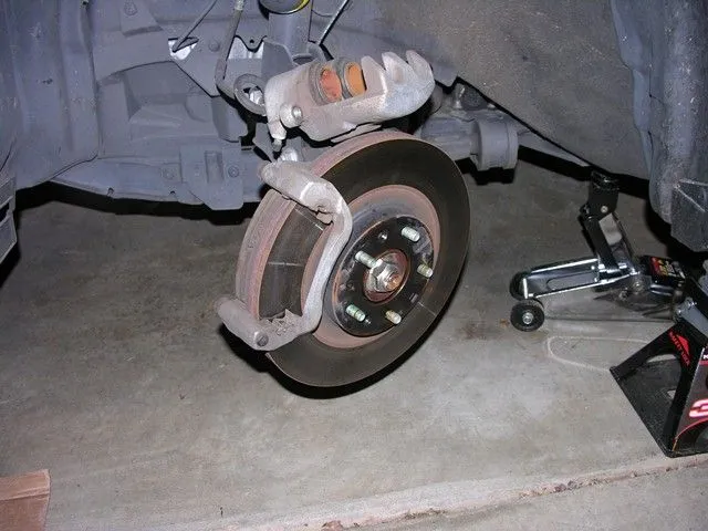

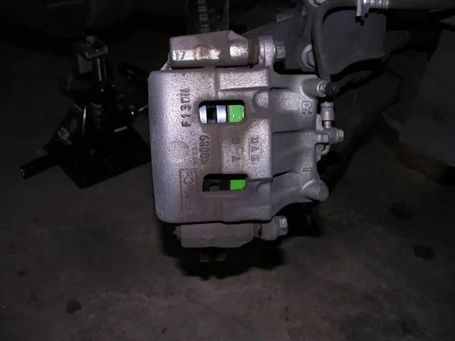

Completed the front rotor change over, here are some pics

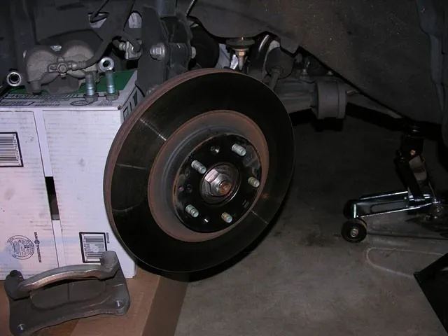

A couple more

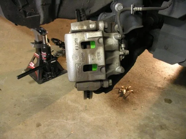

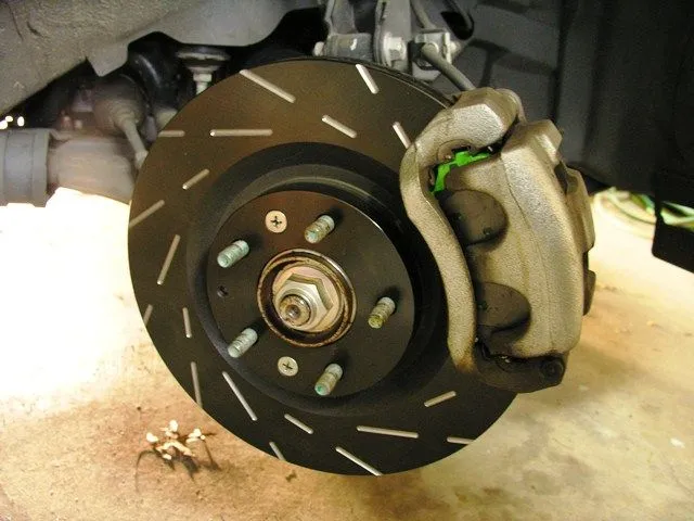

and a few more
