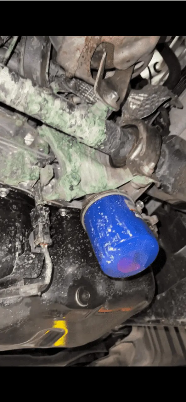

Just got my 2016 CX9 68k miles sent in to the dealership last week and quote came back at $7800 to replace the entire engine. They are writing a preauthorization to Mazda to see what's manufacturer is able to help, finger crossed , hope they cover in full with min. Deductible

Sorry to hear :( How does the oil on the dipstick look?
