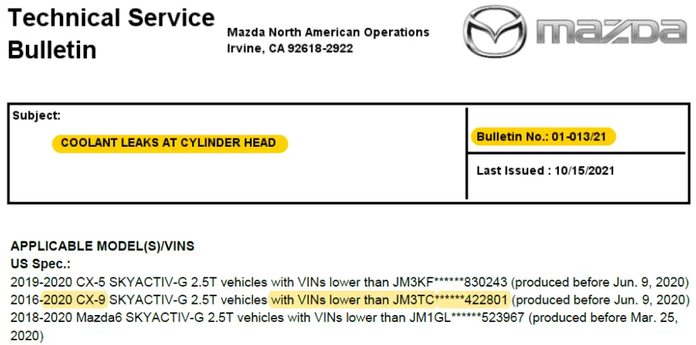

this was from Mada's TSB, need to go by your VIN#
APPLICABLE MODEL(S)/VINS US Spec.:
2019-2020 CX-5 SKYACTIV-G 2.5T vehicles with VINs lower than JM3KF******830243 (produced before Jun. 9, 2020)
2016-2020 CX-9 SKYACTIV-G 2.5T vehicles with VINs lower than JM3TC******422801 (produced before Jun. 9, 2020)
2018-2020 Mazda6 SKYACTIV-G 2.5T vehicles with VINs lower than JM1GL******523967 (produced before Mar. 25, 2020)
Mexico Spec.: 2019-2020 Mazda6 SKYACTIV-G 2.5T vehicles with VINs lower than JM1GL******523672 (produced before Mar. 21, 2020) DESCRIPTIO
