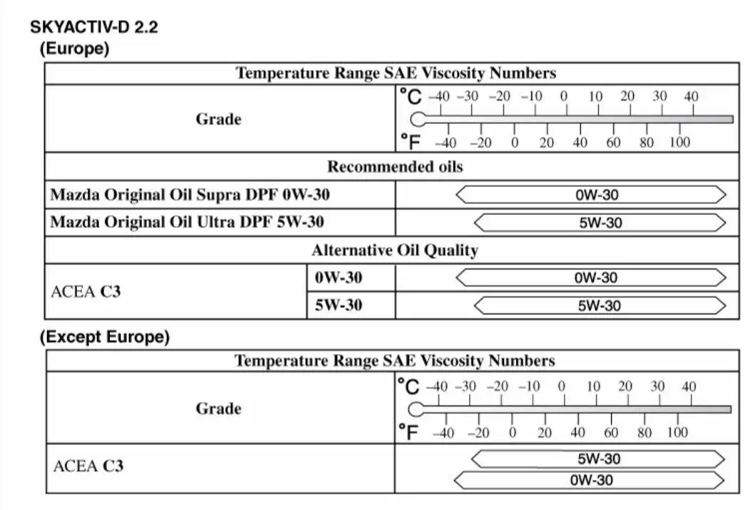

Running 0W-30 or 5W-30 actually is also recommended for SkyActiv-G 2.5L by Mazda worldwide other than North America.
