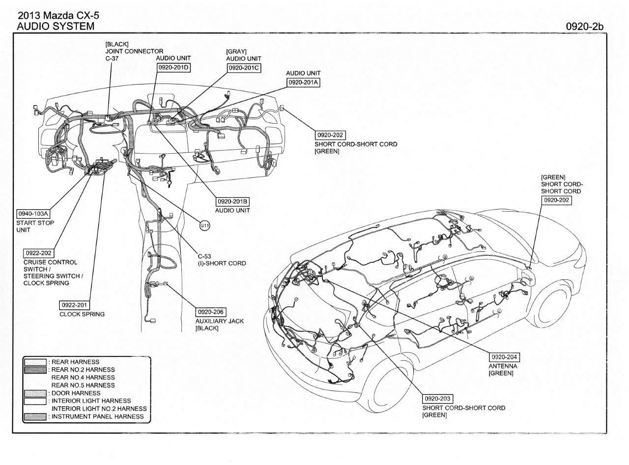

I think hte connectors are there for most things. I aske dth edealer for the wiring diagram for the Bose System. The Info I received in returen is simply labeled "Audio System" One of the pages show the wire runs throughout the car. It looks like a common harness. See attached.
