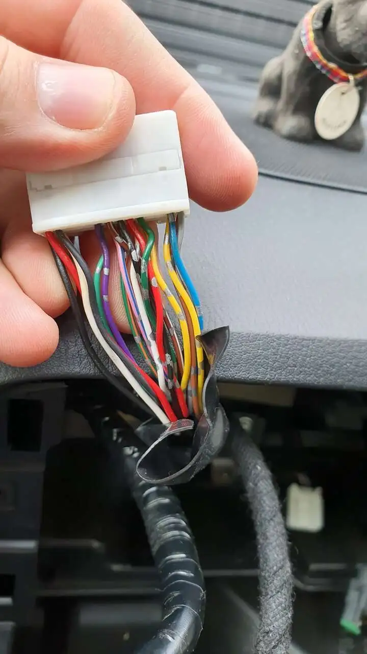

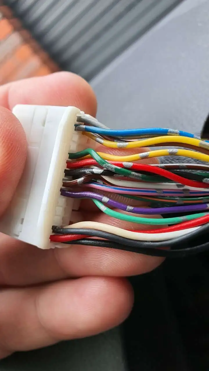

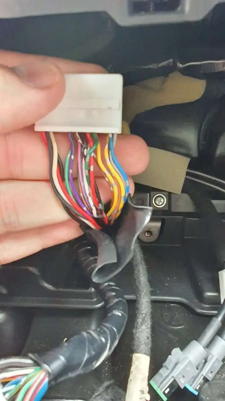

Hello folks,
I have Mazda cx5 2015. I am trying to install the line output converter for amp installation, I am very confused with wiring diagram if anyone could help me locating speakers wires.
Thanks
