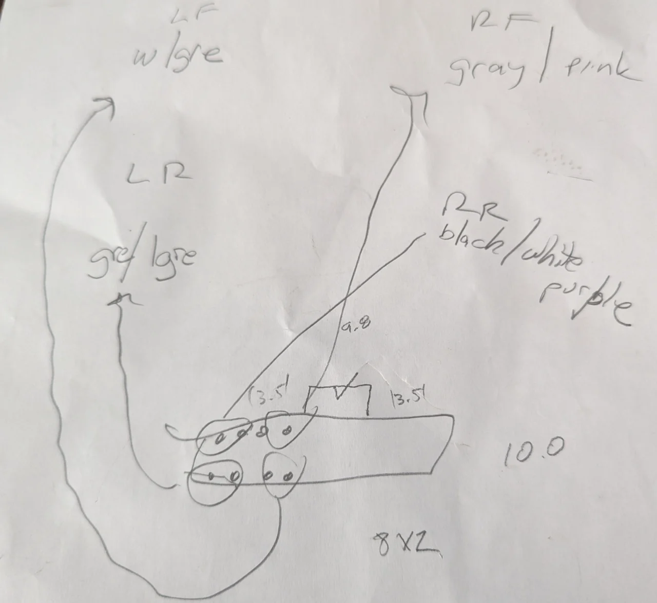

Not sure if the 2018 is the same as my 2021, but this is what I did with the amp that's under the passenger seat:
Don't mess with the 28 pin connector. The one you want is the white connector next to it with 8 wires coming out of it...
