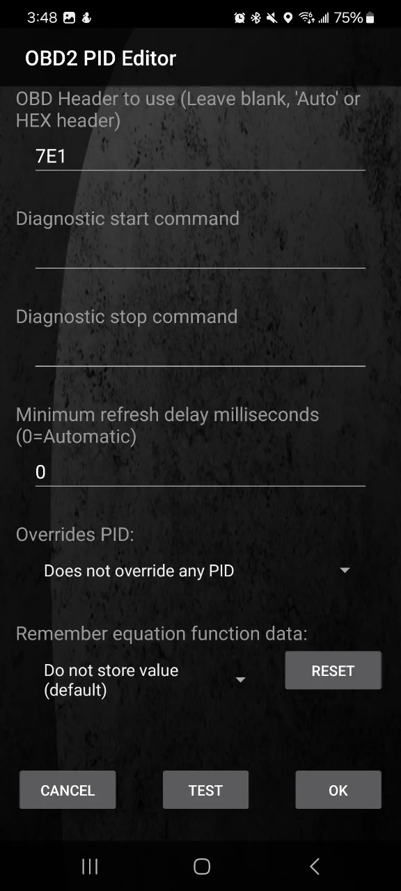

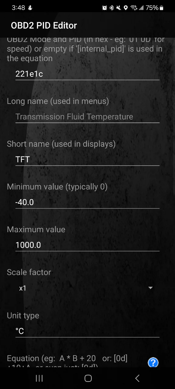

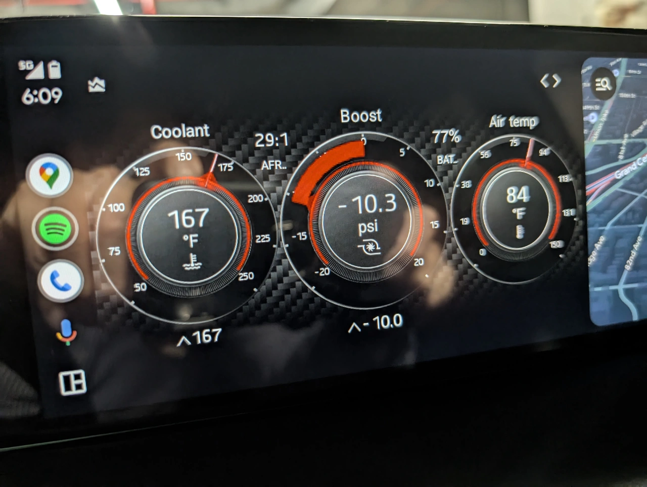

Here is a list of some common PIDs specific to the Skyactiv cars. Some of them I've collected over the years, some I've sniffed out on the CanBus. Depending on the specific car some will work and some will not. There are a few duplicate names but the formulas are different. For example "Coupling duty cycle" is the AWD solenoid command and will only read for the older cars like the CX-5/9/6 and rare 3rd gen 3 AWD. The "7th gen" newer cars like my 3 turbo it will not work for because Mazda put the control inside the PCM and changed the address. Boost Temp and Charge Air Cooler Temperature may be reversed, they are correct for the 7th gen cars. If you are monitoring those and you see something like 250+f degrees on Charge Air Cooler Temperature and 100 or so on Boost Temp then your car is reversed and you can rename the PID.
The PID KCS is for Knock Learning Control and is helpful to watch if you want to see if your car is removing or adding base timing based on Knock Retard. A positive number here will indicate your car is adding timing above base maps, a negative amount means the car is removing timing. This value will usually reset to zero after getting fuel and then start building.

Now we can have a lot more PIDs on our monitor.

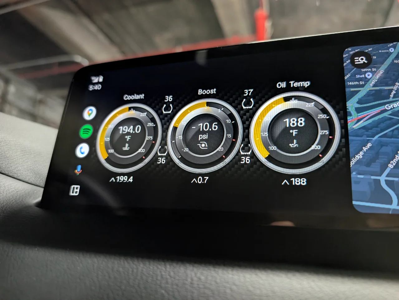

For those who complain no individual tire pressure display on infotainment screen, here are Tire temp/pressure PIDs to add to "custom PIDs in Torque Pro App. :)
Tire 1 Pressure:
PID: 222a05 unit: psi Max/Min: 50/0 Equation: ((A*1373)/1000)*0.145037738 Header: 720
For Tire 2/3/4 Pressures substitute 222a05 with 222a06/222a07/222a08

Seems the tire pressures are showing up. (y)
Now to figure out which tire numbers are associated with.

I'll give that a go when I get access to my friend's air tools in his garage. But at least I can see actual real PSI numbers.
As for rotating, I'll rearrange each tire as needed on another dashboard once the configuration is known. I'll definitely report back when this is done.
Haven't tried to figure out which tire is which yet.
But at least I can see all 4 tire pressures.
