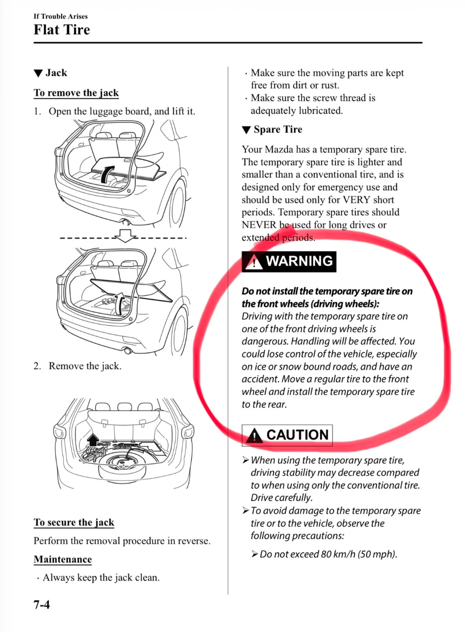

Since we are talking about this subject… isn’t this a hoot?
Mazda expects us to play musical wheels on the side of the road.
Mazda expects us to play musical wheels on the side of the road.View attachment 383245
They don't expect you. They suggest that you do. There is a difference.
While the recommendation is sound, in the event of a front flat, Id rather just put it on the front if I'm on the side of a busy road with hand tools.
Well you aren't supposed to use the spare on a drive wheel, despite many not knowing that. Also, it won't even fit on the turbo front brakes, so you must use it on the rear. There is no other way.
I was more concerned with how the smaller diameter spare on the front might affect the inner workings of the front transaxle, rather than vehicle handling. But if the dang spare won’t even fit on the front, the point is moot. Mazda dances around that tidbit of information in the owners manual. Thanks for the info.
