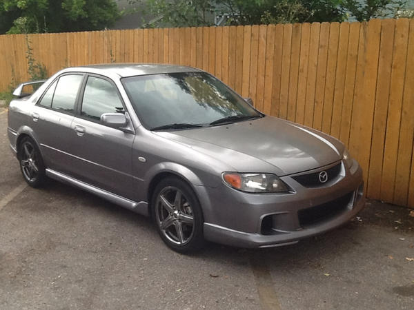

About 7 weeks ago I bought a 2003.5 MSP. When I went to look at it initially, it wasn't hard to see the car needed work. The body had some dings and small dents, but was mostly intact. The motor didn't have the cover on it, and the strut brace was missing. You could definitely see someone has been in that engine. I'm guessing that the car previously had some mods done to it, but the stock stuff was put back on before they traded it in. The previous owner and/or owners drove it pretty hard. It had 140k miles.

And you're definitely right about your car being modded in the past, even from the one picture you posted I can see that the front bumper has been on/off a bunch of times as the tab by the headlight is broken and the bumper lip is sticking out. You should look into getting a set of brackets from AAC to fix that, they're about $65 but well worth it.. NOTHING else fixes the bumper sag like his kit. The OEM headlight clips are about $8 a piece but they won't do the job, so just spend the money and do the job right :)

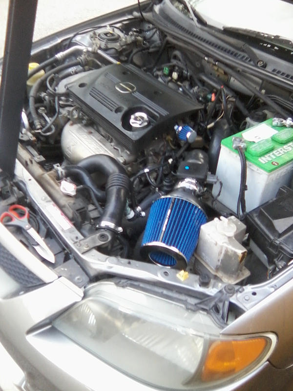

Thanks for the responses! Like you said KrayzieFox, I knew that in order to isolate the vacuum leak, I needed to eliminate as many possibilities as I could at first. So I replaced all my vacuum lines. I was able to find the vacuum line sizes from a post in this forum that dates back a few years. Unfortunately, it didn't fix the problem. Also I'd like to add; just like anyone who wanted a little more breathability and power, I got rid of the stock air box and put in an Auto Zone el cheapo special air filter.
Keep in mind, at this time I didn't understand the full scope of the problem, or the engineering flaws that plague every MSP owner, so originally my idea was to keep the piping and everything stock. But as I crawled deeper into the rabbit hole, I realized some things would need to be changed around.
So after I got all the new vacuum lines in, I began to poke around the intercooler piping to see if my leak was coming from there. Upon closer inspection, I realized there was a plethora of small cracks, holes, and all the stuff that comes with any 11 year old turbocharged vehicle with plastic OEM pipes. The biggest problem being on my hot pipe. The pipe that connects the BPV to the hot pipe looks like it was broken before and someone used JB Weld to fix. Well you can probably imagine how that was working. I looked into getting an OEM replacement hot pipe, but it was over $300! So it was evident that the cheaper (and ideal) thing to do was replace all OEM pipes with hardpipes. In the meantime, I had some plumbing fixtures laying around, so I MacGyver'd a temporary fix for the leak. I used epoxy to seal it, and it did the job pretty well. But it still didn't fix the problem.
Also as a side note; like you said KrayzieFox, that bumper is sagging a bit. Upon further investigation, I'm pretty sure one of the previous owners had a FMIC in there at one time. But when they switched it back to OEM stuff, they ran some vacuum lines wrong, and of course it caused an issue that I would run into later.

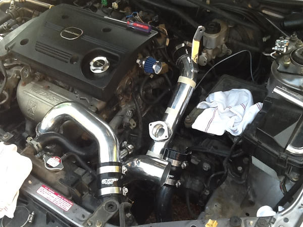

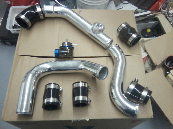

So now that I knew I needed hardpipes, I needed to find some. As you all know, there really isn't much to choose from. All in all, I found 4 to choose from. Speed Circuit, Street Unit, Weapon R, and Turbohoses. I almost bought the Speed Circuit ones, but luckily, when I called, the guy told me they wouldn't work with the stock setup. Then there was Turbohoses. It looked like a great kit, but every kit was made to order, and honestly I didn't want to wait 3-4 weeks to get it. The Weapon R hardpipes were the cheapest of the 4, but it seemed like the cold pipe had a lot of bends in it...too many in fact. So Street Unit it was.

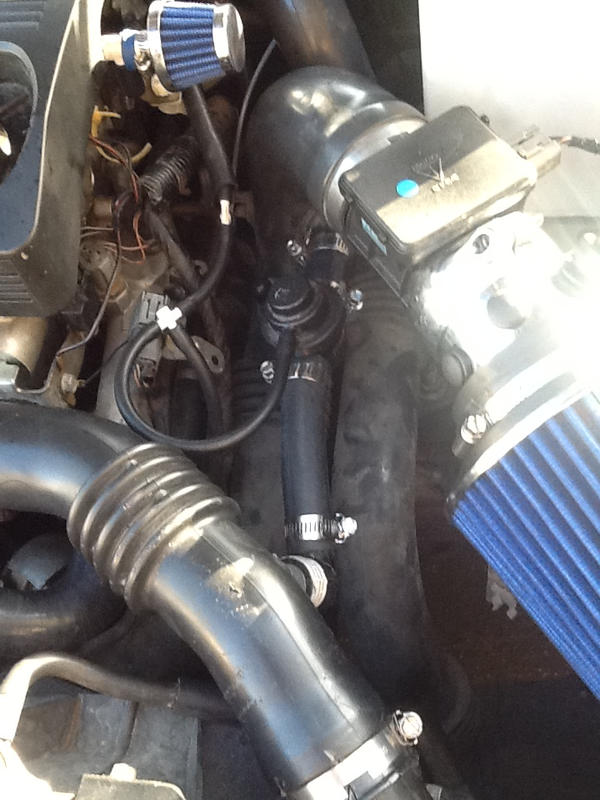

Lemme rewind for a sec. In the process of researching hardpipes and such, I was considering relocating my MAF. I looked into getting the Forge BPV, but the more I played with my car, the more I realized that the BPV was an engineering flaw that was more problems than it was worth. When working nominally, the BPV works fine, but having the MAF at the front of the intake system leaves a lot of margin for error. Of course this is subjective, and a lot of people would argue that the BPV is the best way to go. Sure its great to prevent compressor surge, but I feel it's an engineering flaw. Here's my theory...
The MAF reads the amount of air coming in, and subsequently adds gas to reach the proper A/F ratio. As we all know, a VTA BOV cant work with a MAF in front of it because gas will be put in for air that never reaches the TB. Air that goes into the intake has to travel quite a distance before it gets to the TB, and there is no way to meter how much air is going into the engine once it gets past the MAF. So when the BPV is activated, it temporarily creates an "air loop". Although this air doesn't leave the system once it gets past the MAF, it has a delayed entry into the TB. In Sound Engineering we call this "Input Latency" We all know that MSPs run rich by default. In my opinion, this is why.

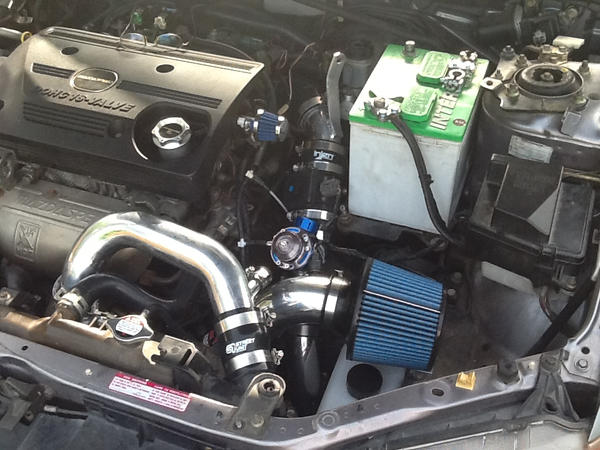

So all that being said, I decided to relocate my MAF. I had Street Unit weld a Greddy flange onto the cold pipe. I decided on the Greddy FV. I know it's new technology, and there weren't a lot of reviews on the FV, but I know Greddy is a great company so I went ahead and ordered one. The Street Unit guys are champions and had my pipes and BOV to me in about a week. All together the pipes and BOV cost me about $750.
So naturally, I was going to need a CAI. The only 2 that really peaked my interest were the Injen CAI, and the Weapon R. I considered getting one from Turbohoses, but it was pretty expensive. And I was beginning to rack up a lot of unforeseen expenses. But little did I know, this was only the beginning. So anyways, I decided on the Injen. I also decided to run it as a SRI instead of a CAI. Theres a lot of rain in Texas and I didn't want to take the chance of sucking water into my intake. Plus SRI's = quicker spool up. As you all know, Injen products are damn expensive, and this one set me back about $300.

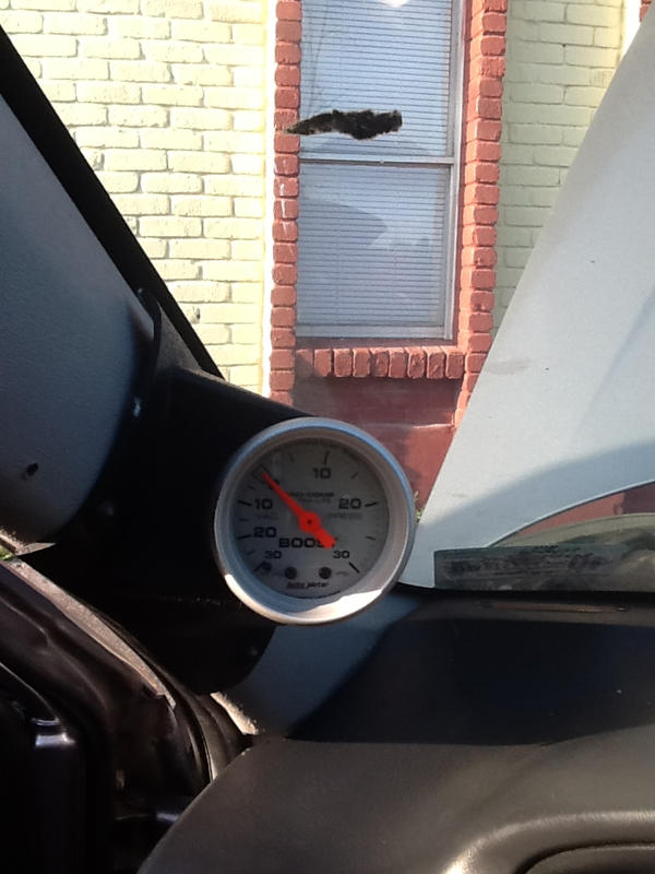

Of course with all the new piping and stuff, I was going to need a proper boost gauge, so I got a trusty autometer for about $60.
Since I was relocating my MAF, I was going to have to do some custom fab on my hardpipes. I feel like the BOV flange was welded a bit to high up on the cold pipe. In retrospect, I should have requested it was welded lower. But I still had enough room for the MAF (barely) so I moved ahead. I dry fitted everything and put tape on the pipes to mark where to cut. I couldn't find anyplace that did affordable bead rolling, so again I went the MacGyver route using a crimper. Taking my time, it came out well and everything went together without a hitch.
So I get it all together and take a deep breath...moment of truth...and start the car. It fires right up. Usually the car doesn't idle rough at first, so the real test was yet to come. I take it out of the parking lot onto the road and open it up. The turbo was definitely generating sufficient boost. In fact, the acceleration was amazing! But right about 4500 rpms, I started getting fuel cut. My boost gauge was reading right about 6, so I couldn't understand why it was getting fuel cut. わからない!!!Although I didn't realize it at the time, my vacuum wasn't reading more than 5 hg, and it should be closer to 20. I still had a vacuum leak...but where?! I then began researching the tallest accessible building in Austin so I could throw myself off of it. But I chickened out and decided to take another look at my vacuum system. My hoses and hardpipes were good. No cracks in my intercooler. I worked my way down the vacuum line until I got to the BOV. Little did I realize at the time, but the vacuum line T'd again and went down to my wastegate actuator (as you know, that's not good...WGA diaphragms are only intended for boost, not vacuum) I pulled the line off the T and gave it a blow. Blowing into a WGA should be like blowing into a brick wall. But this was more like blowing through a straw. So I finally found the vacuum leak. ヤッタ!Unfortunately my WGA was toast. The vacuum leak gave me false boost and vacuum readings, and worst of all, my wastegate wasn't opening. So the fuel cut was from overboosting. Luckily I didn't blow up my engine.

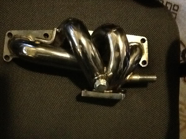

On the back end of my search, I found a mani on Ebay for $200. It looked like it would fit, but I couldn't find any reviews on it, or even anyone mentioning it anywhere. And the thing that worried me more than anything, was the brand name was ilovetacotaco. I called the place and talked to a girl at customer service. I asked her if it was a stock replacement, or a turbo kit mani. Her answer was just read from the product description that I just happened to be looking at while talking to her. This was discouraging to say the least. But I was in desperation mode, so I took a chance and ordered the mani. When it came in, I held it up to the OEM mani and it looked like it would fit. Since then, I posted something about it in the Pope mani thread, and found out its a Chinese mani, and it will work (for a while).

i would of just gotten ebay universal hardpipes and cut as needed that would of been cheaper and they are still good since they are just hardpipes, as far as a good exhaust manifold have you tried popeperformance? Last that I heard of, he was making one.
