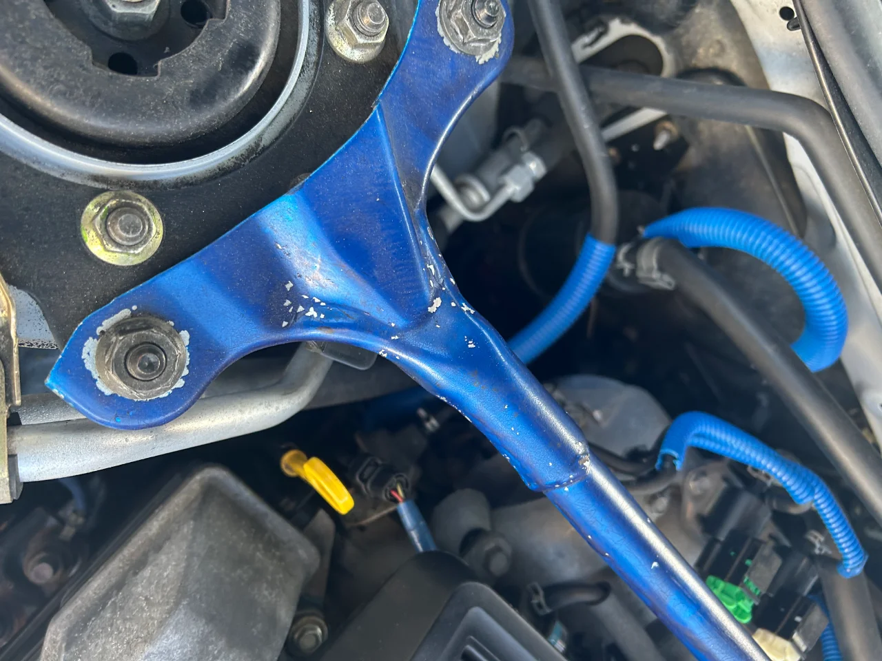

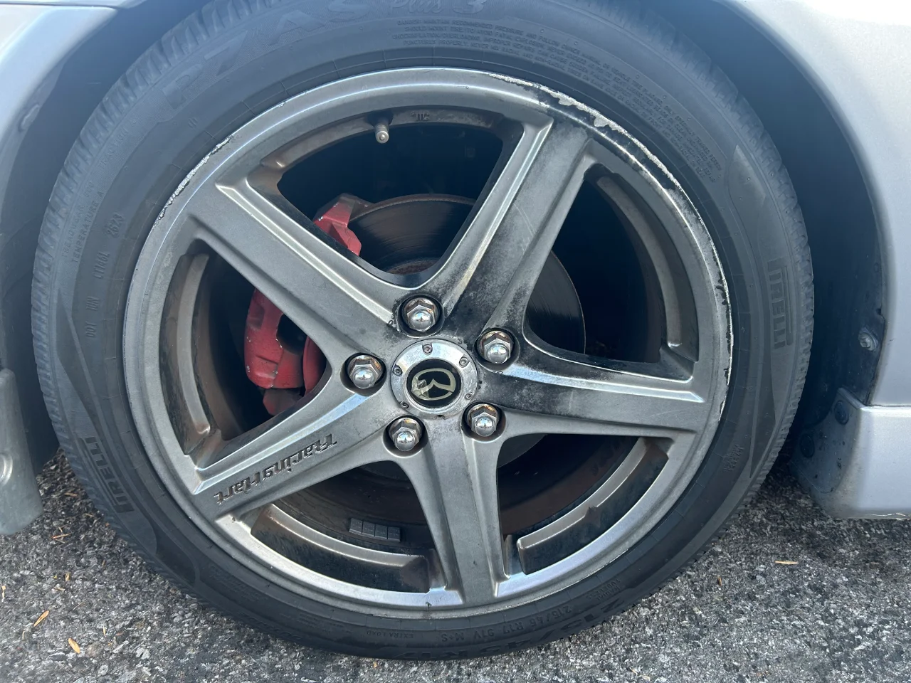

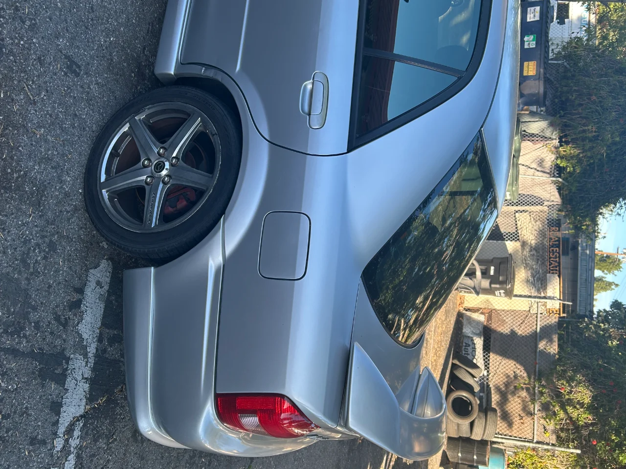

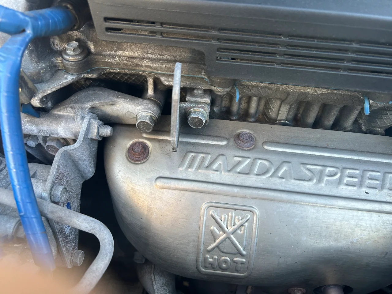

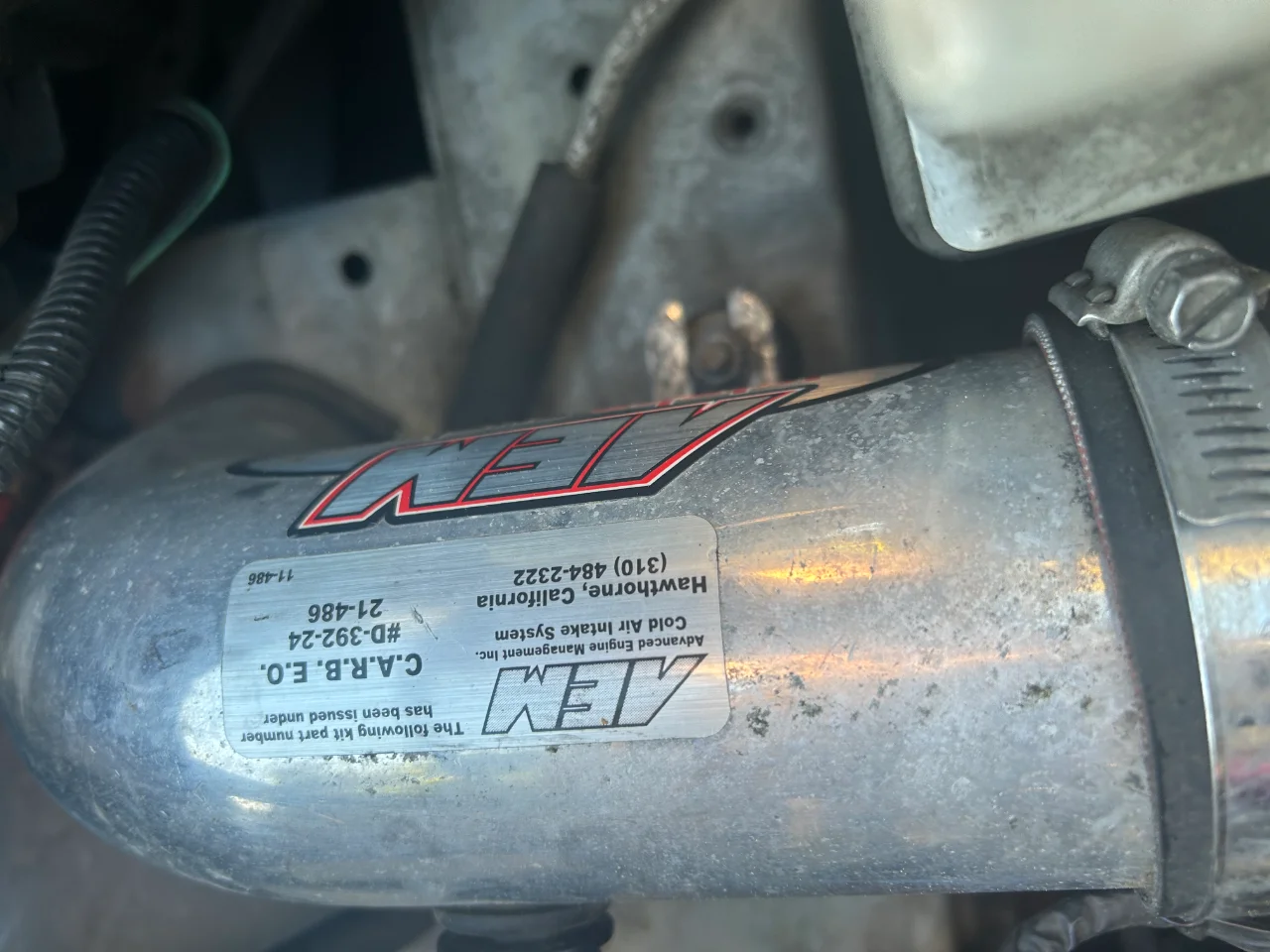

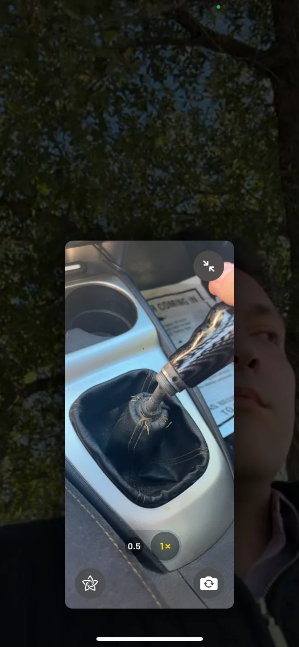

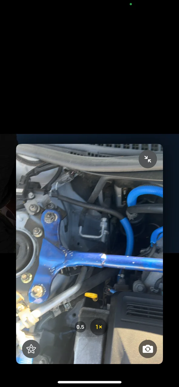

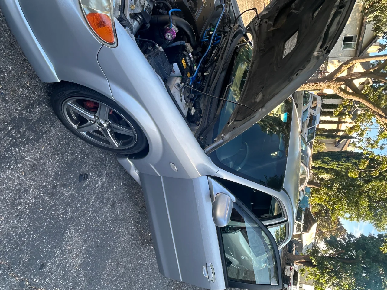

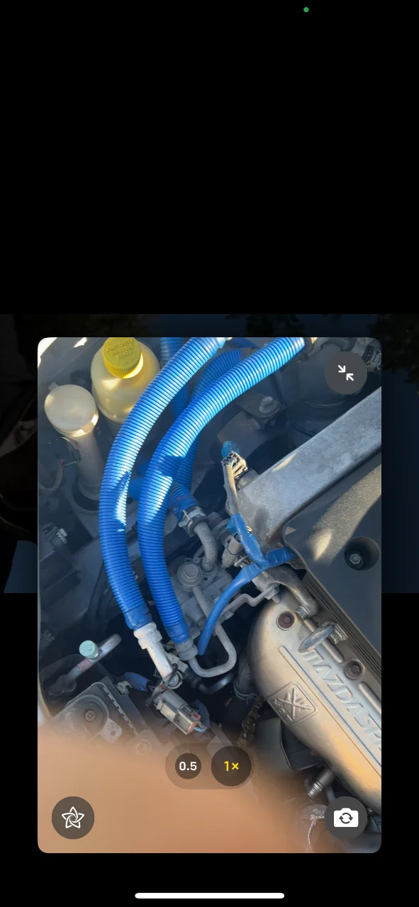

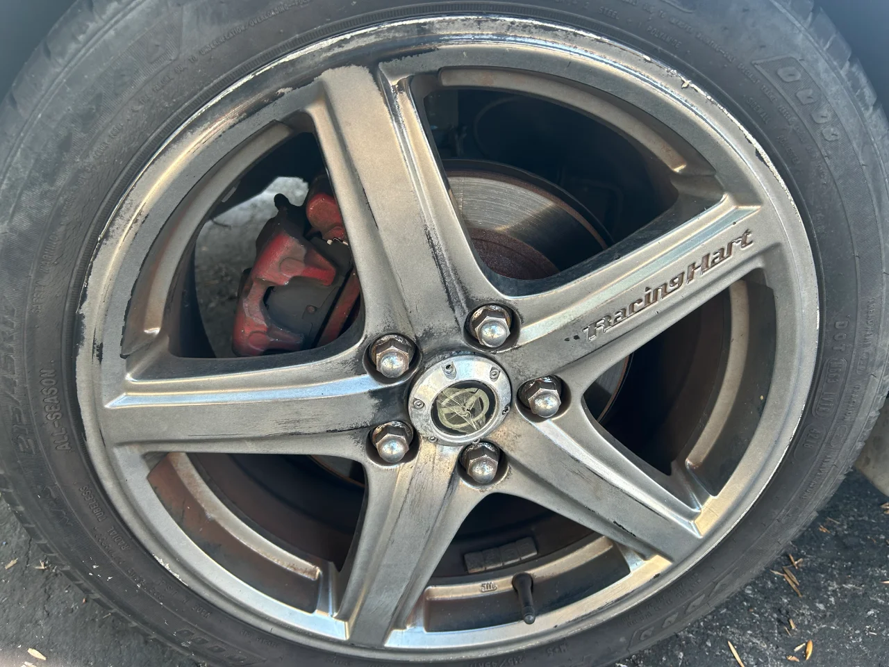

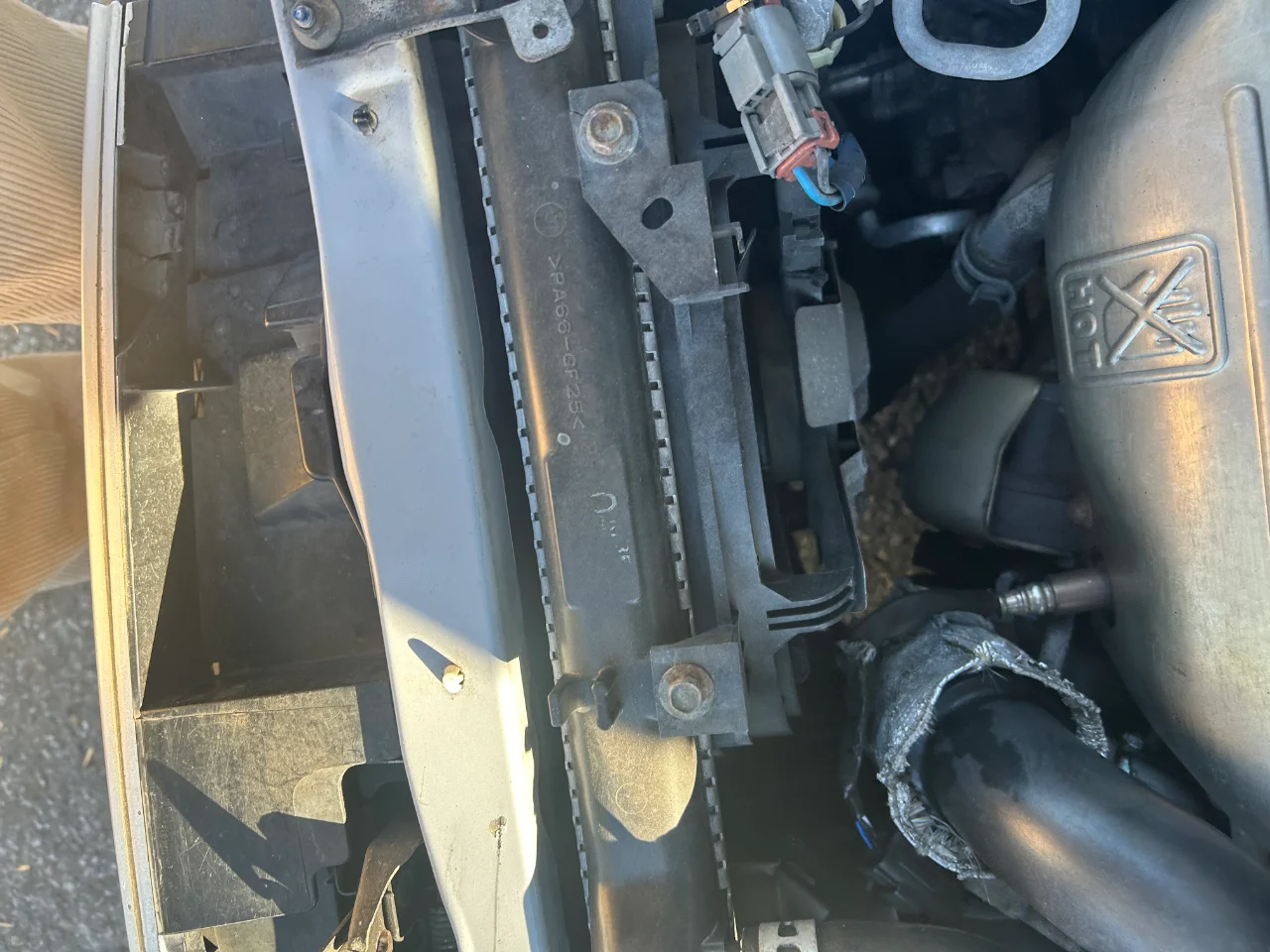

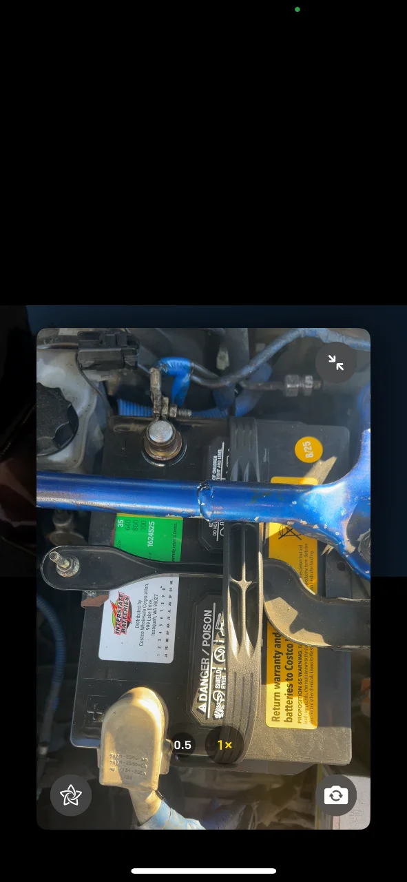

Hello, I’m 22 and I’m looking at an 2003 Mazdaspeed Protege with 165k miles to upgrade from my 99 celica gt as a commuter to drive 6-70 miles a day to work. I know its high miles but I just love the car and I believe mazdas are very reliable. I’ve already had a look at it but not a drive, the interior and exterior is in 8/10 shape, and no rust (I'm from California).
My question is, when I go for the test drive this monday, what should I look for? Especially big ticket items that could be in the four figure range to fix? Especially things thay would leave stranded with a strike on my attendance, which id very important at my job. What would be something that would be a red flag or dealbreaker for you? Some additional info: he said it burns a bit of oil, its got a cold air intake, he has had the tranny rebuilt within the last 2 years, he is only selling it because he is older and wants to go back to driving a standard. He’s always used valvoline restore & protect in it, however, theres little info about the previous owner before him. And second question. Its listed for $5,000 but im thinking of offering 3,800 and standing firm on 4,000. Should I go lower due to the high miles? Or is $3,800 a reasonable offer to stand my ground on, and why?
I’m just hoping im not opening a can of worms buying this car and of course before a final sale I’ll be having my dad's mechanic do an inspection. Thanks in advance, I'll post some pics.

I bought my msp around the same miles and it's been pretty reliable engine-wise, but I don't drive it anywhere near 70 miles a day. Most of my issues have been fixing cheap mods/repairs that the previous owner did (mostly suspension, btw if the shocks are bad you probably won't be able to source struts for the rear that have oem fitment). A lot of the unreliability comes from the turbo, if it's pushing more than the oem boost (7psi), I personally wouldn't expect it to be reliable - unless the internals were upgraded.
The most expensive engine components that might be bad at this milage would probably be the turbo or cats, btw the car has 2 cats, so it would easily be over 1k to get it past smog if they are bad (considering it's burning oil it's worth checking). The paints pretty nice for a cali car though, so imo 4-5k is a fair price if you want an msp, but I wouldn't trust it to be reliable for a 70 mile daily comute in the long term.
I agree with the above and the shifter looks a bit awkward. Manual gearbox or auto on this car?
