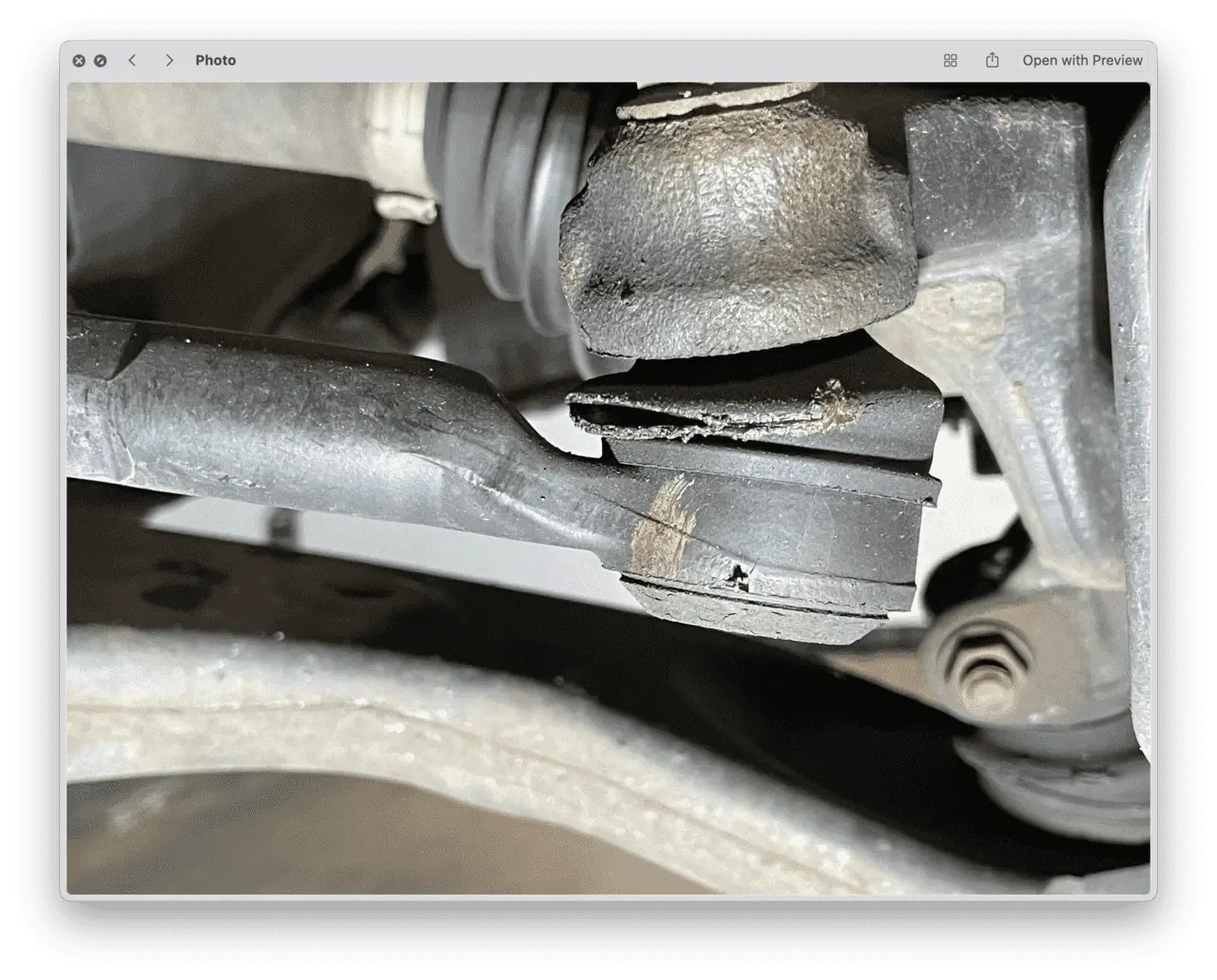

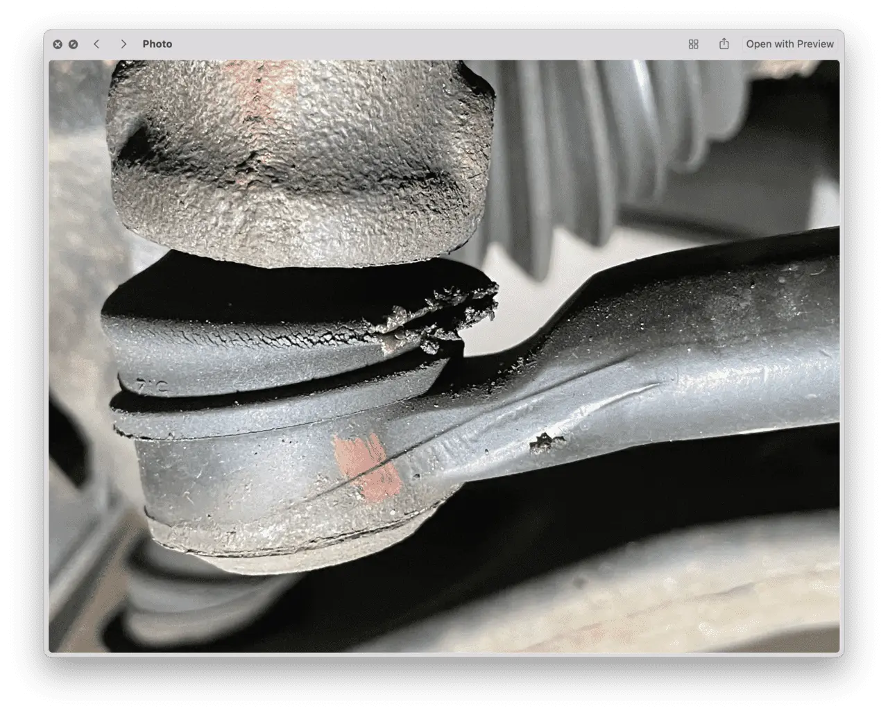

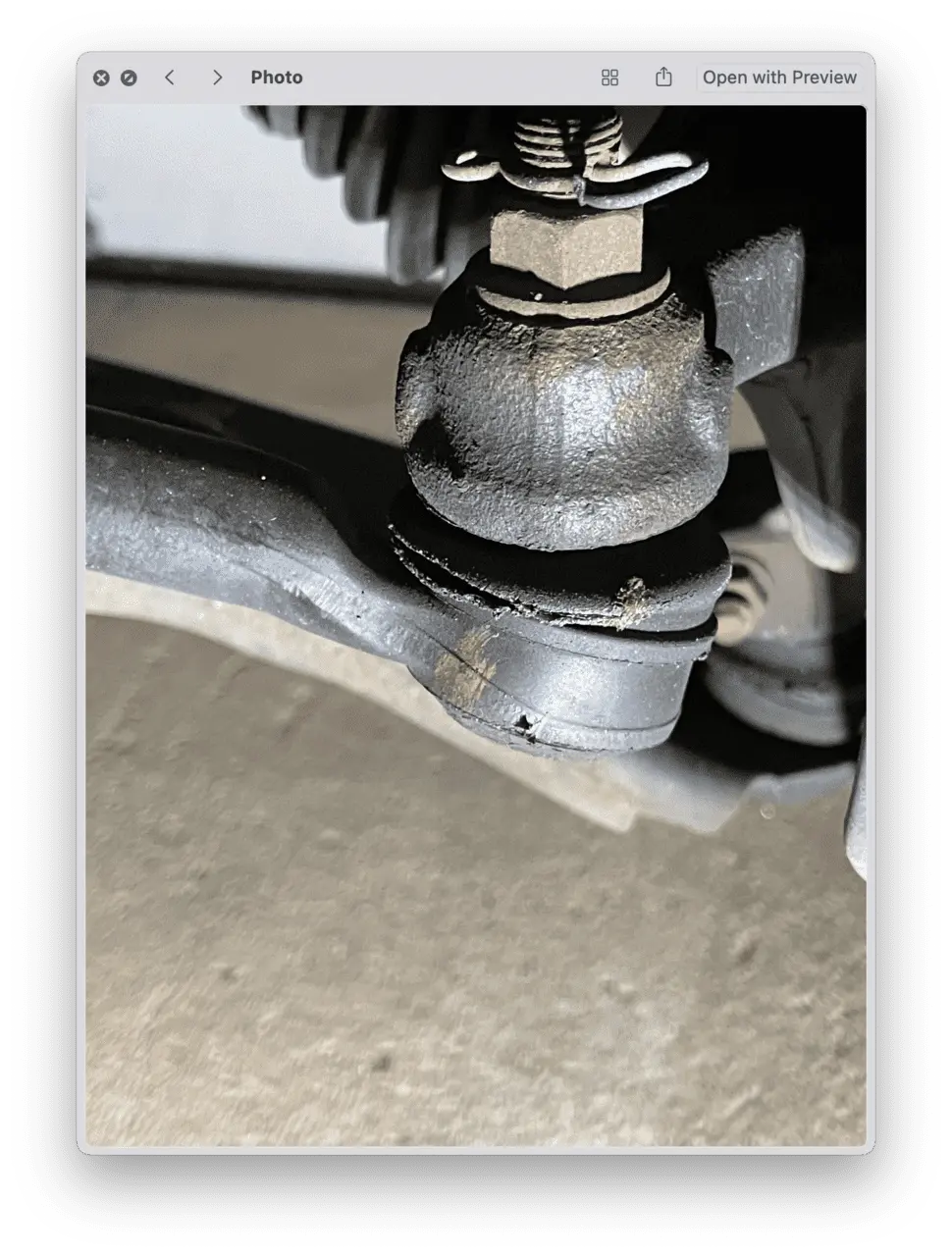

Each time I change the oil, the dealer makes a big deal out of this. Independent mechanic (several of them) say the car is fine, I don't have to replace the tie rods at this time. Who is right?
The dealer is correct that there is something broken that needs to be fixed. Their job is to report broken components and bring them to your attention in an honest manner. I’d be more concerned if they failed to report damage and it caused problems later down the road.
Cracked boots won’t disable your car and make it undriveable overnight, t’s just that water and crud will get inside and make the joints lose their lube and wear down over time.
I would honestly shop around for Moog branded tie rods and have your mechanic or yourself install them at some point.
…I don't have to replace the tie rods at this time…
I believe this is the main point here. The tie rod ends may not be failing now, but does the OP want to wait until they are bad enough to cause a stranding or even an accident? How long should he wait until he does replace them? Six months? Two years? Until the steering feels funny? Responsible vehicle owners take care of their vehicles to help ensure the safety of themselves and of others. Some of the folks below waited a bit too long.
As others have said, the boot being cracked and split open let's moisture in and it will eventually cause the joint to fail.
Steering components are pretty important. Yeah, you could pack some grease in there from time to time and get by for awhile. If it were my car, I would replace them soon.

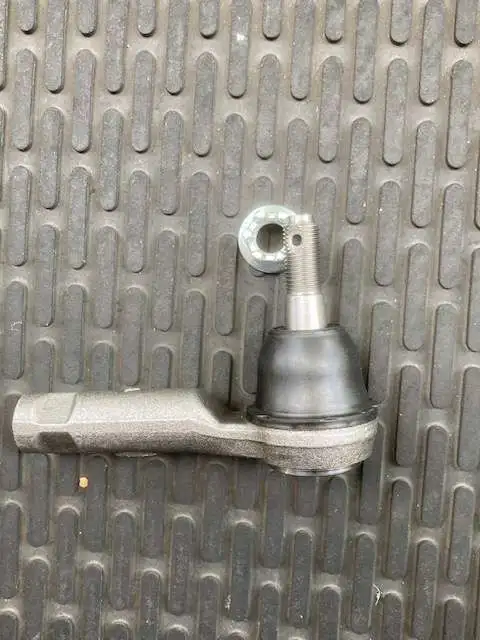

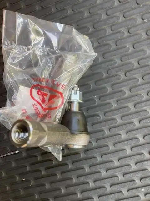

A few months ago I had new tie rod ends installed. Since OEM Mazda were on national back order, I went with a quality aftermarket part made in Japan. I chose this brand because of the decline in quality of Moog components in recent years. Beck Arnley was a trusted name but still don't always know what's going to be in the box(could be a Moog part). Checking Rockauto as well as Partsgeek (linked here) showed some pretty cheap but questionable others.
These are nice quality parts and come with the nut and cotter pin. Be aware that the shipping cost about $20 but I had them in 2 days. So a bit over $60 altogether.
Here's pictures of what I received. Nicely machined and finished.
Edited to add : that this is one alternative if Mazda OEM not available. The online Mazda dealers will list parts as if they are in stock, but then after ordering, notify you that there is a lead time involved because they must be sourced from Mazda distribution center.
