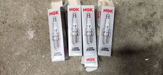

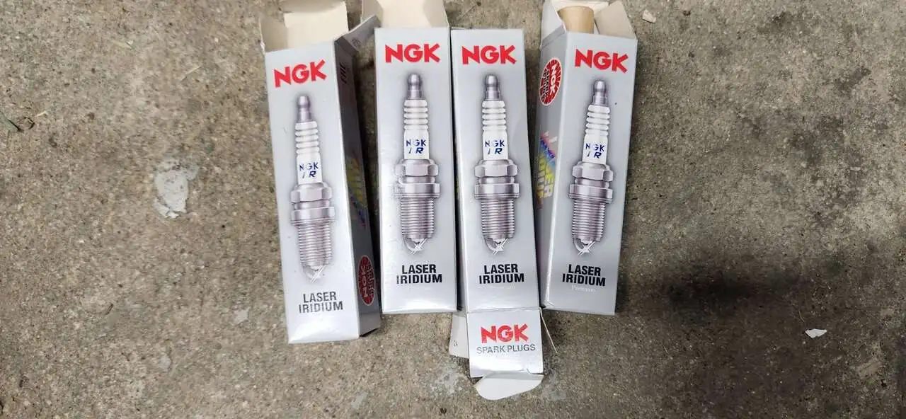

2016~2023 CX-9 41K spark plug change, found NGK plugs in the wild

Just a word of warning to those who are changing their own spark plugs. Do NOT use anti-seize on your plugs when installing NGKs. They are designed not to require it, and in fact warn about using it. From their web site:
"NGK spark plugs feature trivalent plating. This silver or chrome-colored finish on the threads is designed to provide corrosion resistance against moisture and chemicals. The coating also acts as a release agent during spark plug removal. NGK spark plugs are installed at the factory dry, without lubrication or anti-seize.
Anti-seize can act as a lubricant, altering torque values up to 20 percent, increasing the risk of spark plug thread breakage and/or metal shell stretch. Thread breakage can sometimes involve removing the cylinder head for repair. Metal shell stretch changes the heat rating of the spark plug and can result in serious engine damage caused by pre-ignition. Do not use anti-seize or lubricant on NGK spark plugs. It is completely unnecessary and can be detrimental."

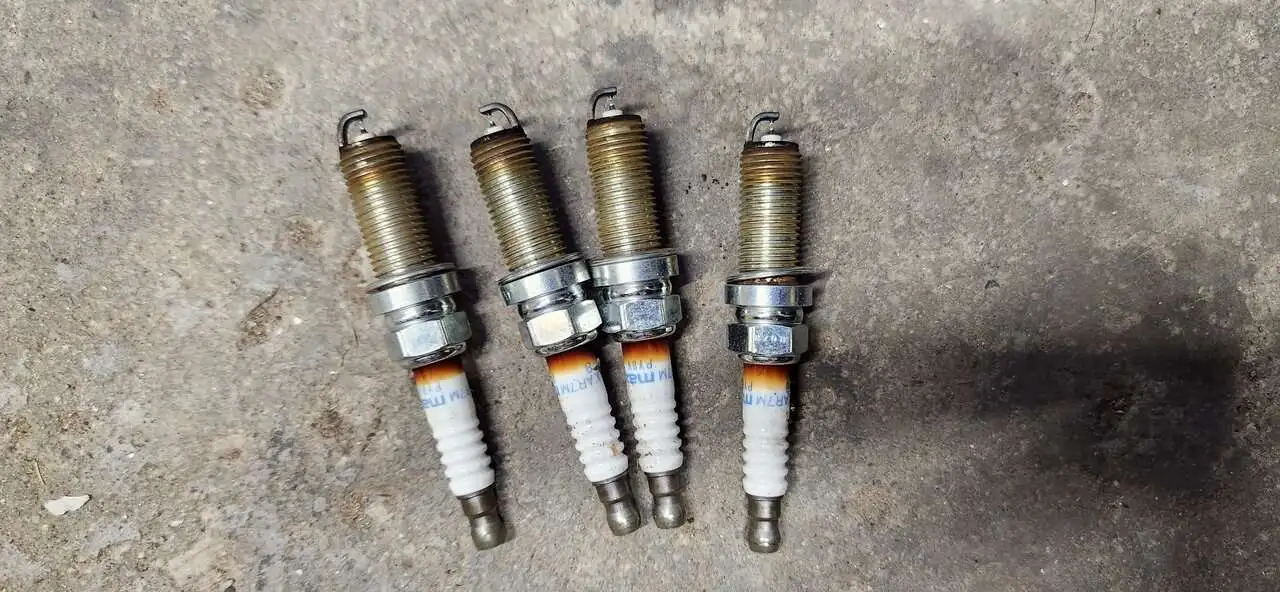

Today I just replaced my 2018 cx9 spark plugs at 39k it took me a few hours because of the stubborn ignition coil didn't want to seat in. Anyway, what do you think of the condition of the spark plugs at 39k miles?
Mine looked just like yours, but at 70k miles.

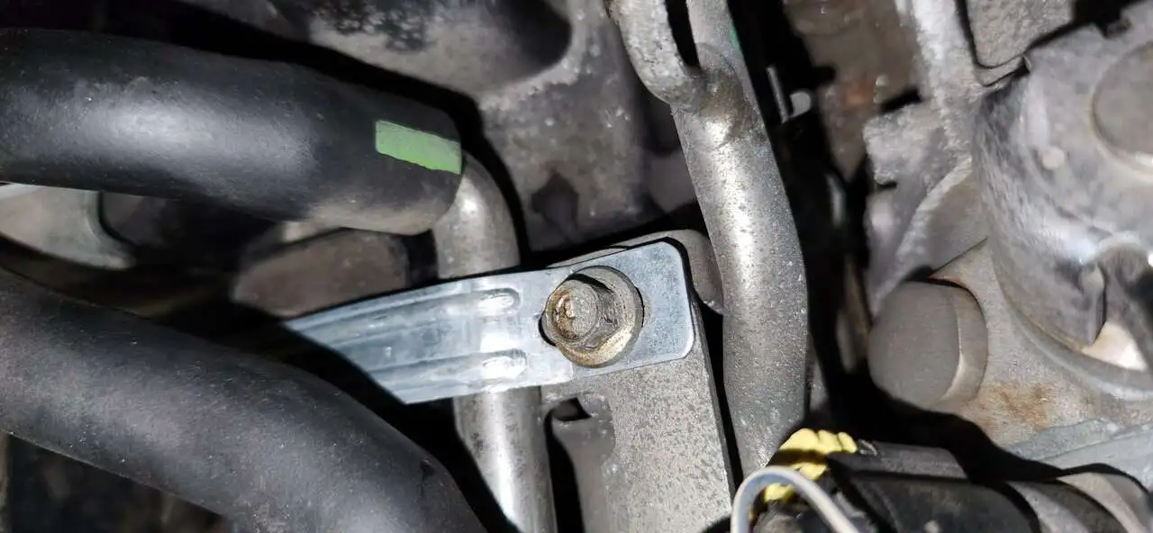

So I need a lil help plz!
2018 CX9 GT-- original owner with 127k kms.

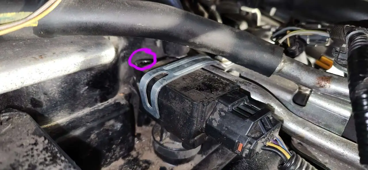

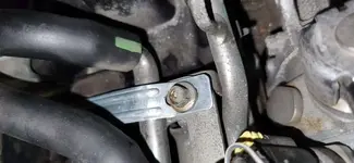

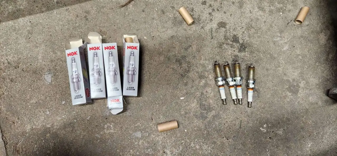

I just sourced NGK Iridium plugs, the same mentioned here by the OP. Looked at a few videos and write ups and decided to take on the job.
The change itself is easy except for the problem that I ran into.

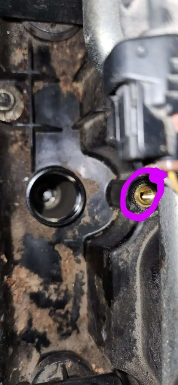

The plug on the far right is restricted by two rubber hoses that is sorta in the way but manageable. While replacing that last plug (always something ain't it!?) and securing the 8mm bolt, it stripped flush to the nut that's on the valve cover. I tried tapping into it and reversing but I may need to source another tap as the one I need for this size broke on me on another project and I couldn't use it.
I was able to McGiver a metal jacket onto a nearby 8mm bolt and extended it to hold, as in the pix. Has this happened to anyone? The bolt snapped under very light pressure using a small 4 inch socket. Only thing I can think of it may have been broken on the first plug change (at the dealer at 64k km interval) and they never bothered to say anything, though this is speculation on my part.
Also, I started each by hand and then snugged them all at the same time doing a little and moving onto the next, much like you'd do tires.
Anyways, it's holding in place but obv I don't want to leave it like this. I didn't take a picture of the broken bolt but it's the 8mm that holds the far right coil pack in place.
It's surprising how firmly it's being held in place but not looking to drive around like this, though it's working like a charm.
Thoughts on fixing this plz???
Also, that metal I put in place isn't touching any of the other piping that's nearby, just in case it causes some chemical reaction or cracks under vibration.

That's an outstanding fix! It really is! Only thing I would say is maybe put a piece of rubber between your clamp and the coilpack.
I have to agree, great fix! I would echo theblooms suggestion to add a bit of heat-resistant rubber to really snug the jacket up to the coilpack. You'll be fine to drive like that until you can source the right tap.
Thanks guys! You know, you take your time and sometimes sh*t still gets greasy... But, live and learn.
I'll post more pictures of the fix when I source that tap. For now, I'll drive it around with a few additional tools on hand in the event it slips out.

To be clear, the bolt broke off before it was 1/4 way in, likely was broken but left for me to find as I had no torque using a 4 inch 🔧.
Meh.
The plastic housing that's holding the nut on the valve cover, anyone know if that is easily replaced rather than having to tap the existing one? It's likely to be cross thread anyways at this point.
Alternatively, I'm thinking tap with a smaller bolt to hold into place over the existing broken bolt.
It's simply to hold the coil pack snug.
