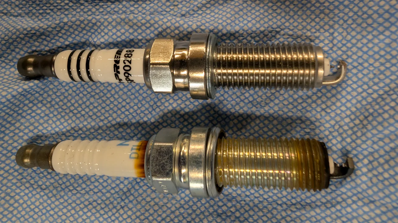

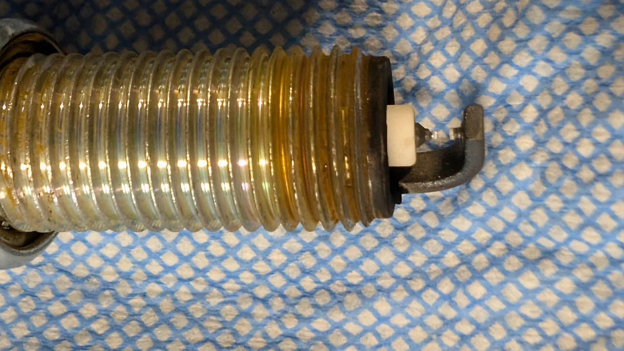

Finally got around to changing my 2018 CX9's plugs at 61K miles. I used the NGK DILKAR7M8 NKG Laser Iridium (from Amazon, $20 each). Installation is kind of a pain but it's do-able in about 20-30 minutes.
It was also really easy to remove the coils from the plugs (not my experience with some other makes). Old plugs came out in decent shape (gap and electrode suggest the plugs could have gone much longer). The color differences in photo are mostly attributable to lighting.

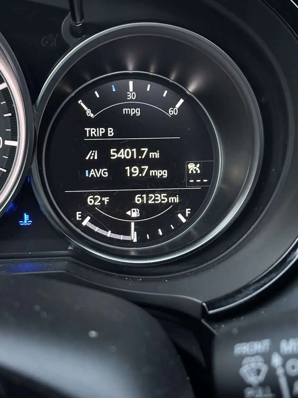

So far, no noticeable changes in idle or performance. Will report back on MPGs after a few tanks of fuel.
Alright, have done a few tanks, and still getting the same (crappy) 19-20 MPG combined.
Suspect that these factory plugs are fine for 80-100K.
I put in new plugs at 40k and noticed slightly peppier performance. I track the mpg imprecisely on the display, usually 24-26. Your 19-20 mpg is either a bad calculation or something wrong with that car.
I never reset 'trip b' and reset 'trip a' at every fill up. It's pretty consistent.
We mostly do short, urban drives. I also have roof racks (Thule Aero Blades) installed year round.

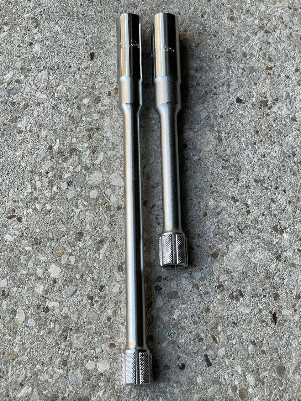

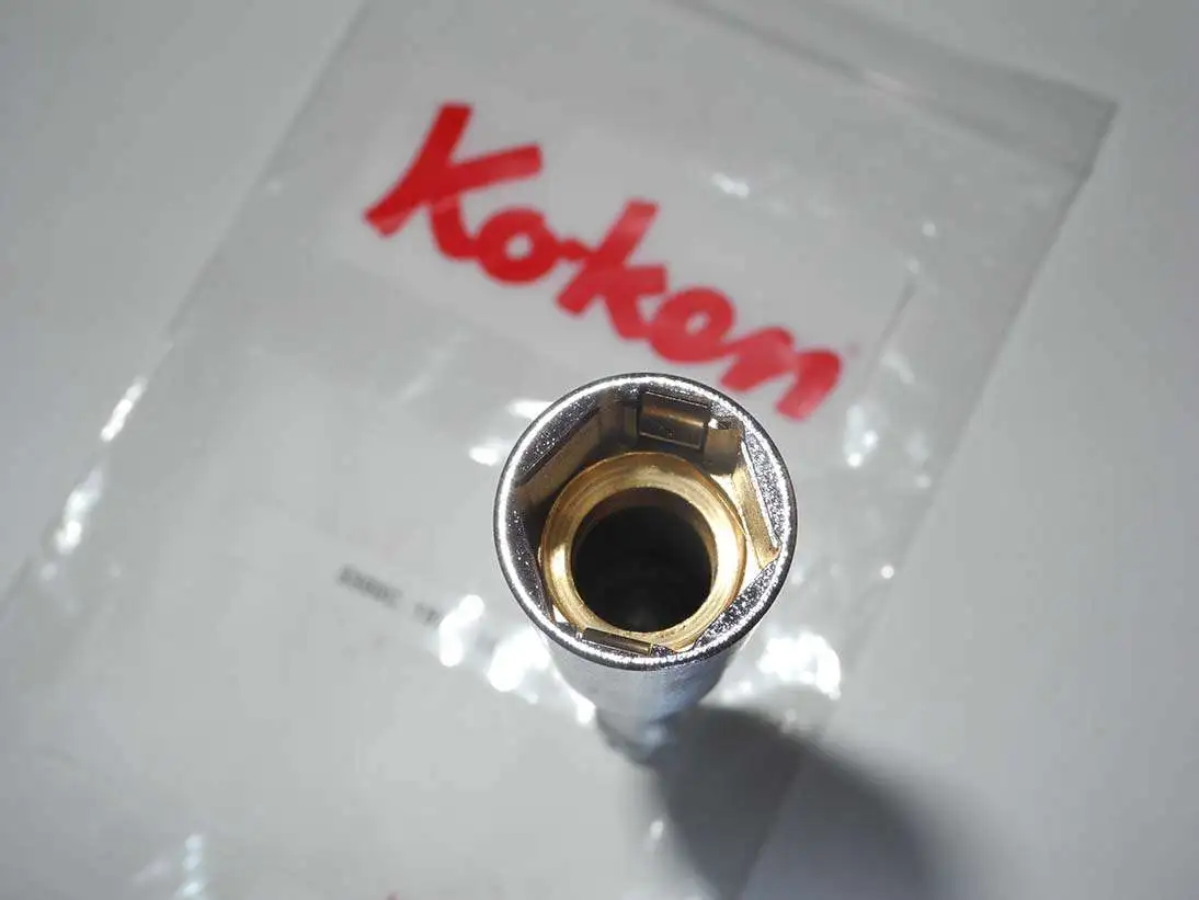

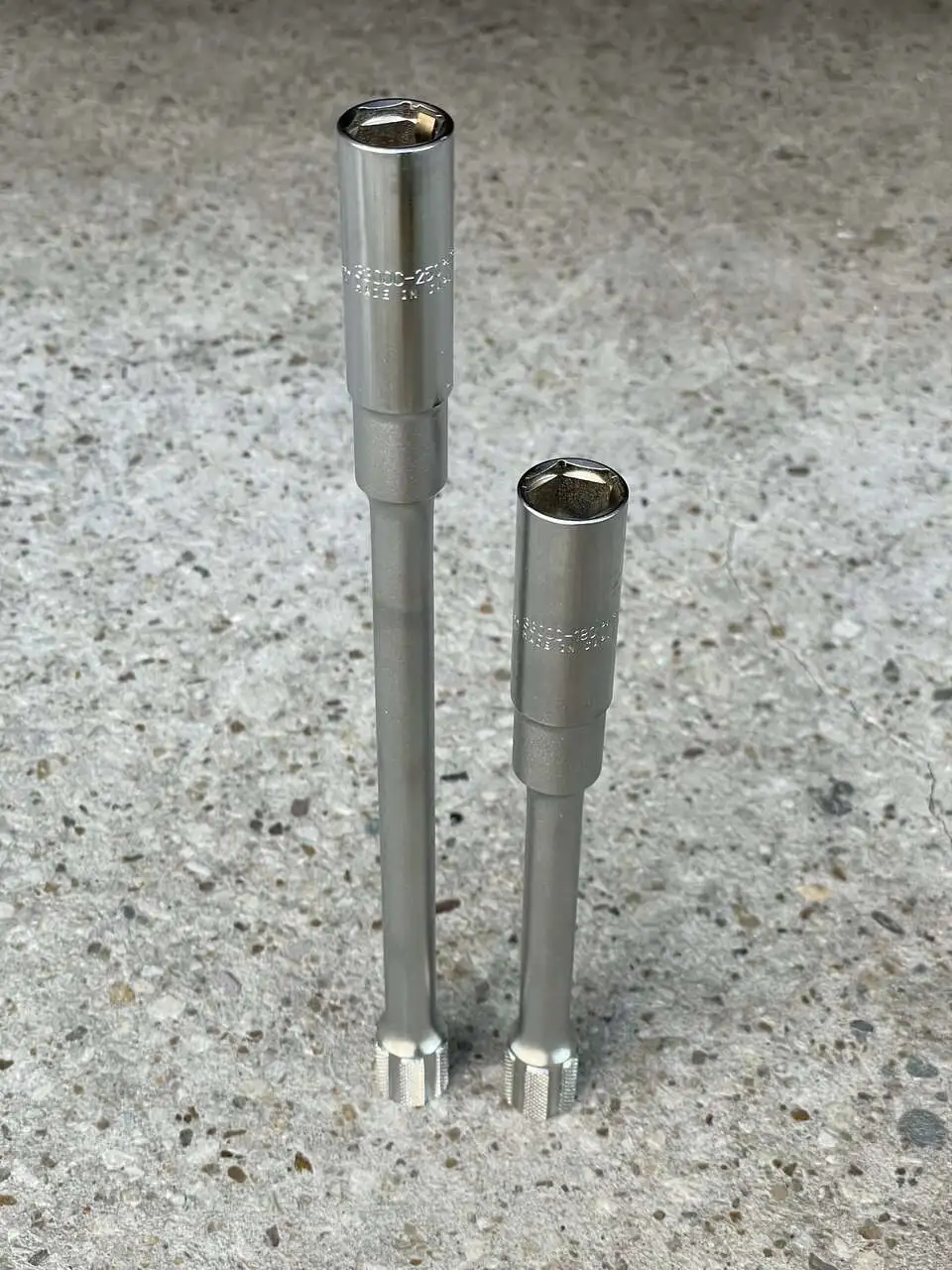

These are the only spark plug socket I will ever use:
No more rubber insert that can shrink, crack, fall out.
No magnets that can shatter.
No need for extensions that can get cockeyed or detach from the socket.
Only (patented) metal clips that grips the spark plug on the hex fastener head that will last forever, and work reliably even on a burning hot engine without fear of damaging the socket.
Professional grade, and not cheap, and easily costs as much as one spark plug or two. But if you don't want any headaches, buy it. If you're a mechanic, buy it.
I don't like to **** around with cheap tools any more unless I only can see them being used once. Good tools just makes working on cars much less frustrating and can keep you in good mood.
I realize you posted this awhile ago, but thank you for this. Picked up both sockets for around $70. I have zero issues buying quality, recommended tools!
The cost was easily justified as I’m going my wife’s CX-9 and my CX-5 at the same time.
These will definitely get use!
Since you ordered these recently, could you provide the part number for the longer socket? I just did the plugs on my CX-9 and it was annoying as heck when I'd finish tightening the new plugs in, and the extension would release from the socket before the socket came off the plug.
Sure! Here's both part numbers as it was a bit difficult to decipher from the photos:
Ko-ken 3300C.180-14 is the 180mm (~7") socket
Ko-ken 3300C.250-14 is the 250mm (~9-3/4") socket

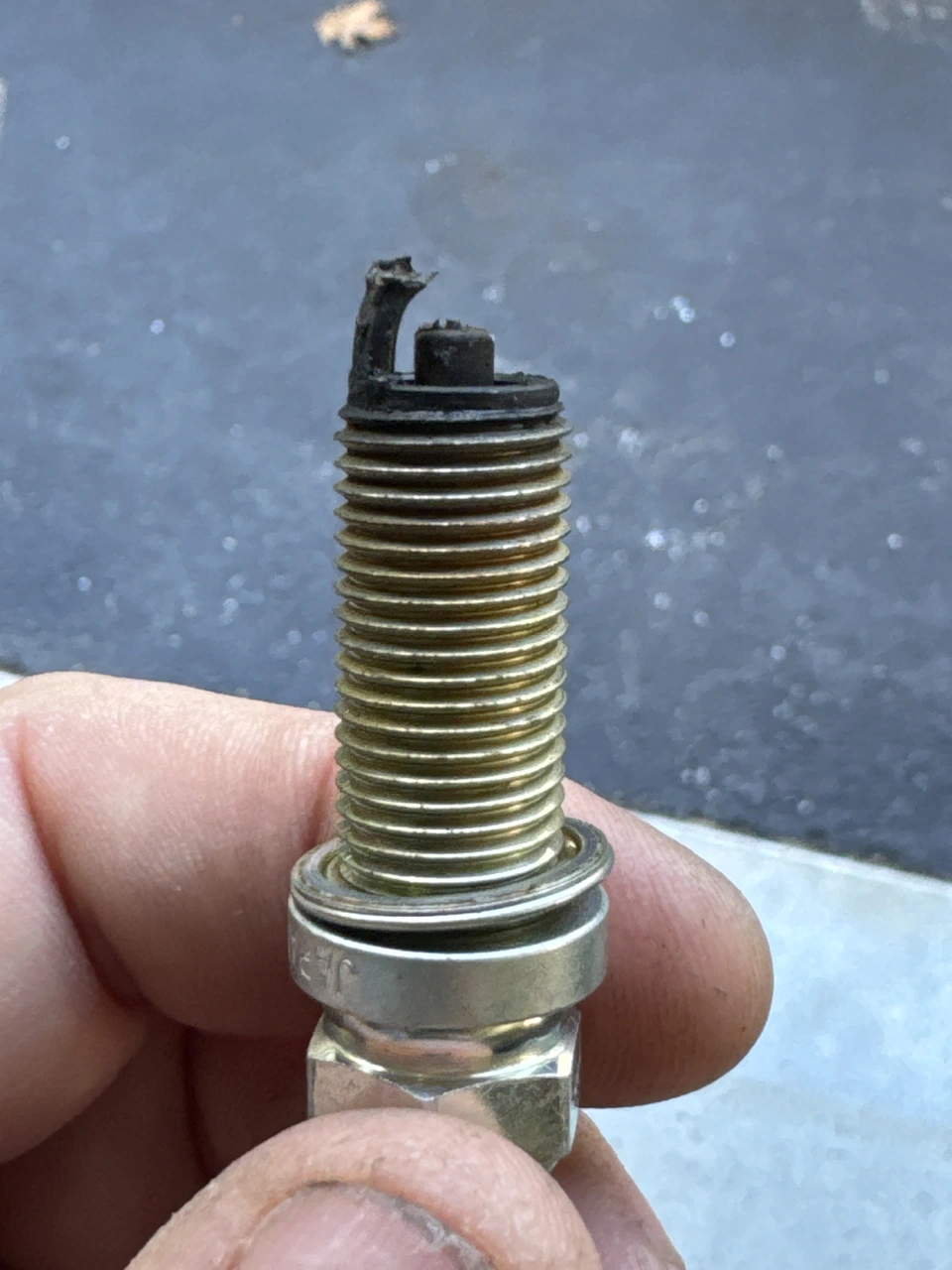

2018 CX-9 170k 2.5
So I got the code that said ignition coil pack cylinder two, figured I would replace that and all four spark plugs.
170k miles
Now I feel I have a knock I never had before.
Based on the spark plug, it also leads me to believe that the coil pack was probably fine.
Drive it with a knock
Or do I need to do something else next?
That plug looks awful.
Is a piece of the electrode missing or is it just bent? That looks like mechanical damage vs detonation damage.
How is your compression? Any chance you have a borescope?
My friend is going to bring over a bore scope and a compression tester this week.
But before I changed the ignition coil and the plugs, it had a horrible hesitation. Getting up to speed drove awful feeling like it wanted to stall.
I’ve done 100+ miles since the plugs and ignition coil. It drives so much better than before but I might still have some damage in there I guess.
My friend who said he could bring over the equipment, thought what I was hearing was coming from the valve cover.
Is the plug electrode bent or broken? If broken, definitely get the bore scope in there.
Driving 100 miles like that was probably not ideal. Hopefully the car was smart enough to cut fuel to the cylinder with the failed coil / plug.
I had a VERY old BMW many moons ago with VERY high compression pistons that would cause knock and pre ignition. I would occasionally destroy spark plugs and they would come out looking a bit like yours (w/ 'repositioned' electrodes).
Also, in my experience, if one ignition coil goes bad it is just a matter of time before others follow. If there's no engine damage, I'd probably replace the other three.

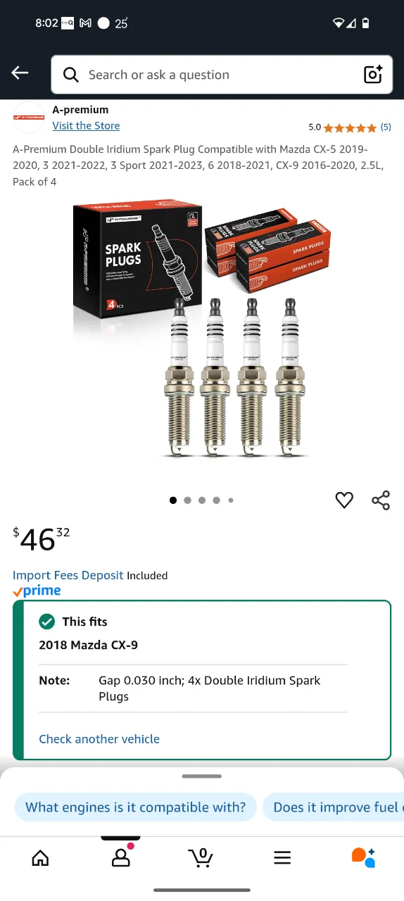

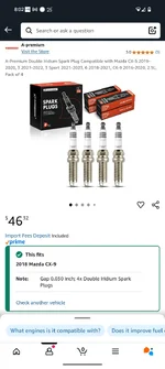

So just an update, my 2018 CX9 GT is at 171k kms or so. Noticed my fuel economy slip way down from 7.0L/100kms to about 12L/100kms.
At the time of this change, I had about 165k kms. The last I changed plugs was roughly 120k, not quite the 64k mark as per the manual. My first change was done at the dealer with OEM plugs from Mazda. The first time I did it (at 120k mark), I used the popular NGK 92088 ones mentioned here a lot. Well, it didn't get me as much as the OEM plugs before I started noticing fuel economy dip horribly (OEM would give another 15-20k kms before a dip in economy numbers.
Anyways, based on the early declining state of the NGK, I decided to use a new brand with good reviews.
A- premium was purchased in Amazon for about half the cost as the NGKs. Time will tell, but it seems to be moving quite well. Fuel economy numbers seem to be at the 8L/100kms, it may get better.
I am using new tires that are more grippy, so I'm expecting a loss there. Plus, running spacers that are flush to panel but on the rear only.
Check out the pictures.
Oh, and my McGivered boot on the 4th plug is still holding up nicely. I had cross threaded (or the dealer and they left it for me to find) the bolt, even though I did so by hand and followed logic... No codes, running well. Will post an update.

What plug is this? I'm thinking it's a generic and not one that is specific to the CX9. Could be your problem. Try using OEM or the NGK specific plug mentioned here.
