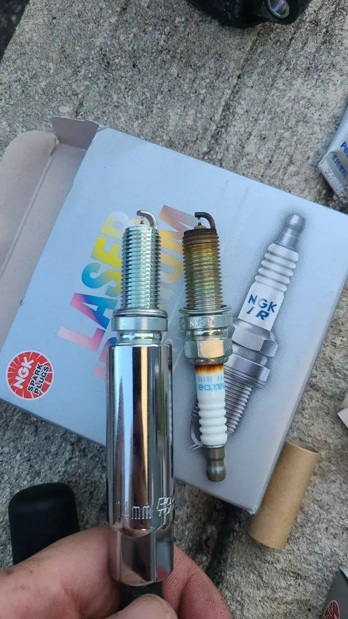

Hello everyone! I recently purchased a 2017 CX9 signature, my first Mazda (Traded in a Ford with a looming transmission problem)! I picked it up with just a touch over 41K on the clock. Reading the service manual I saw the spark plugs were do for a change. I did a lot of reading on the forums and found that many people have had to default to Mazdas OEM plugs (which are NGK anyway). I ended up plugging in the NGK part number into google to see if I could find any and sure enough Oreillys popped up so I clicked to see what the website would say. The part number (90288) showed up as "available for pickup by 8AM tomorrow" @ $21.99/each and decided to give it a shot! Sure enough the next morning I got an email that the parts were in stock at my local Oreillys.
I know many people have had trouble sourcing these, so hopefully everyone else can get these next day like I did, hopefully they are starting to be available for us. I attached a picture of the plugs I pulled out, they look phenomenal and by my untrained eye appear to be good enough to still be serviceable for another 40K. The change was very easy, I plan on doing a transmission fluid & filter (strainer) change next month and will post a guide walkthrough as well for those interested.

I think the plugs were in such good shape the changing to new ones didn't really do much overall honestly. My old 97 stratus is the only vehicle I've ever noticed a difference when the plugs were changed. I think Mazda was very conservative in their 40K service interval. However when I changed the air filter, I noticed a difference in MPGs for sure. I think it was the original filter, it was very nasty.

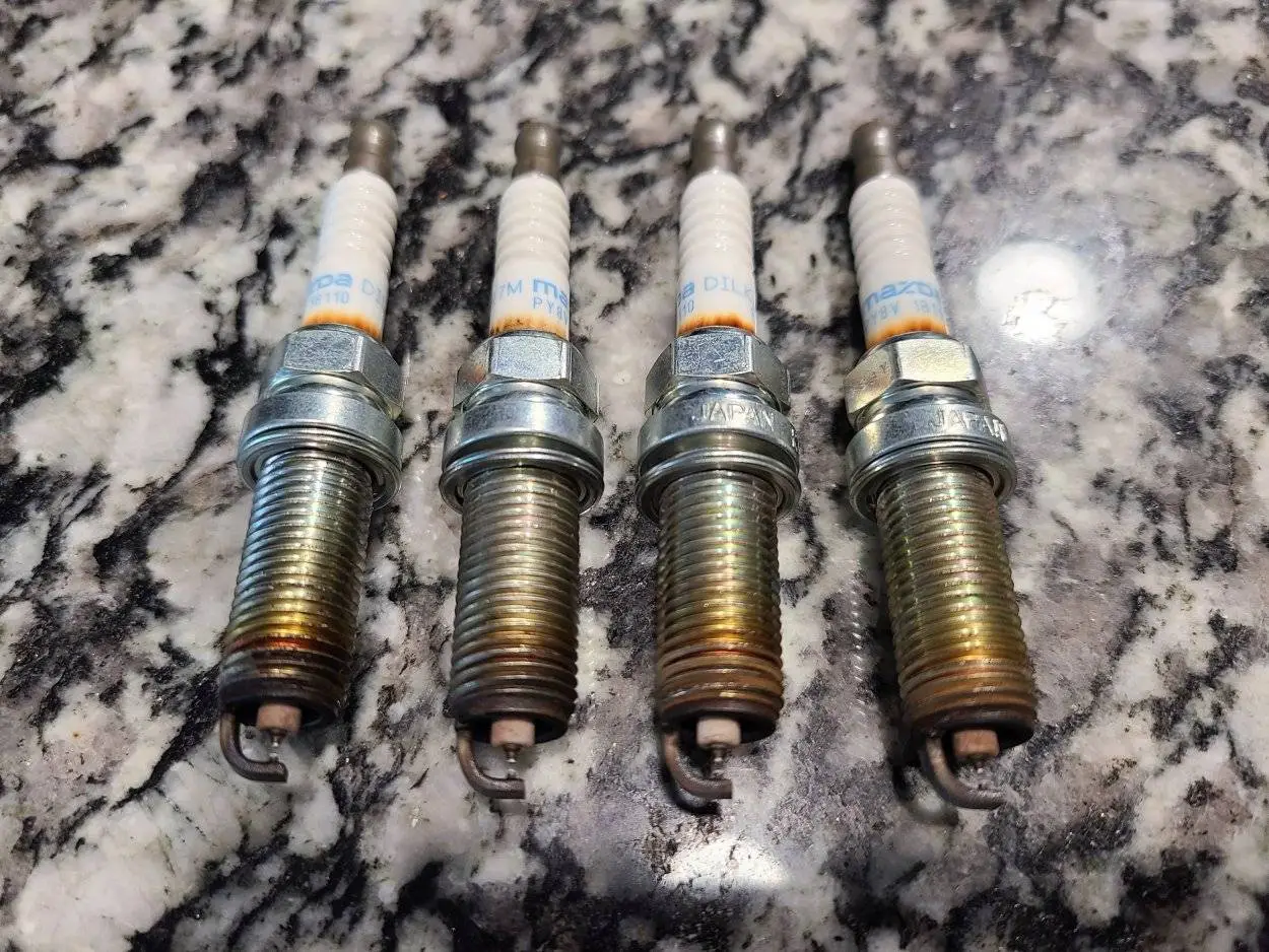

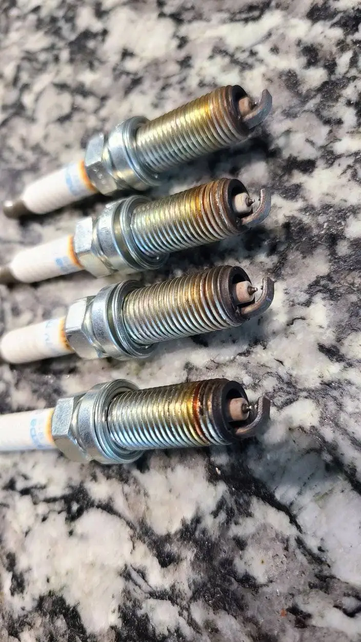

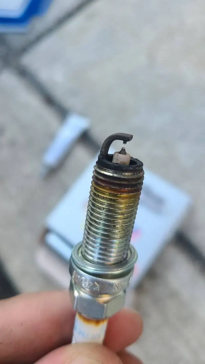

Today I just replaced my 2018 cx9 spark plugs at 39k it took me a few hours because of the stubborn ignition coil didn't want to seat in. Anyway, what do you think of the condition of the spark plugs at 39k miles?

Ya, that burnt looking portion of the boot base seems concerning, but from what I can tell that's normal for these cars/plugs. Mine looked exactly the same, although mine were changed at 100,000 km. A little over the suggested period.
