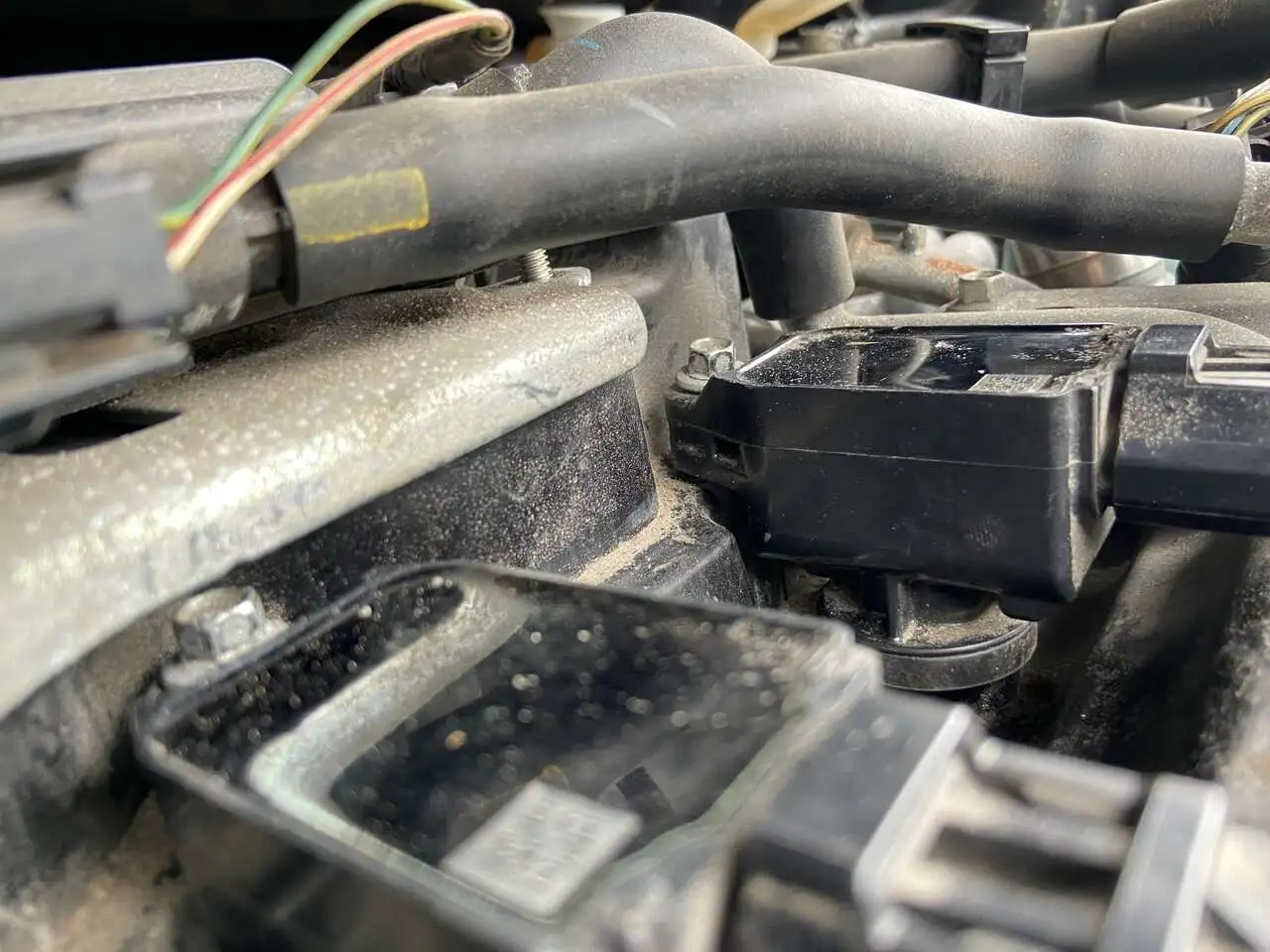

Ultimately, I was able to get the last pack in correctly, but the 8 mm bolt holding the coil pack in place made a awful plastic grinding noise going in and the pack in not tight like the other 3. It is fully in, but I can still move it a little. I don't think the car is misfiring, but I am not sure. When packs 3 and 4 were not lined up correctly, it was clearly misfiring. Now the engine sounds pretty normal to me, more or less like it did before. I just have this doubt because the pack wiggles a little.
Should I try to realign the bolt straight (maybe it went it at a poor angle... seems unlikely), or do I need to replace the coil pack (maybe I damaged the plastic on the pack?).

So for the last bolt, you're unable to tighten the bolt any further, and the coil pack feels a bit more loose than the others? It's possible that you crossthreaded the bolt that snugs the coil pack. You could probably remove the bolt and try using a thread chaser to repair the threads, but then you'd risk getting metal particles in places you don't want them.
This is just a temporary solution, but I would find a plastic washer that would fit between the bolt and the coil pack, something just thick enough to shim the bolt up against the coil pack. Cut them on one side so that you can slide one or more under the bolt without having to remove the bolt.
Thanks for that. It's a bit odd, because the bolt looks all the way down. There is no gap or exposed bolt anymore. (but maybe not 100% straight? see photo). There is no vertical wiggle on the pack, just a little rotational and horizontal wiggle that is noticeable.
Can I safely disconnect that hose sitting over top of the pack for closer inspection?
Thanks again!
To me, it looks like there's maybe a millimeter of space between the bolt head and the coil pack, which is probably enough to let it wiggle slightly. I checked my coil packs they don't move at all.
I'm not sure if the hose can, or should, be disconnected. It looks wedged on the fittings pretty good, and if you were to remove it, you'd need to make sure the yellow mark lines up where it did before. If you have some paper near by, you could try folding it up and wedging it between the coil pack and the bolt. That would also give you an idea of how thick the plastic washer(s) need to be to get everything tight.

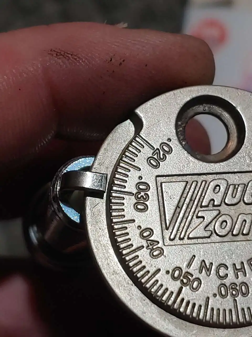

So what should the gap be on these, looks like they are pre-gapped at 0.030", is that correct for the 2.5L Turbo?
has anyone check the gap on the old plugs to see if there is any wear other than a visual look?
40K on iridium does seem maybe a little premature, but with only 4 the cost isnt too bad, especially if you source them from Rock Auto.
They are about 167 at my local stealership. I was like 😮. Now I know when I approach the 39k mark I will not purchase them from this dealership.
The gap on modern high tech spark plugs is set at the factory and not intended to be set in the field. On olden days with copper spark plugs, I know, we had to set the gap when we installed them and when we cleaned them.
Yes, modern plugs come pre gapoed, but no one plug can be gapped right for every application.
Plenty of times ive had to regap iridium, plat, plugs cause they didn't match my factory spec gap.
So,my question still stands, anyone know the gap for the 2.5 turbo?
And by the way, ive bought many NGK, Denso plugs that despite being factory gapped were not all the same, and some even had some mis alignment were the top iridium tip or U groove on Densos did not perfectly align with the main electrode tip, resulting in sub optimal spark.
I have a plug tester and visuslly inspect gap, alignment and spark. My tester has shown improved spark when aligned spot on.
Some cars aren't the easiest to change plugs on, this level of checks and detail can save a lot of time.

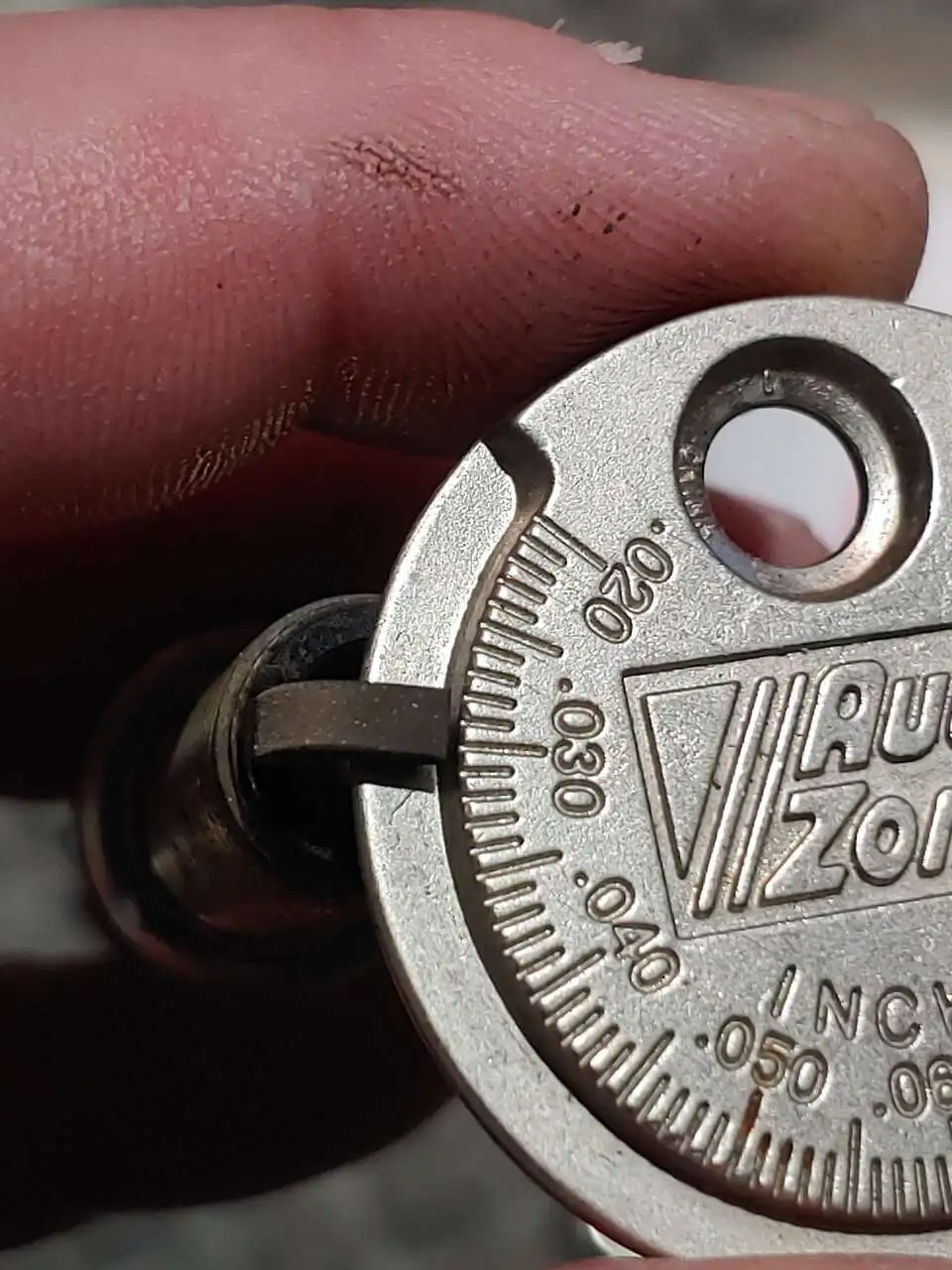

I just measured mine and right, they are at 0.030" +/- 0.001.
Still would like to know what Mazda says the gap SHOULD be, just because they are pre gapped at 0.030 doesnt mean its correct for our engine, unless this is the only engine using this plug.
It very well could be the correct gap, would just like to confirm it from Mazda.
Maybe I just havent looked hard enough yet, in the owners manual manybe?
I guess what Ill do is measure the old plugs when I get them out, at 51,000 miles, and having an iridium tip and platinum ground, they shouldnt be all that worn, so then I can corroborate the 0.030" spec/pre-gap.

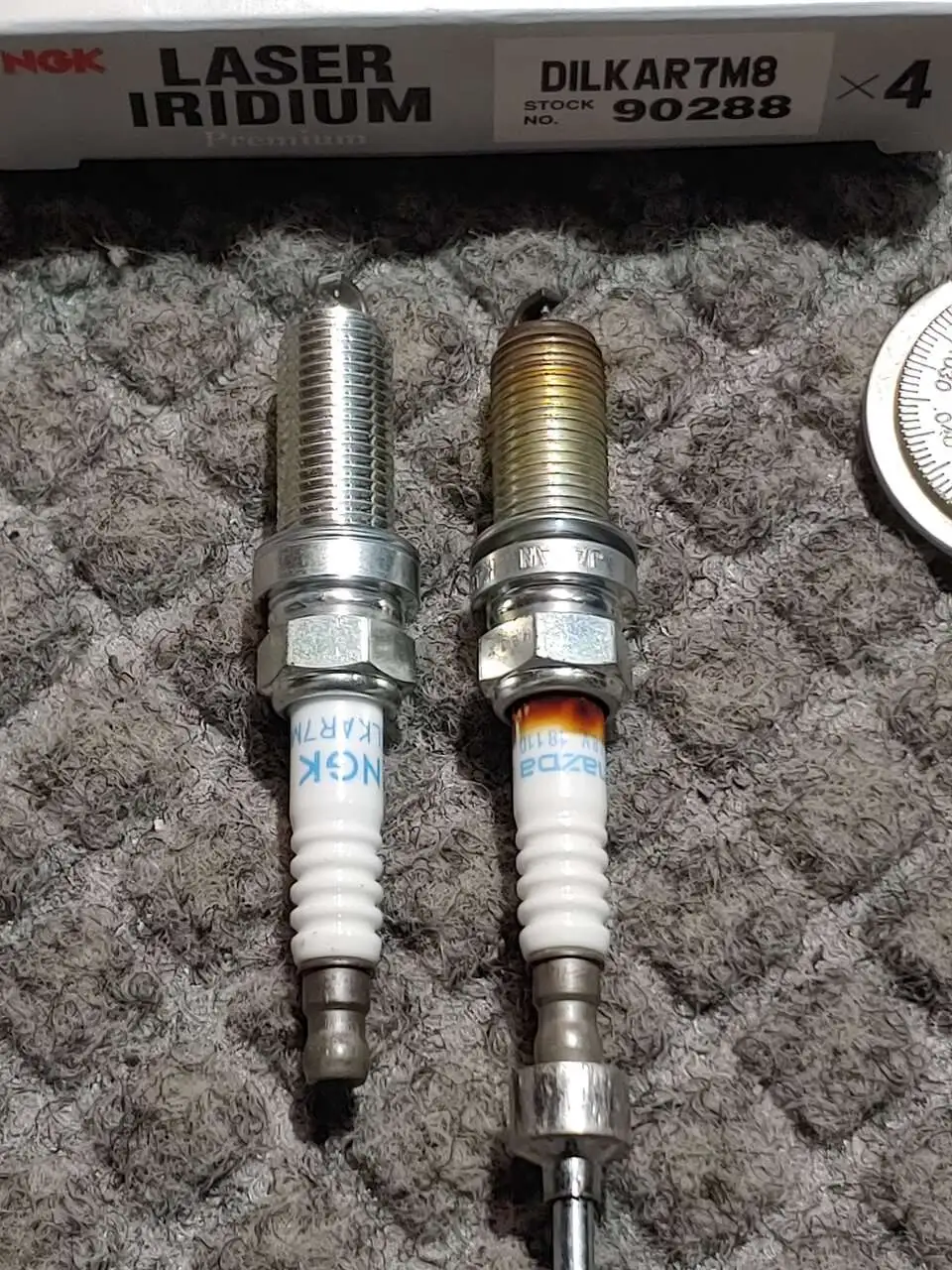

Ok did my plugs. Removed the original OE Mazda olugs, the electrodes looked really good, with no wear, they still measured at 0,030in, so that confirms the NGK laser iridium replacements are gapped correctly at 0.030in. See pucs.
The only thing I noticed was the heat marks right at the base of the white ceramic next to the metal hex head. Not sure what this means.
I noticed no difference in performance after the change, but with no real wear im not surprised, nore should we given these are iridium. I think the Mazda 40k requirement might be more for heat related degredation, as seen on the insulator.

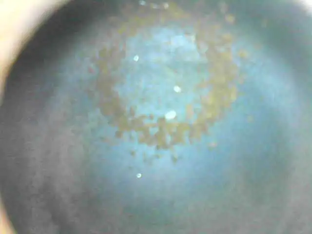

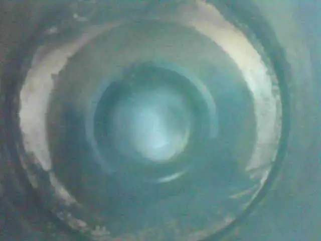

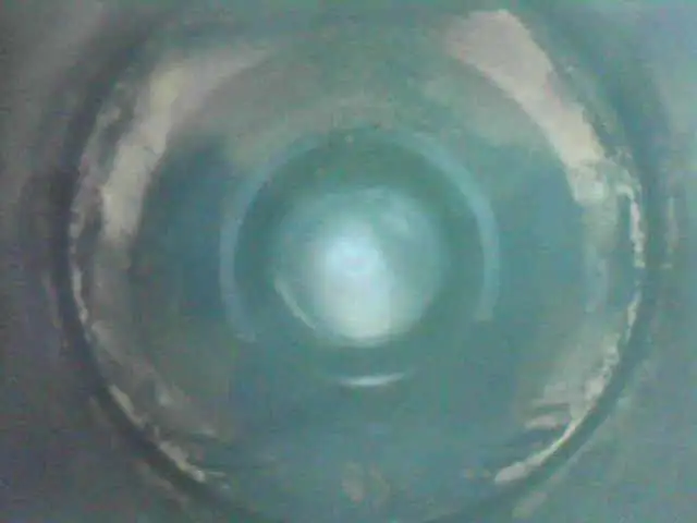

I also scoped the cylinders, and they all looked pretty clean. 2 and 3 where near TDC so you cant see much, but here is cyl 1, 2, 3, 4 in that order A little carbon near the edges , but pretty clean for 51k, not oily in anyway, bone dry. I did run techron in the past a couple times, and used CRC GDI intake valve cleaner just prior to this plug change
This CRC cleaning I feel did improve performance. It wasnt running bad at all, but I do notice more torque, which is easy to quantify as I get more tire squeal from a start then the drive right before. Worth using the CRC even if these engines do better with valve deposits than others, they are still GDI engines!
Not sure what the rusty looking rings are near the centers on 2 and 3.
And my scope can't look back at the valves nor the cylinder walls, would be curious to see those. I might have to upgrade to a better one.

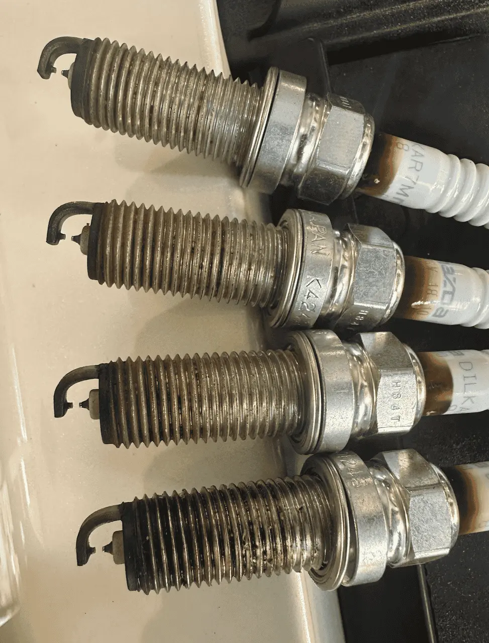

I was just about to open up a thread about spark plugs. It looks like I'm over due for a new set by about 20,000km (hard to say really, Mazda has no record of the prior owner ever changing them, but I won't know for sure until I pull them to check).
After doing some research it seems that, aside from the Mazda plugs, the one and only plug available is the NGK 90288 DILKAR7M8 (fyi, the Mazda part number is PY8V-18-110). RockAuto seems to not have them in stock, and NGKs own website lists them as unavailable. That's kinda weird. I also checked Denso's website and the only thing they list for 2nd gen CX-9s is the radiator. Anyway, I see that the local NAPA auto parts store lists them which is great, but I also noticed something really strange, it had this disclaimer in the info sheet:
The Mazda manual states the plugs should be changed at 80,000Km, but NAPA says 64,000Km. That's got me worried as now I'm thinking these aren't true OEM replacements. That or NAPA is just wrong, which is probably the more likely explanation.
So the local Mazda dealership quotes me CDN$50 a plug. NAPA is selling those NGKs for CDN$30. That's a significant savings, but if I have to change them every 64,000Km it probably works out to be the same. Has anyone else come across this weird discrepancy?

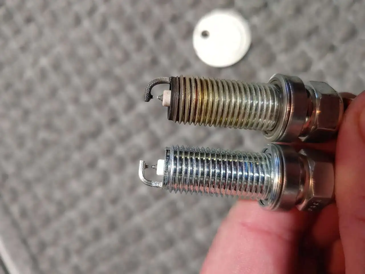

Finally got around to changing my 2018 CX9's plugs at 61K miles. I used the NGK DILKAR7M8 NKG Laser Iridium (from Amazon, $20 each). Installation is kind of a pain but it's do-able in about 20-30 minutes.
It was also really easy to remove the coils from the plugs (not my experience with some other makes). Old plugs came out in decent shape (gap and electrode suggest the plugs could have gone much longer). The color differences in photo are mostly attributable to lighting.
So far, no noticeable changes in idle or performance. Will report back on MPGs after a few tanks of fuel.
