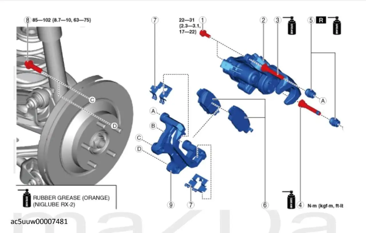

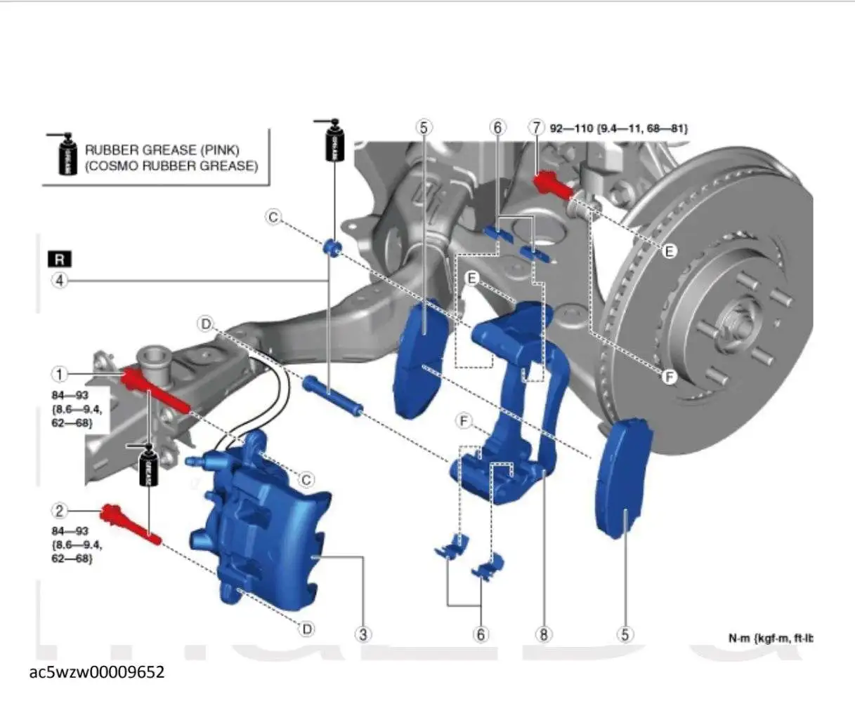

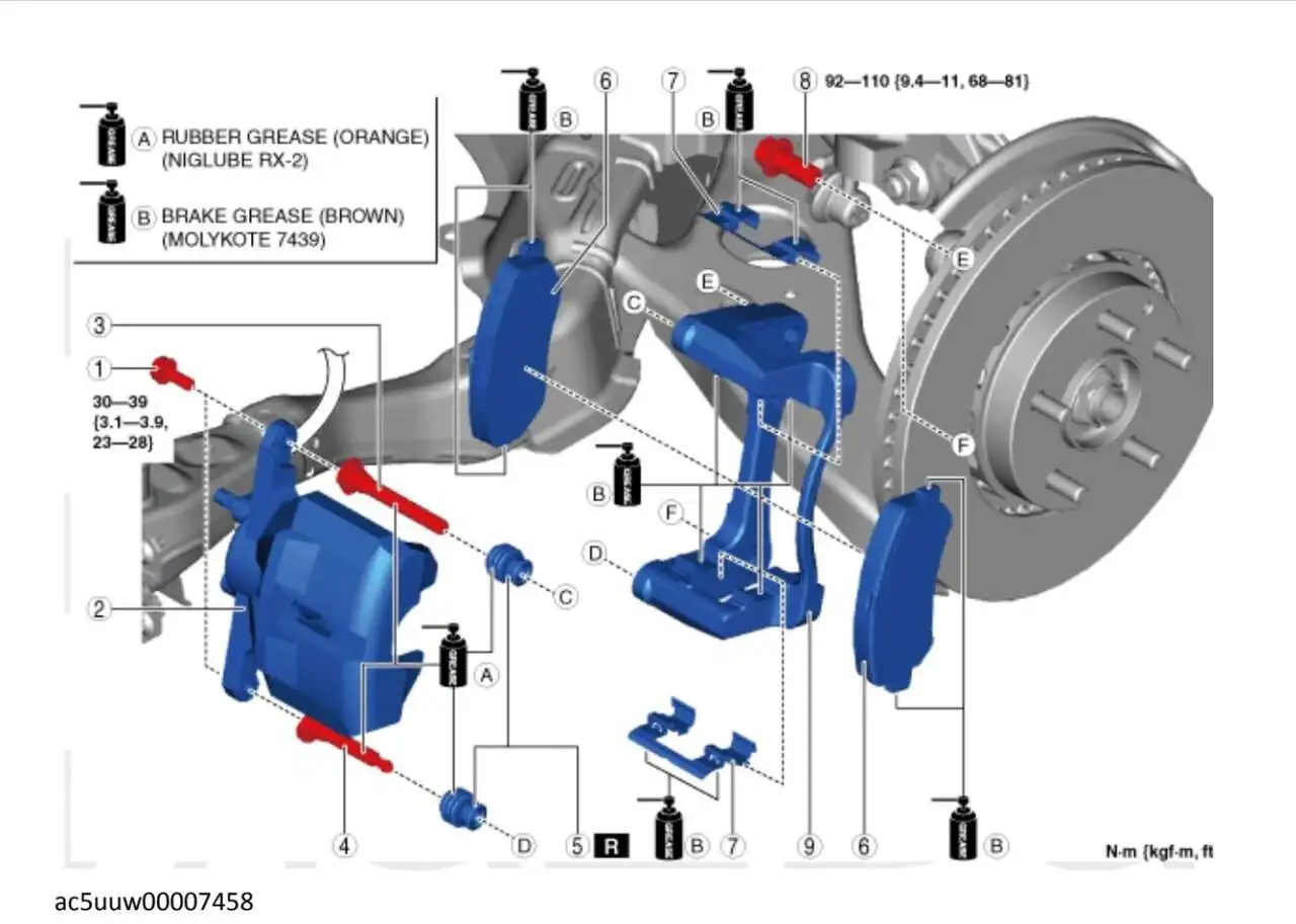

Here are the torque settings on caliper slide pins and caliper brackets from Mazda Workshop Manual for 2018 CX-5. Notice the inverse and bold “R” (Replace) pointed to all rubber boots of the caliper pins:
2018 CX-5 front brake single piston floating caliper torque spec:
2018 CX-5 front brake 2-piston floating caliper torque spec:
2018 CX-5 rear brake caliper torque spec:
