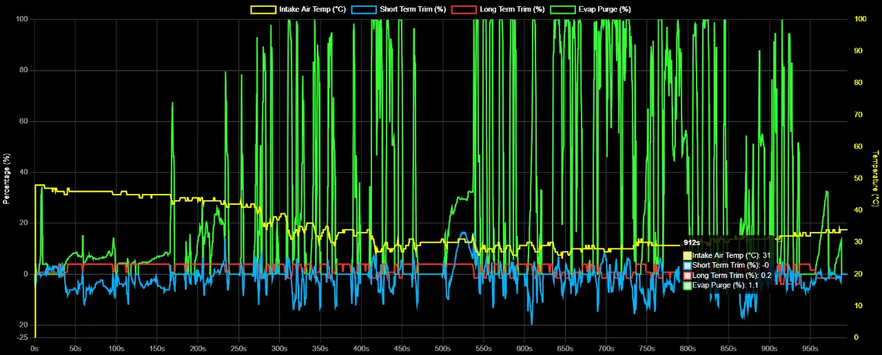

I warmed up the car and made a small trip, did not get chance to make a bigger trip but this is what my scanner picked up from the live data (Bluedriver)
Purge command is going to 100% and short trim is going as low as 19% (according my info it should be around +10 and -10) mine is mostly going negative all the time.

I was thinking i have a flooded charcoal canister, then again i did not monitor much of other data because of lack of time only because of the actual symptoms presented i monitored these sensors.

..."no one knows what an EVAP system is".. Seriously?? Find a new garage. Sounds like a bad purge solenoid or vent valve which is why you smell gas vapors especially if there's so much pressure build up.
