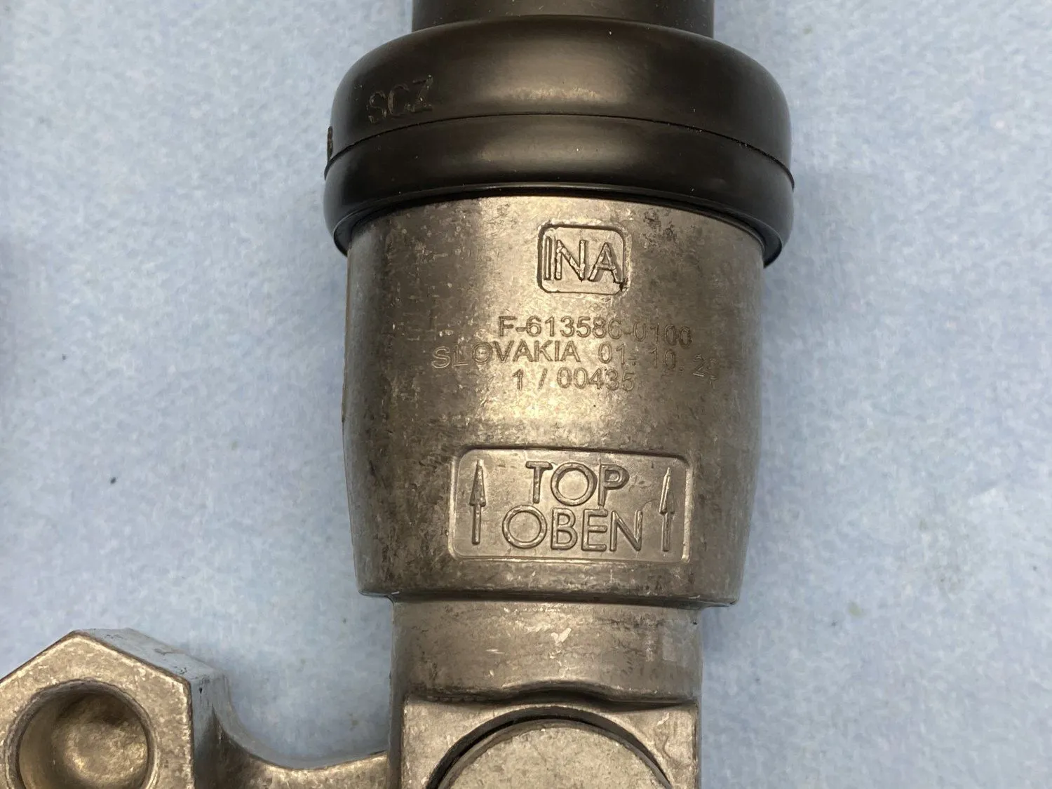

Just throwing in my 2 cents here. The original tensioner on our 2014 CX5 appears to be leaking (bought car with 53K, now has 113K, I assume it to be original). I just received the INA FT01291 tensioner from RockAuto for under $40. The damper body is marked F-613586-0100, and underneath that says "SLOVAKIA 01.10.20". I assume this to mean that it was manufactured 1 October 2020, given the normal European date format of dd/mm/yy.

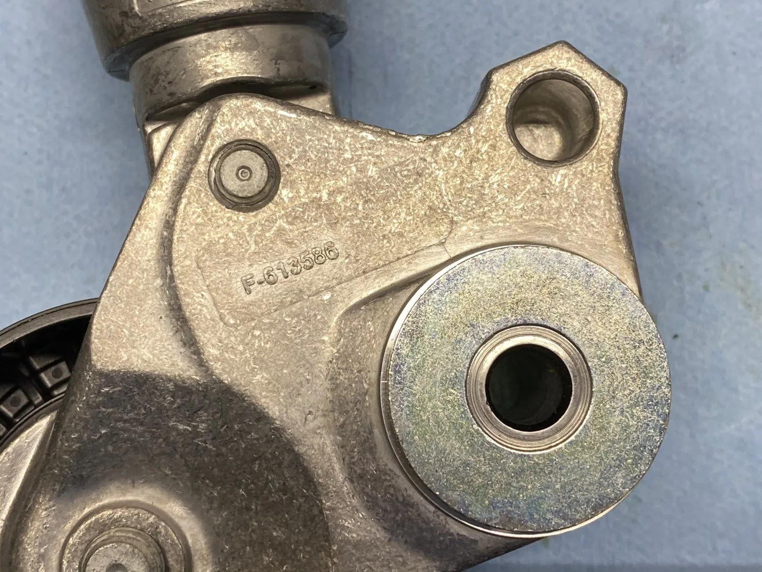

I noticed that the pre-installed (and I assume pre-torqued) Torx bolt through the bottom of the damper, has plastic inserts, and the damper itself moves loosely around that bolt. Is that how it's supposed to be? The damper top bolt hole had a metal sleeve and the same plastic inserts, and that sleeve also feels like it can move loosely. Normal?

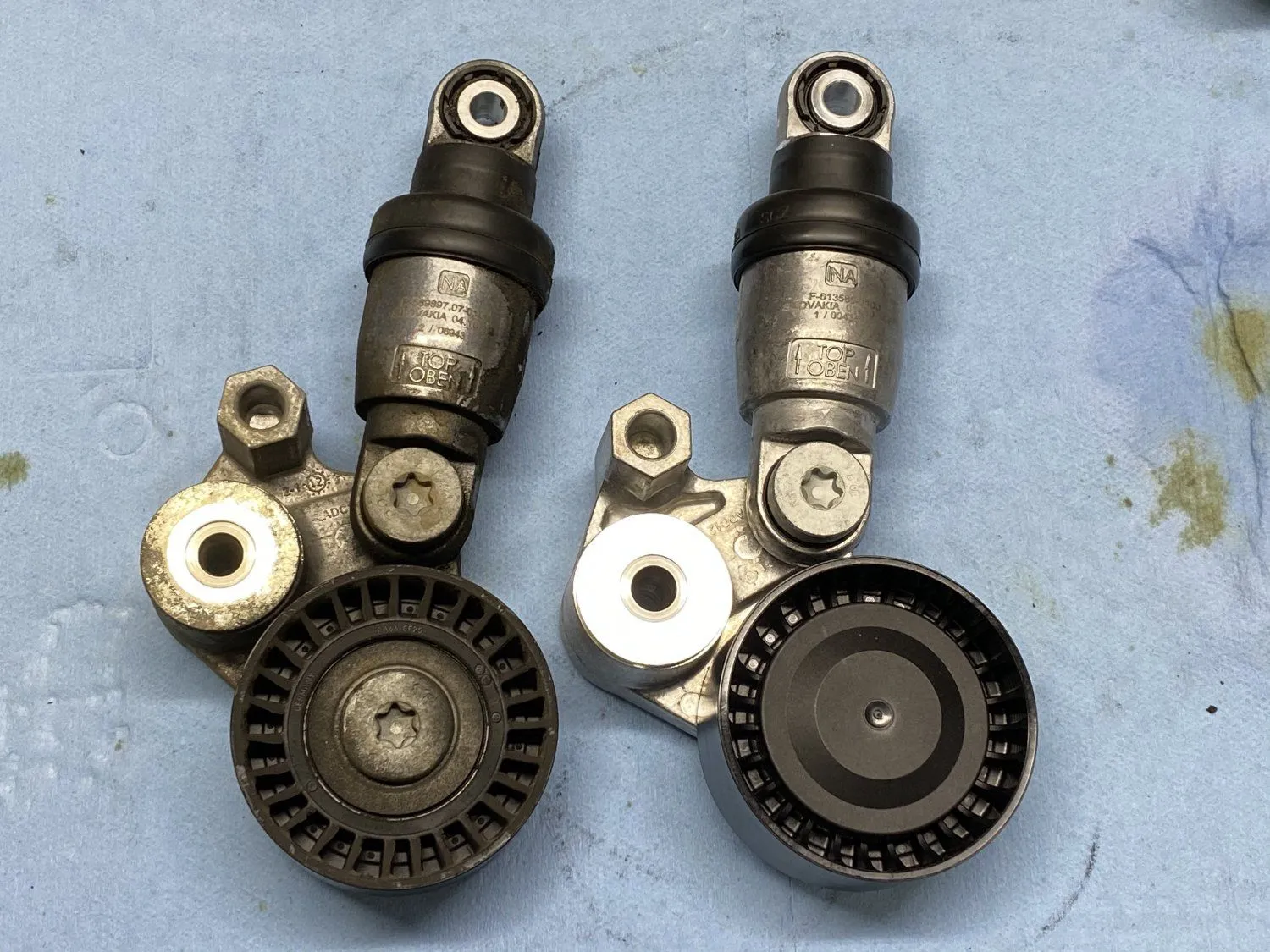

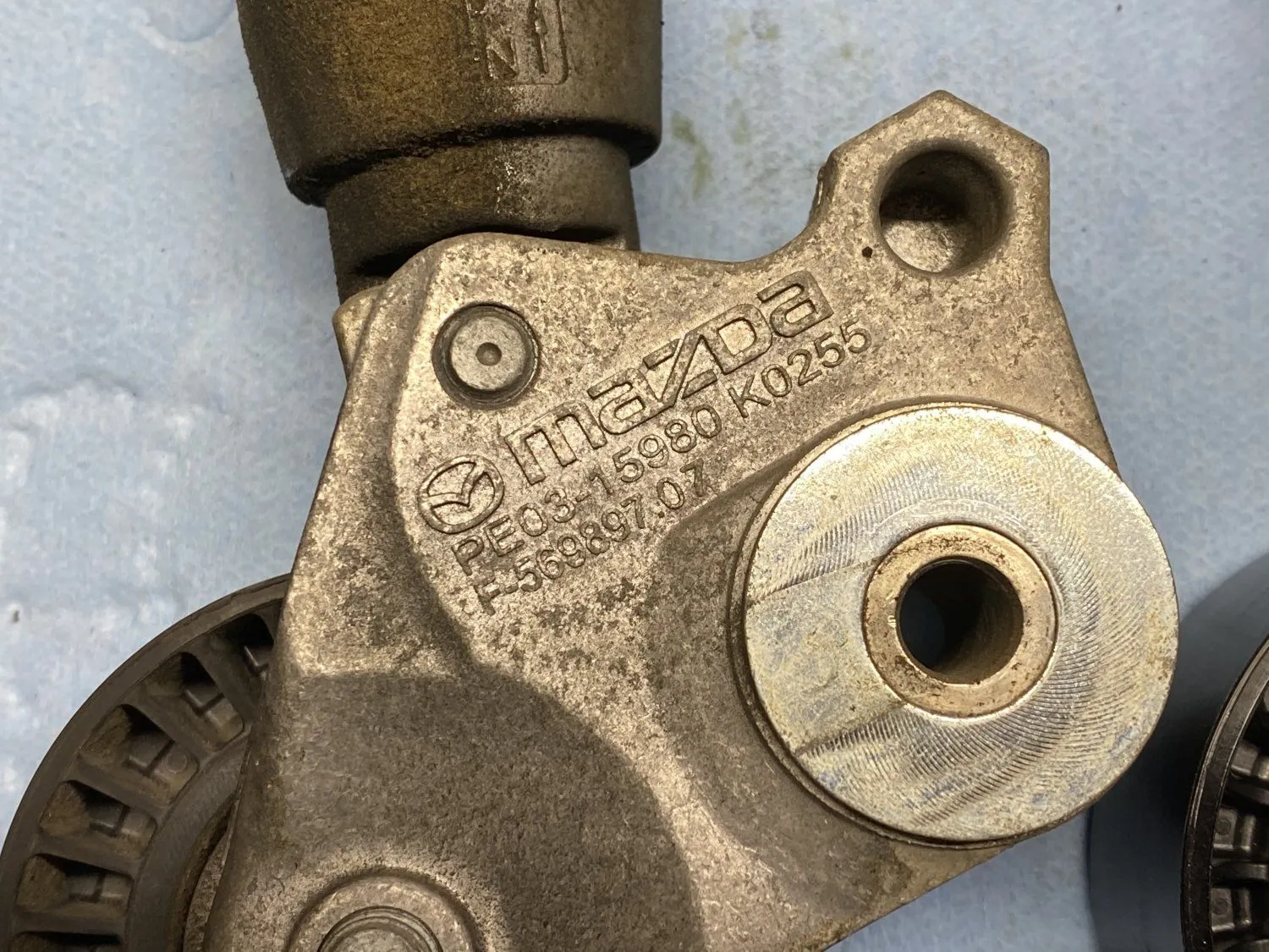

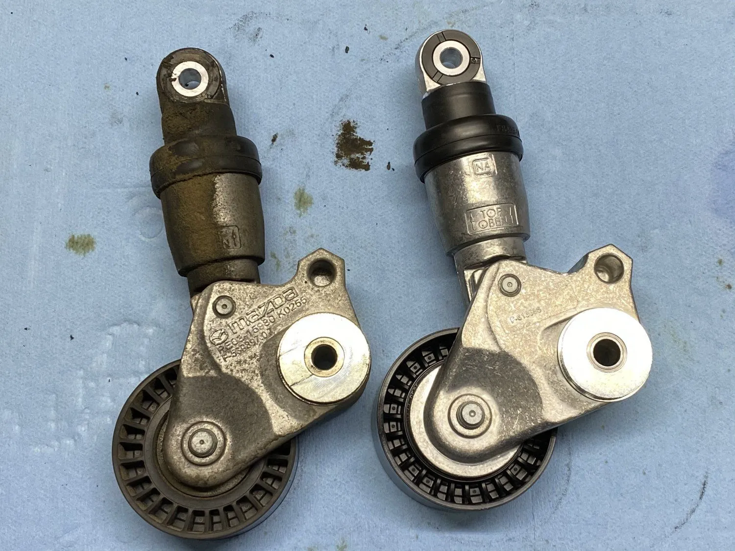

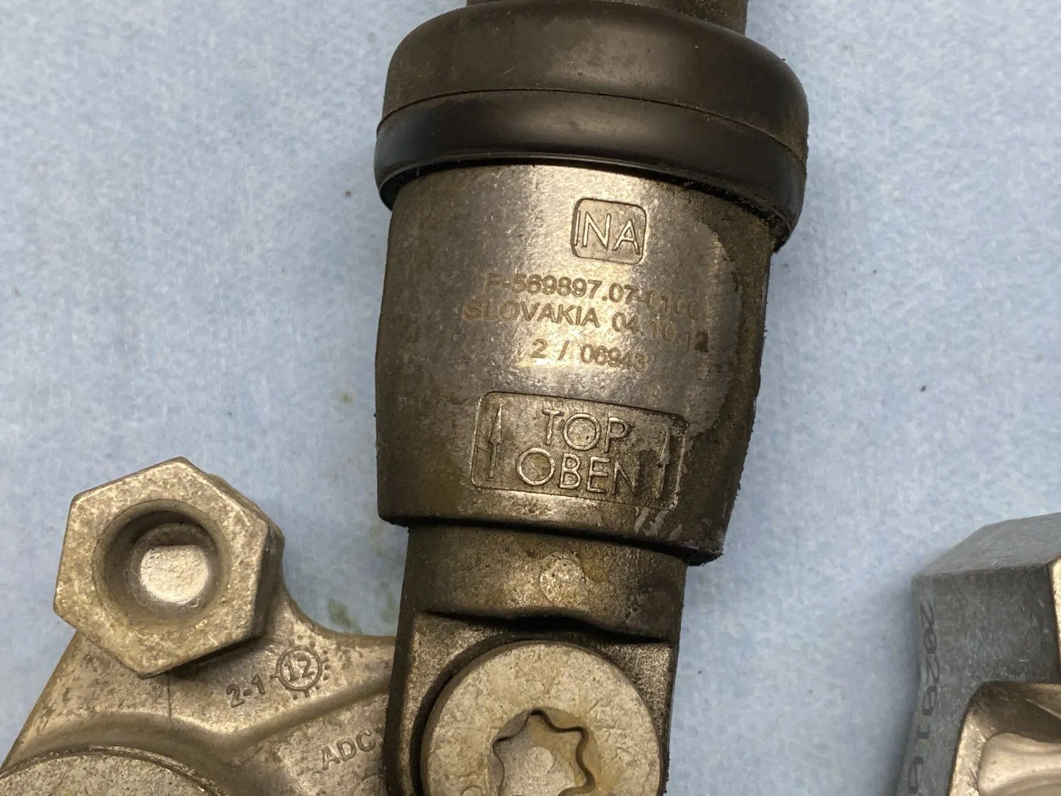

followup: here’s my original Mazda tensioner and the INA one. Both have the same amount of free play in that joint with the Torx bolt. Looks and feels exactly the same to me.
Date on the original one appears to be 04.10.12 which most likely means 4 October 2012, which would make sense, as the car was manufactured January 2013 according to the door jamb sticker.

So your INA replacement tensioner has s/n F-613586-0100 on the damper, what is the s/n on your factory tensioner? Is it F-569897.10 or F-569897.07?
How many wheel well liners did you take out to complete your job?
Edit: saw the s/n on your factory tensioner: it’s 569897.07.

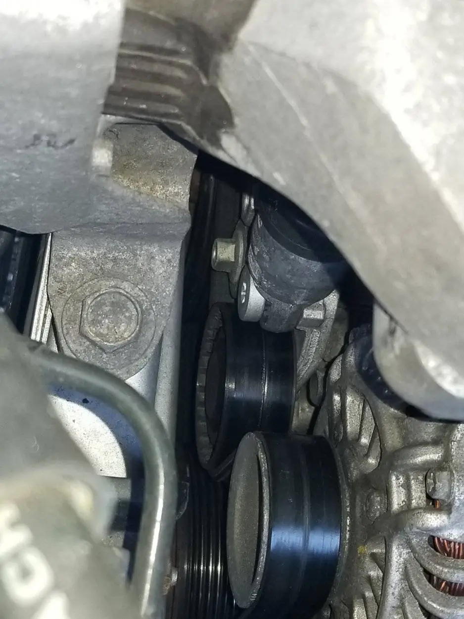

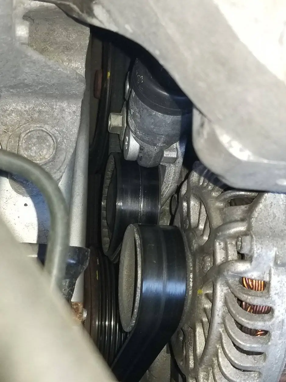

Decided to randomly check on the serpentine belt and tensioner. Not looking good, there's actually a nice slice right in the middle.

Can you tell what is the cause? From idler wheel on your INA tensioner?

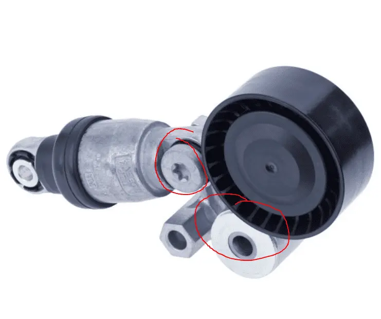

To me it looks like maybe a casting on the body of the tensioner is touching the roller.
It's highly possible that something along these red lines are causing the damage but I'm going to assume it's as manufacturer defect since I didn't notice this with the old tensioner.
So may be you can get another new INA belt tensioner under warranty?
I'll try... Probably be losing about $10 - 12 to get it shipped and then a few months to get it back. Not sure if it's worth it but I'll let you guys know if I decide to do the warranty.
Whatever made that gouge in the roller should have made a fairly noticeable scraping sound, at least until it scraped away enough of it to not be touching anymore.
