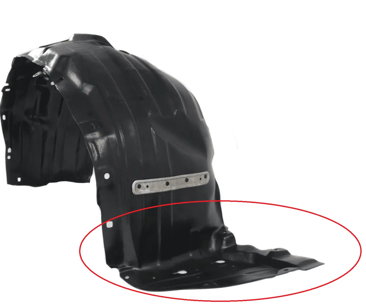

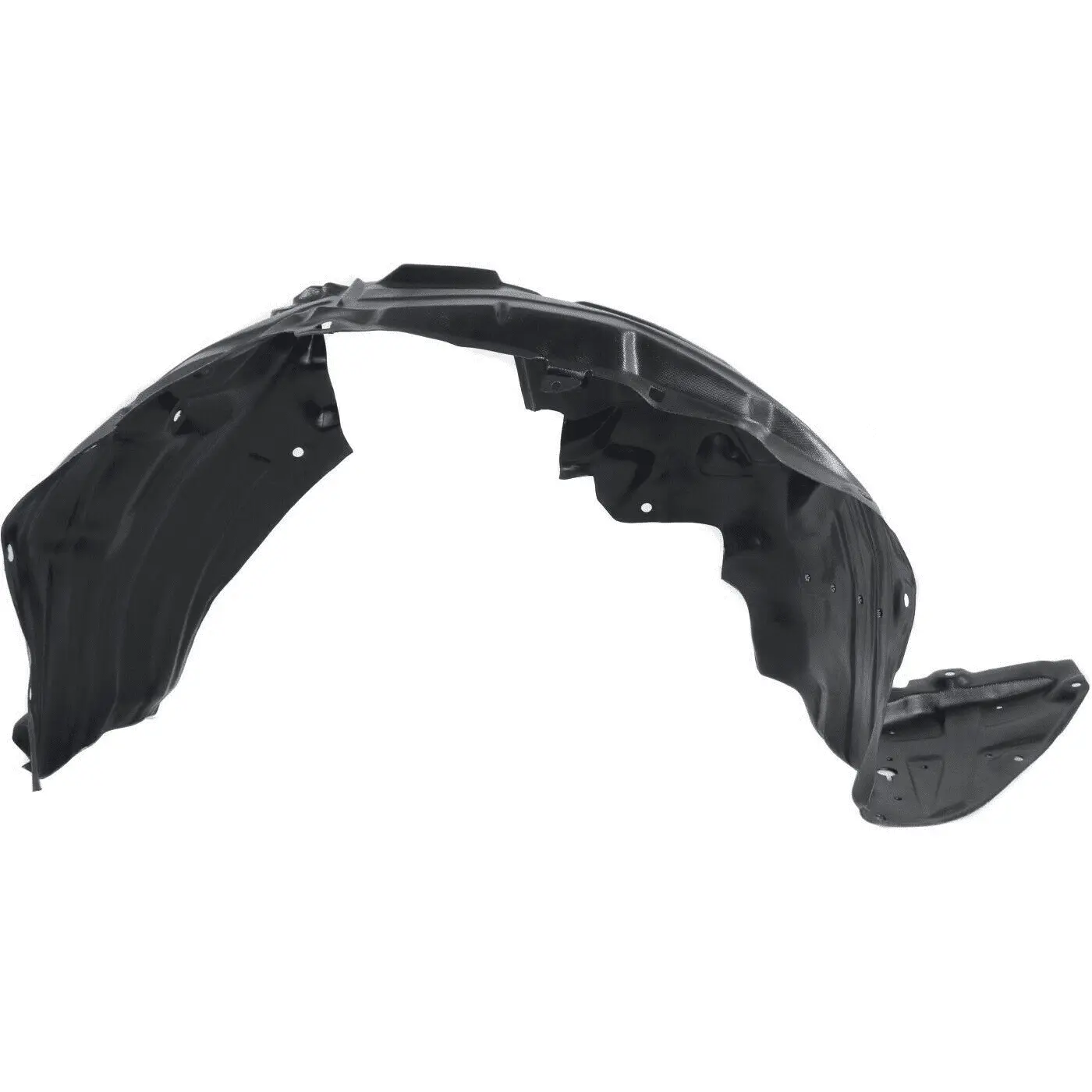

Let me know if you have any other questions but here are the things that you need to remove and the steps:
  1. Fender
  2. Inner Splash Shield
  3. Wheel Well Splash Shield

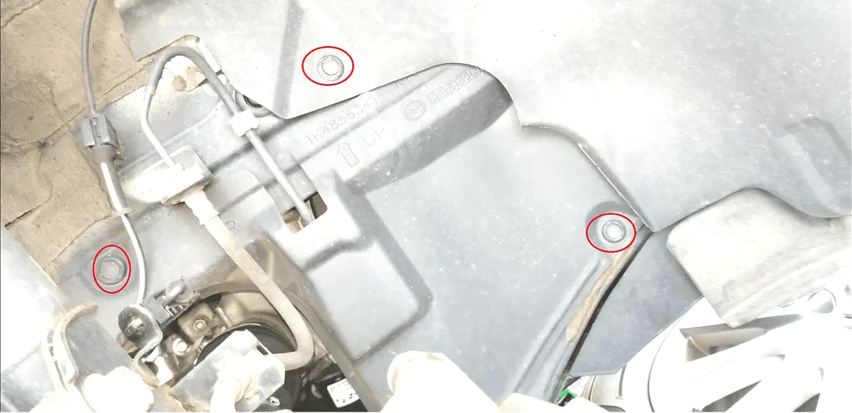

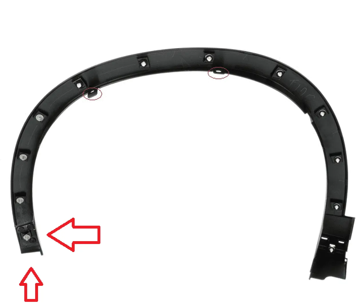

1. Fender: This part is pretty easy to take off. All you need to do is pry off these rivets (see red) securing this fender using a tool. Afterwards, you choose a corner and start prying it towards you using your hands and they will come off, no tool required. The corner with the red arrows was the easiest for me to start.

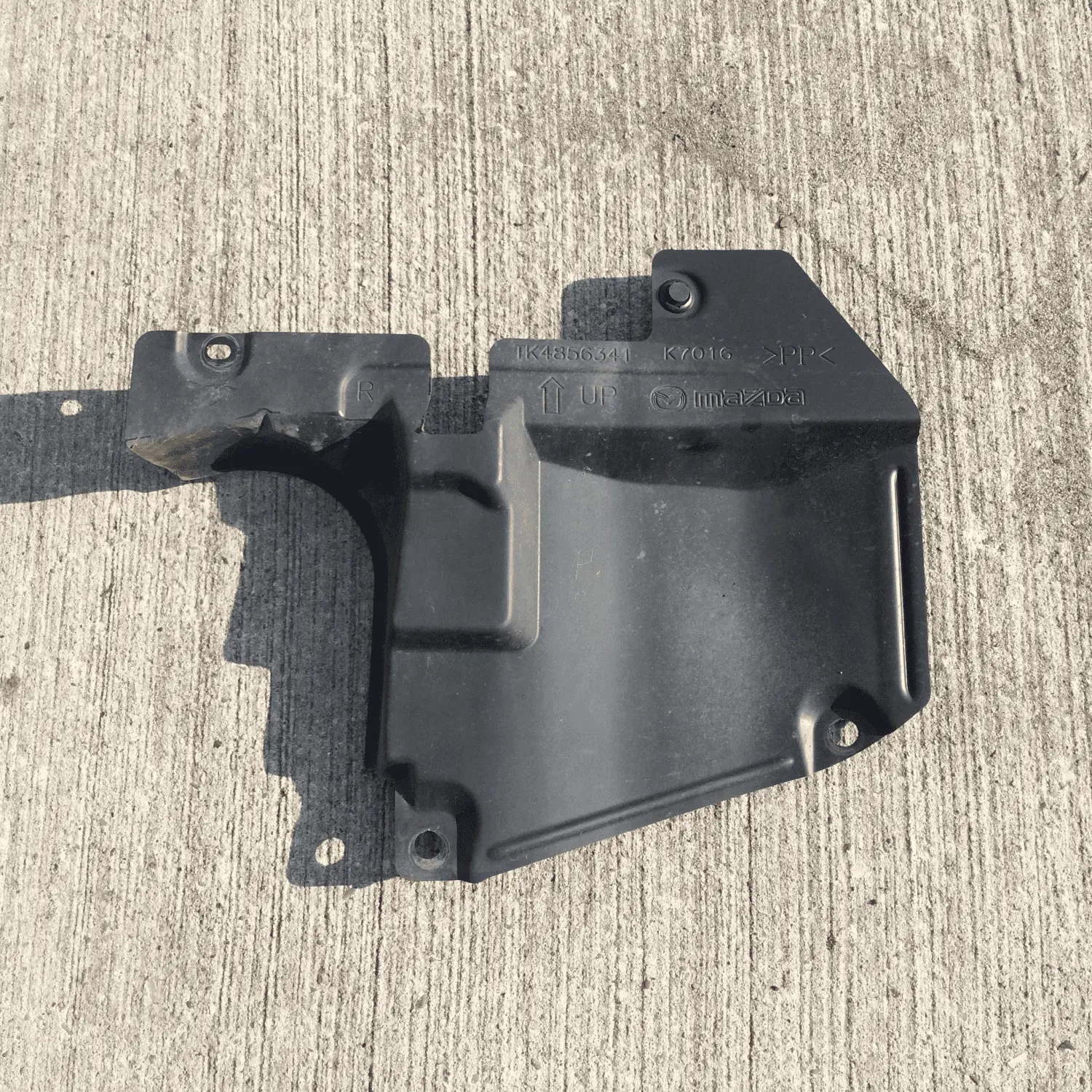

2. Inner Splash Shield: For this one you just need to pop off (4) rivets and it comes off.
3. Wheel Well Splash Shield: This whole thing is pretty much held on by rivets and two bolts. I think it was 8 mm. You should start off with the portion that I highlighted in red first because that portion is blocked by the underbody covers that are held on by (1 - 2) rivets + a few 10 mm bolts. Once you have that part highlighted in red removed, just work on the bigger portion and the whole thing comes off.

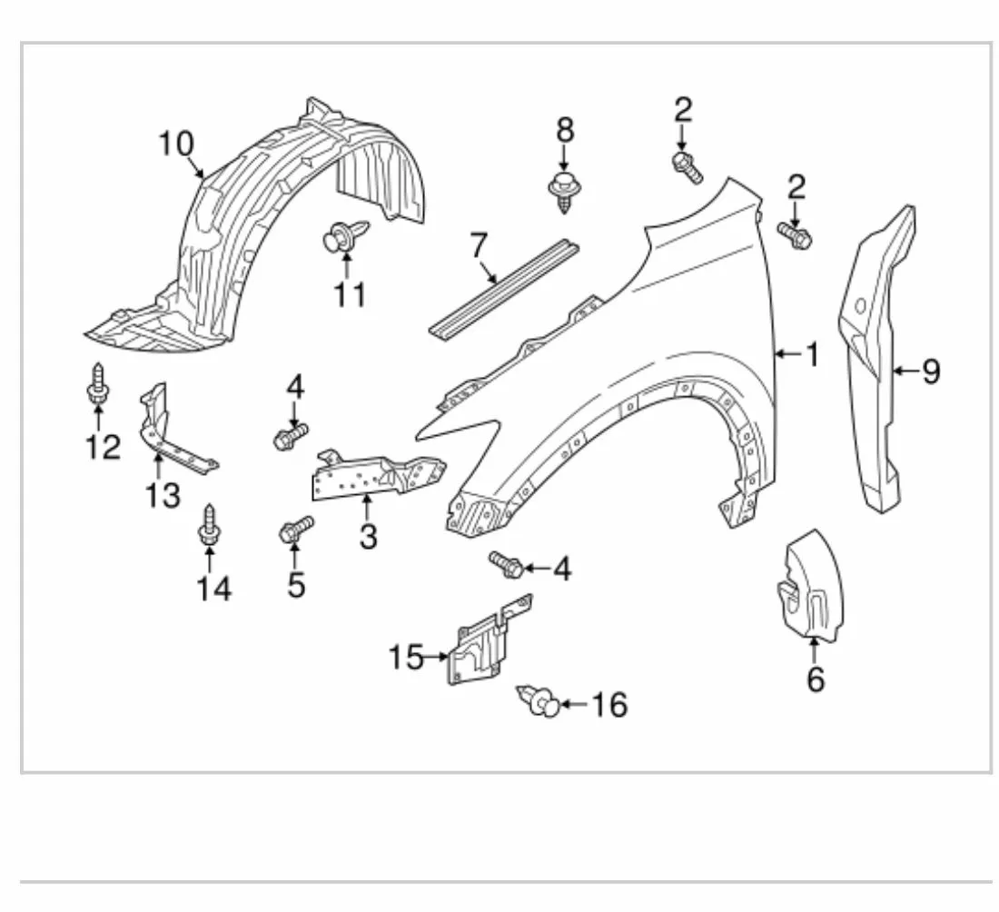

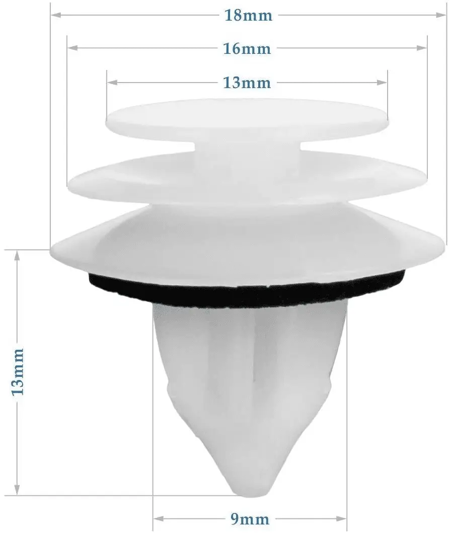

Mazda uses several different kind of plastic clips and rivets. In fender liner area they have:
#8: Body C-Pillar Trim Panel Clip - Mazda (p/n: GJ21-68-885B-02)
#11: Splash Shield Rivet - Mazda (p/n: L33X-13-209)
#16: ?
p/n L33X-13-209 rivet is used the most on CX-5 and the one Digbicks1234 got should be compatible to this OEM rivet.
  1. Fender
One added benefit by taking the entire fender liner out is we can clean up all the leaves and debris accumulated inside of the liner falling from the cowl area.
#16: ?
When I took out all of the rivets for the (3) splash shield items, all of the rivets looked the exact same to me aside from the Fender rivets which did not break at all. I don't think the other rivets in that diagram are applicable. I wish I took a picture of my tray but I forgot to. You guys will just need to take my word for it I guess :D
Yes, you're right about that. I had so much crap stuck on that corner where I highlighted with the red circle. Lots of leaves, dust, debris and sand in there. Only problem is that every time you take apart the fender, you risk breaking a rivet.
Also, I have the fender rivets on hand as well. I don't know if they're compatible or not, but they look similar with the foam insert in the center and these could probably be used interchangeably if you broke some door rivets.

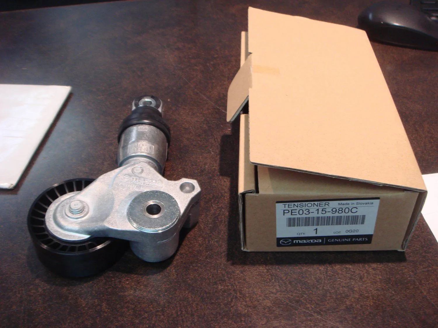

So after spending a few days with the new belt tensioner in my car, I noticed a few things about the new tensioner:
  1. Definitely a lot more noisy during idling, especially in park. I feel there are definitely more vibrations noticeable that wasn't there prior to the belt tensioner replacement.
  2. Acceleration doesn't seem as quick/peppy anymore. Feel like it's a bit slower than before when I mash my foot onto the pedal.
Not sure if anyone else who has a GATES tensioner can comment as well but so far this is my experience. I'm thinking if I should get a OEM one to compare the difference but then I would have an extra tensioner for no reason.

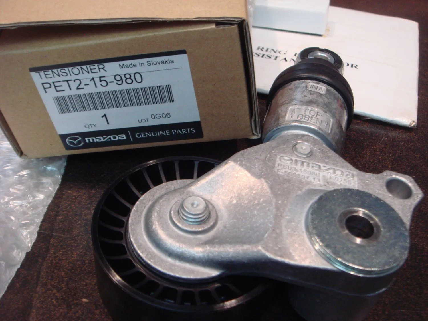

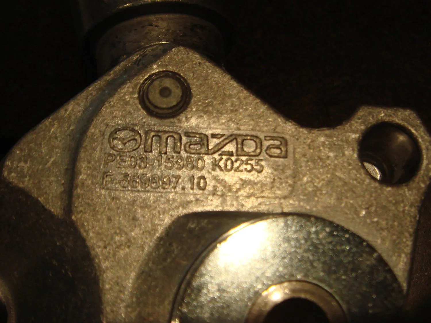

Digbicks1234, you have compared a used OEM belt tensioner and a new Gate tensioner, and which one is better is obvious other than the used OEM one has leaked. ;)
Yeah, I do agree OEM is usually better but the fact that Mazda can't seem to get their stuff together and doing a swap of the belt tensioner model # every other month doesn't instill confidence that they can be trusted. That's the really annoying part otherwise I would've went with the OEM one without any hesitation. Tough choice....
I agree. That’s why I have wait-and-see attitude and postpone the leaky belt tensioner replacement at this time.
I actually stopped by my Mazda dealer checking out the OEM belt tensioner while I was gettin a new OEM battery. The parts guy whom I know well showed me the current part number for belt tensioner from Mazda parts screen and surprisingly it’s PE03-15-980C with the MSRP still at $147.86. Based on the system PET2-15-980 has been superseded by PE03-15-980C months ago, and PE03-15-980C tensioner is the one they’re getting currently from Mazda. He brought both tensioners out and the serial number on older PET2-15-980 tensioner is F-569897.13 which indicates it’s a revised version. But the serial number on newer PE03-15-980C tensioner is F-569897.10, which is unrevised version based on the TSB! They looked exactly the same as far as I can tell, and I didn’t see different shapes on tensioner damper like the TSB stated. What a mess!
You think its the placebo affect since you recently installed the parts and are listening "extremely" close to any variances?
I have the Gates waterpump stretch belt, Gates serpentine, and Gates water pump in my Mazda6. I cannot tell the difference.
Did you remember to bleed the tensioner...not sure if that would make a difference though.
To be honest, I would've expected there to be no noise if any at all if it was the placebo. However, it seems like I can hear the tensioner wheel rolling every now and then and some more rattles/vibrations occurring near the passenger cabin area which I haven't heard before prior to installing this new tensioner.
What year is your Mazda6? Just wondering if they use the same sound proofing material and whatnot or maybe I'm just more sensitive/susceptible to these small nuances? No idea.
I did bleed it by going very slowly compressing it, then very slowly letting it decompress so I don't think that should be the issue.
I'm thinking though, could there possibly be a break in period for either the (1) belt(s) or (2) the tensioner itself?
